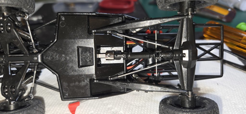

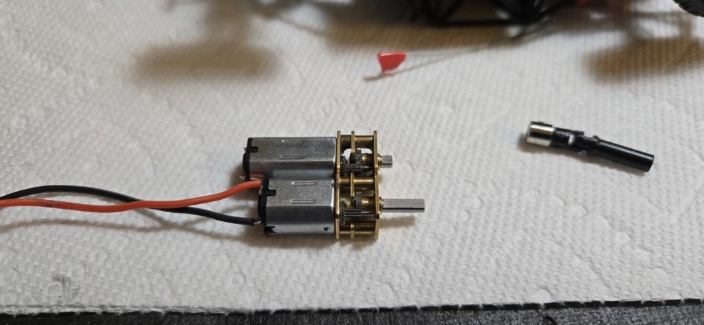

    New 3000rpm 12v Short can, long shaft from Amazon.
    Pretty sure the Trophy Truck is the only one that can take a longer shaft, it has no transmission case to fit. Still has plenty of driveshaft space.
    Good news, it worked, runs quiet. Bad news, I need the 6v version as it runs at half speed. I wanted it slower, but not that slow.
    Good news, I also ordered a 6v 2000rpm, so that should be the one that covers the bases.
    The gear heads are interchangeable, it was the main gear on the motor that lost a tooth.
    also, being a shorter, lighter can, the front end came up a bit.
    Side note, the blingy driveshafts for the bouncer were 3mm too short, sent them back and the search may end there. There is another set that would fit, but honestly I think the stock plastic shafts are better quality.

    I didn't realize they were direct drive like that.

    that is the only one. The 4x4's have a 1:1 transfer case that the motor sits in and needs the shorter shaft. The military trucks have a divorced case, so not sure about them.
    Technically the gearbox on the motor IS the transmission...:notsure:

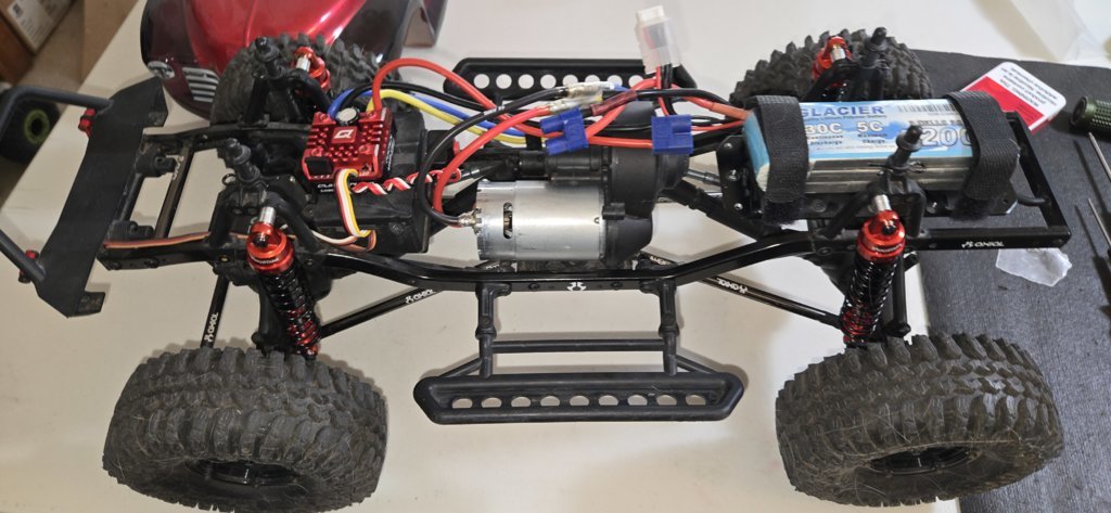

    Installed this generic 550 can from a plane in the vintage SCX10 with a 17t pinion.
    Best motor ever! Super low end torque and a fast jog to keep up with it when on the run.

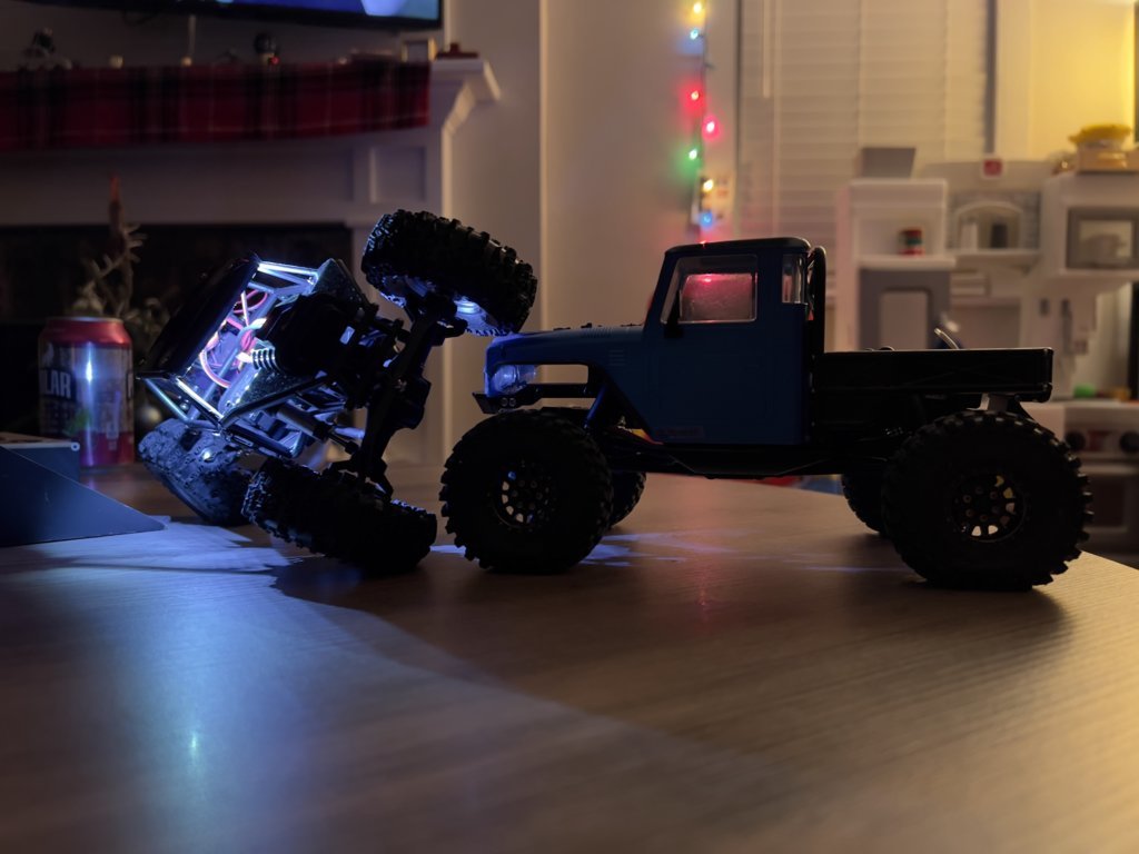

    Spent my first sober NYE in probably 17 years playing with the RCs, this is the Tarantula TRX4M and IR40-ified Ascent 18 that I pulled the rear cage off of
    Happy 2025 fellow RCers!

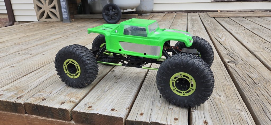

    I also have a vintage AX10 Scorpion. I'm about to give it a rear steer upgrade.
    I usually run it sans body and recently printed a battery cover to protect it.
    Still rocking the Rooster Crawler edition ESC and a vintage Thunder Power 2S lipo with a max 15C discharge from over a decade ago. So old it doesn't have balance wires.
    It's a flex monster.
