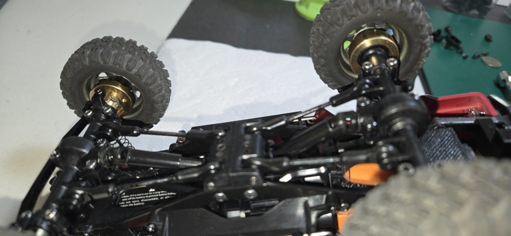

    That body looks sexy as hell :drool:

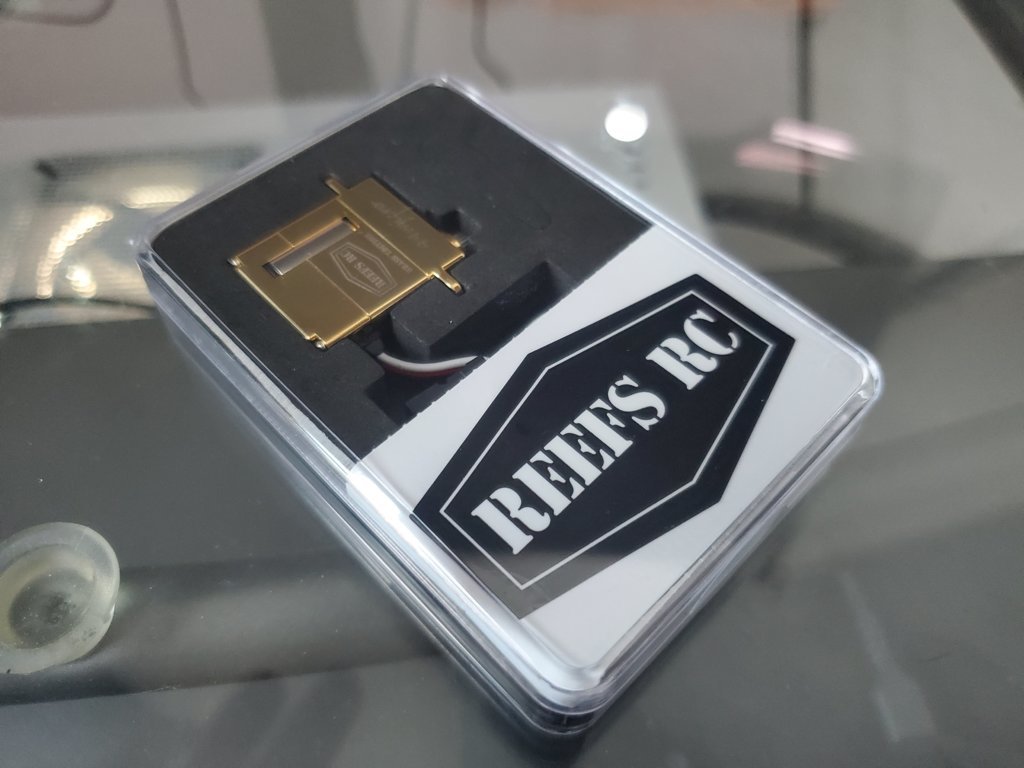

    The local hobby store was still pretty wiped out but at least they're expecting a ton of shipments this week.
    I couldn't walk out empty handed since I do need parts for my new build so I bought what is supposed to be a decent servo?
    They did have Ecopower and several others I have heard about but I did say I want a good one so we'll see.
    (Or did I mess up because it's brass?)

    Heard good things about reefs servos. Wish we still had a local hobby shop. I have to order everything or fly to another island

    I just hope it isn't too heavy up front because of it (if that's a thing).

    At least it'll be unsprung front biased weight....right?

    Yeah, the servo will be mounted on the axle and now that I recall I do remember seeing brass servo's on comp rigs as well

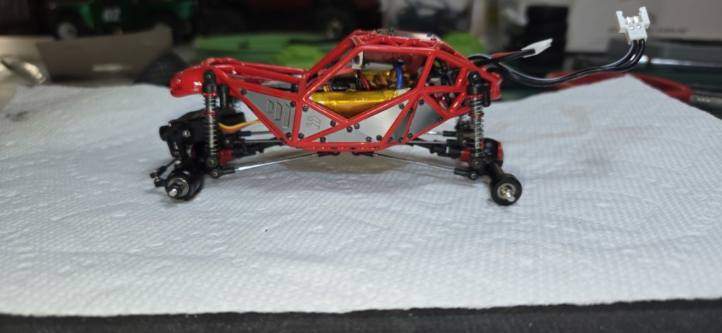

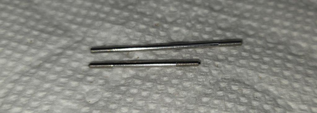

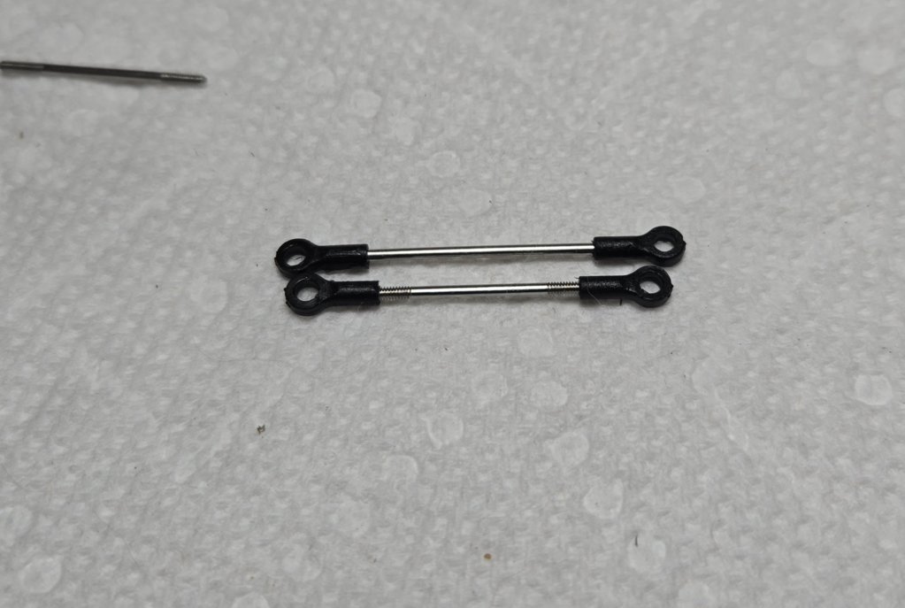

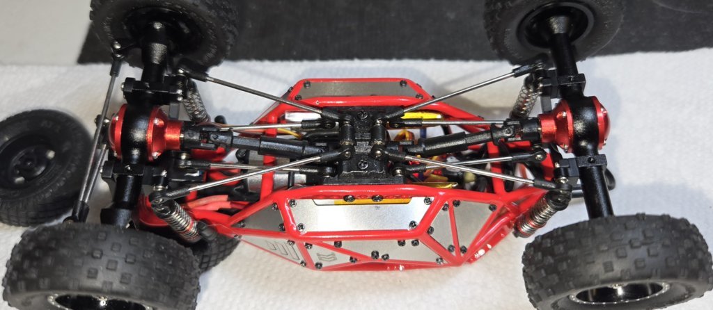

    New upper links for the bouncer. Seems significantly longer. These were offered for the F150 for the install of the same aluminum axle for the same reasons I have to.
    They are 4mm longer than what I needed to make it stock, I figured lengthening the wheelbase wouldn't hurt anything and it would align the shocks again, which were angled out at the top.
    New extended link with the old one.
    The rear is done, you can see the better shock angle compared to the front.
    Front ended up vertical, after adjusting the lower link to level the pinion, it got even better.
    Little more slip showing now, still half inserted.
    Went from 90mm wheelbase to 96mm :cool:, easier flex, same amount of travel. When the 36's show up, it should balance out the look.

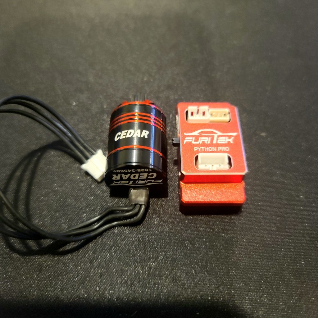

    Im sold :spending:just picked up a furitek cedar and python pro esc for the Ascent lol

    Oooh what made you go Cedar over their other models?
    I learned about that one last night but looks rather long
  16. Jan 3, 2025 at 9:12 AM
    Strictlytoyz
    Strictlytoyz Well-Known Member
    Jul 23, 2015
    #160147
    2,826
    Charles
    HA\/\/AII
    07 Shitbox
    With all the videos and reviews I watched I was stuck between a Cedar and a mini Komodo and really didn't see that big of a difference between the two. I would've went Komodo with a cheaper price tag and smaller footprint but was unavailable at the time. Size wise it's smaller than the factory ascent motor as well as the brushed injora I currently have in the truck. Just got it on the truck yesterday and excited to take it through its paces. Just waiting for my tx/rx to arrive on Sunday.

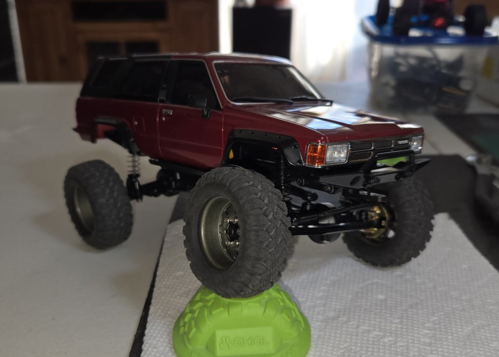

    After a bit more time with the FCX18, I can't recommend it as much unless you can score it for $100 or less.
    I did post here about how "clunky" the drivetrain felt and after more digging, the consensus is that the portals and transmission are both to blame. Now, mind you I felt this since day 1 so I'm pretty sure nothing has broken or stripped but I decided to put it up and run it both in low and high and it's crazy how bad it is (in the rear at least).
    https://youtu.be/80-KIFBXq_A?si=2Qv3sdlVeSXkVvPs
    It's a fun rig for sure, and I could've saved a few bucks by not bothering with new links or the body magnet mount. Although it was in dire need of shocks and tires, and if I really want to enjoy it some more, ideally a new transmission (or motor/transmission combo).
    Aftermarket options are pretty cheap fortunately, but this was meant to be a cheap rig where I didn't want to put much into it.
