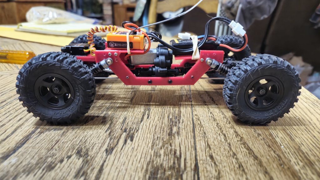

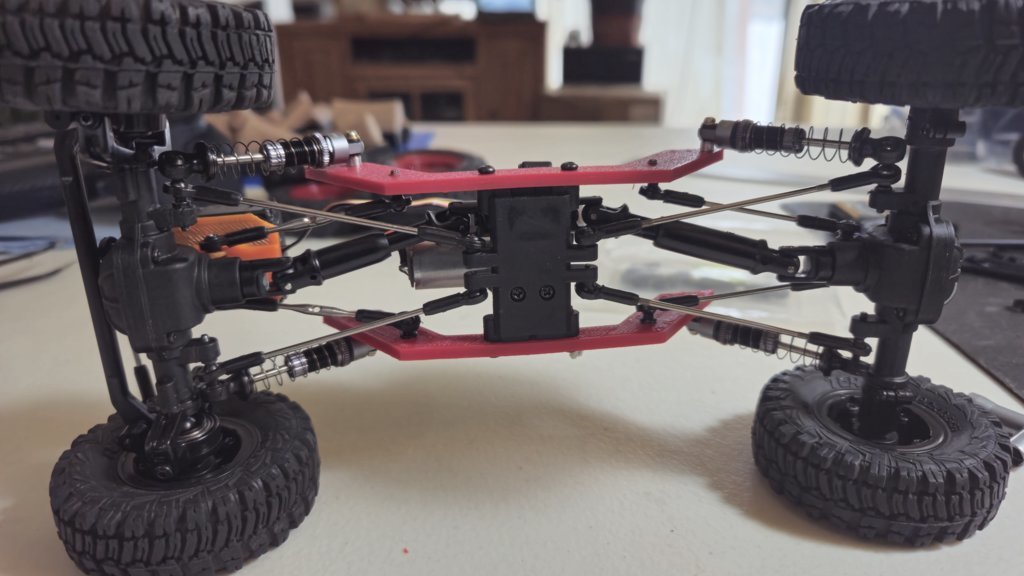

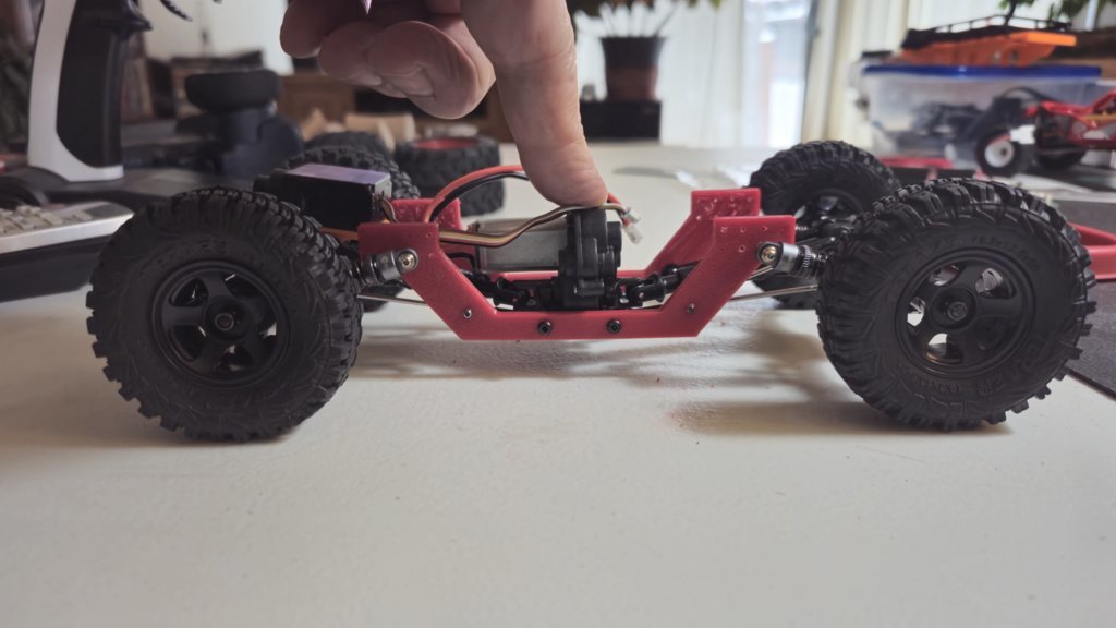

    Side frame 2.0
    All metal links, shortened the rear, it's now 5mm longer than the front.
    side frame 3.0. This one I like, it uses full stroke on the shocks and has smooth suspension movement.
    Gotta print up some mounts for the ESC and the battery.
    Will prolly swap out the mini servo for a micro and change the ESC to one of the FMS boards I have so many of. The one it came with has poor modulation.

    It wishes it was. This is an Easy RC POS24.
    Plastic throughout, shit ESC and TX. Top heavy, twitchy, bound up suspension. It was a disappointment. Body is pretty sweet though.
    https://www.amainhobbies.com/eazy-r...yvysKRTp8T5sH2RzN3xJ8ugwC1l6DT0IaAmv-EALw_wcB
    With the FMS ESC and a better servo it actually behaves pretty well (body off) and is sufficiently low geared for crawling.

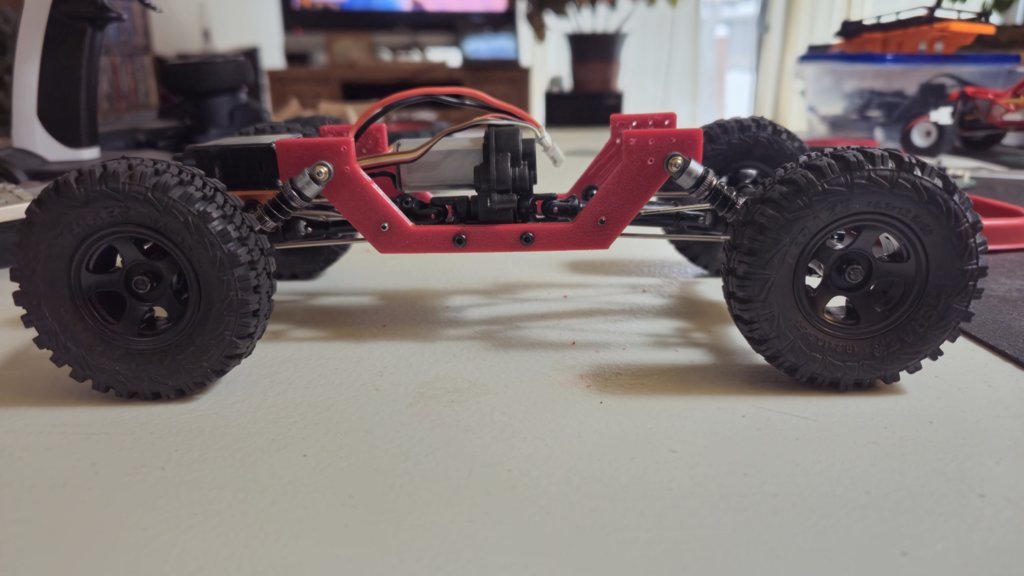

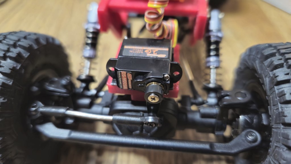

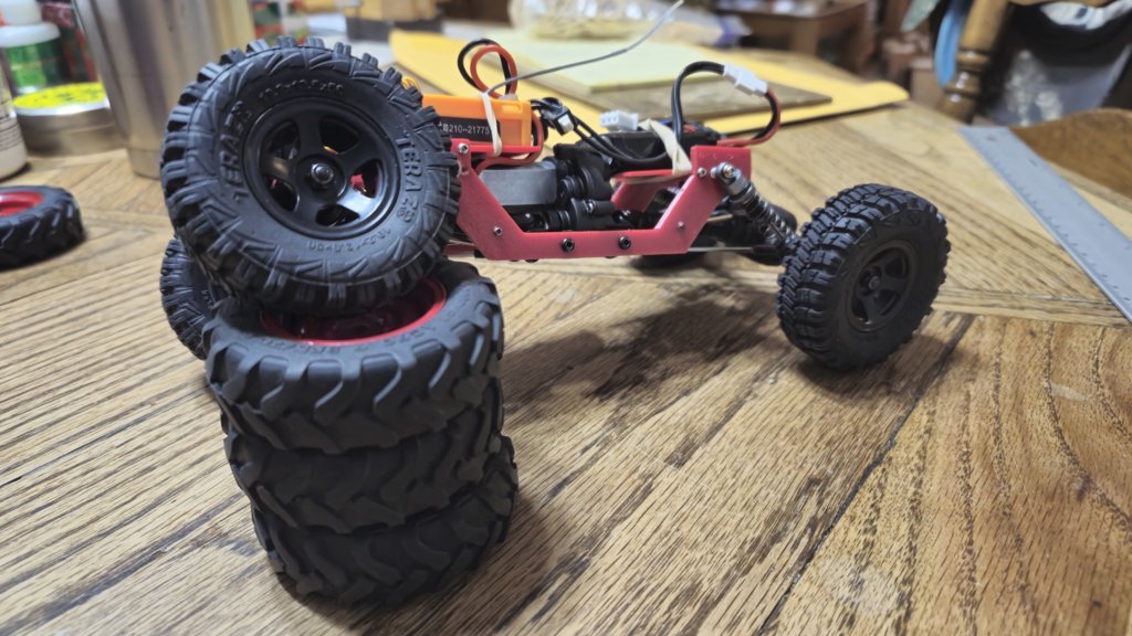

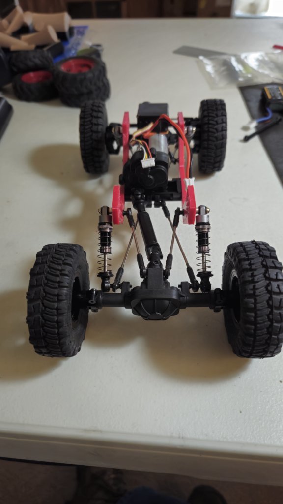

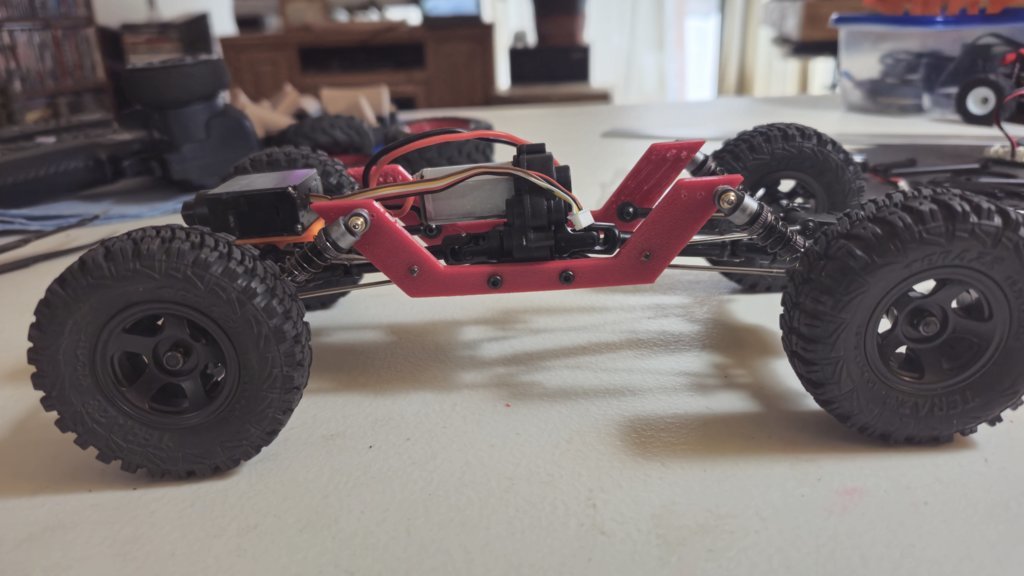

    Little 2g servo does just fine turning them big wheels. It's quiet too.
    The budget comp crawler.
    Adjusted the rear links to mirror the front. Cobbled up the electronics. Modulation improved by 150%.
    It's amazing how much change there is in the different upper shock mounts. I tried them all, varying results. This one gave the highest degree of articulation and the smoothest action.
    At a drawback though. Shocks at an angle get hit by the tires, one decided to unthread.
    Adjust the steering throw and you lose a ton of turn radius.
    Breakover angle sucks too. I'd like to make it shorter, keep the height, tighten the turn radius.
    If I can trim 5mm out of both ends, I'll still be longer than the front originally was by 3mm.
    Another thought is to pull in the ends of the frame, and bring the shocks inboard a bit, increasing turn radius. And just wind up the shock collars a bit.
    Or do all of that. :rofl:It's cold out, I have nothing better to do.
