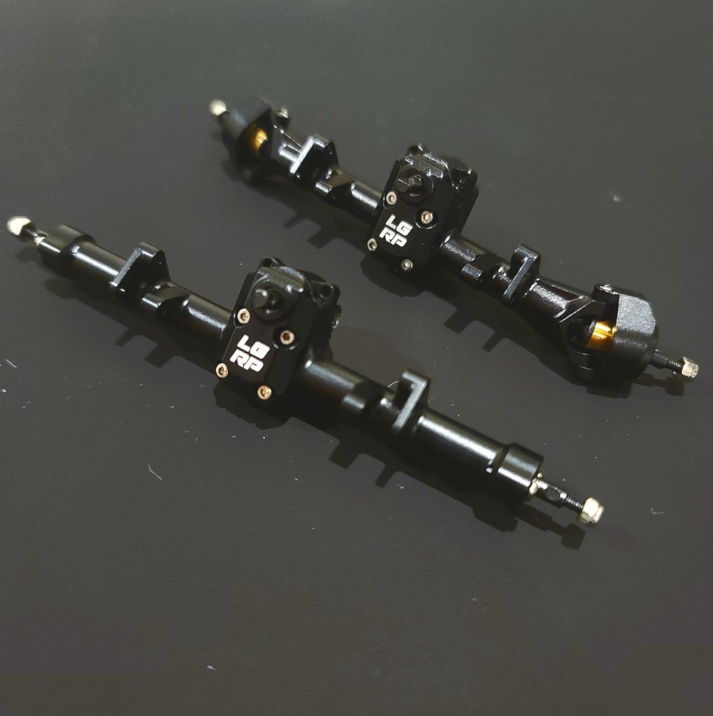

    I did go with Meus axles so that would indeed benefit me.

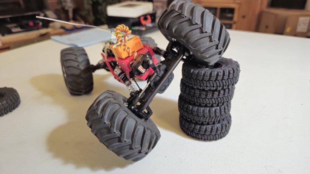

    Redid the frame, curves in the corners for easier sliding. Shortened the links by 5mm all the way around. It did not negatively affect the articulation one bit, it's actually better.
    Improved the breakover angle.
    Tires really make a difference. Not sure if I want them this fat, but these really woke it up.
    Was only getting 3 tires before.
    I think a VW Bug in 1/24 would look good on it.

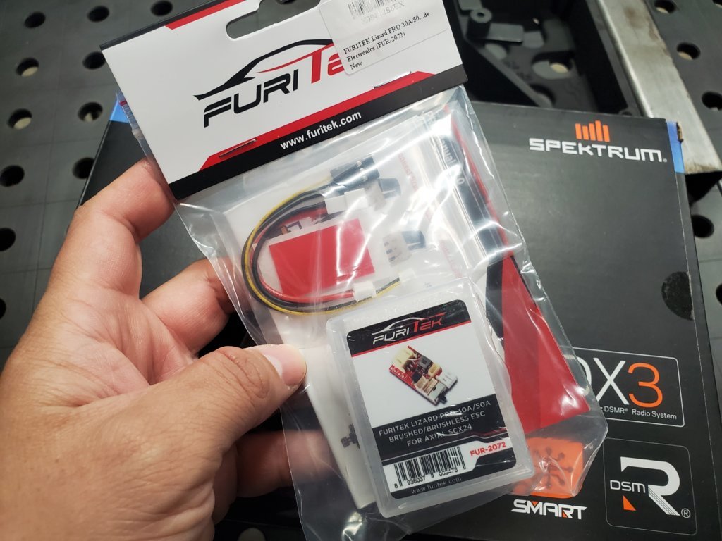

    ESC arrived!
    Axles and chassis should be about another week.
    Tires arrive in a few days.
    Then it'll just be wheel, shocks, and links whenever I get the invoice for those.

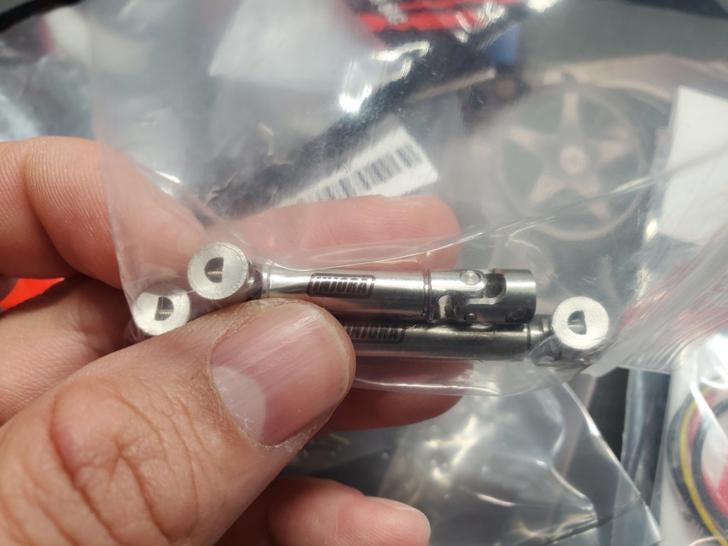

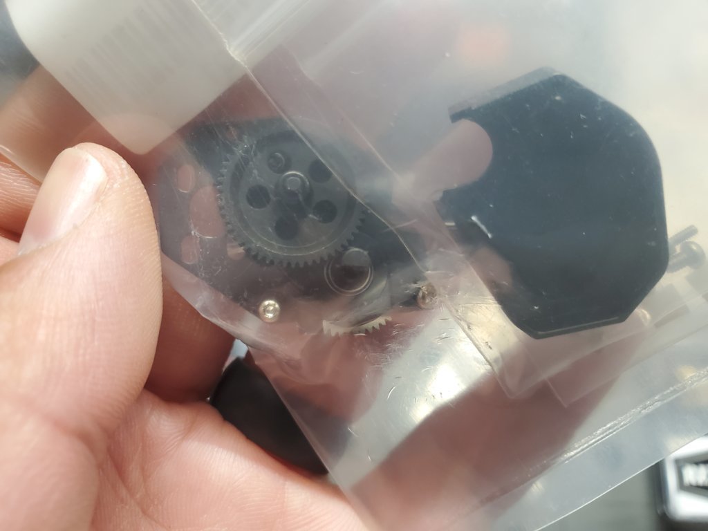

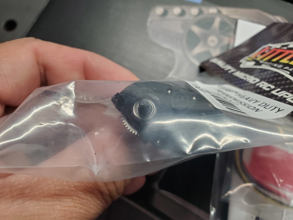

    As for the transmission shaft and driveshaft here you go -
    Shit is almost complete!
    Deathbysnusnu and Strictlytoyz like this.

    Siiiick! Can't wait to get these things together and take it on its maiden run for testing. First piece of my build has arrived. I may infact get the diff skids seeing as how square these housings are
    They are indeed "D" shaped

    Oooh shoot that's right, the shaft coming out of the diffs.
    I'm sure mine are correct. We'll see once they arrive.

    Ended up canceling my order and getting the "D" hole injora driveshafts in gladiator length. Just wish they came in black. Seems every company that has a black driveshat has an "O" hole. I don't want any unnecessary slop in my driveline. A lot of my stuff will be arriving next week.

    The only difference in the D and the O shafts is the pain in the ass to match them up imo.
    I've had both designs be sloppy and or tight. The D is supposed to take more torque, but I've personally stripped those. It really comes down to the screw through the shaft.
    Also, you can take D female ends and drill them out to fit O shafts.

    I believe you can use the "O" hole shafts on "D" shaped axle and trans but I'd rather not rely on just the screw to keep things in place. Just opened up the axles to make sure there was grease in there. There sure was!

    Ever had a screw break or get bent in the round hole shafts? I keep reading about excessive play/too much load being put on the screw.

    The D shaft will definitely handle higher torque. Yes, i've twisted them right off.
    Excessive play really comes down to tolerances. Sometimes plastic is tighter, albeit maybe weaker in the joint.

    I'm very surprised how smooth the meus axles spin for worm gear drive. My truck actually rolls a bit without drag break.

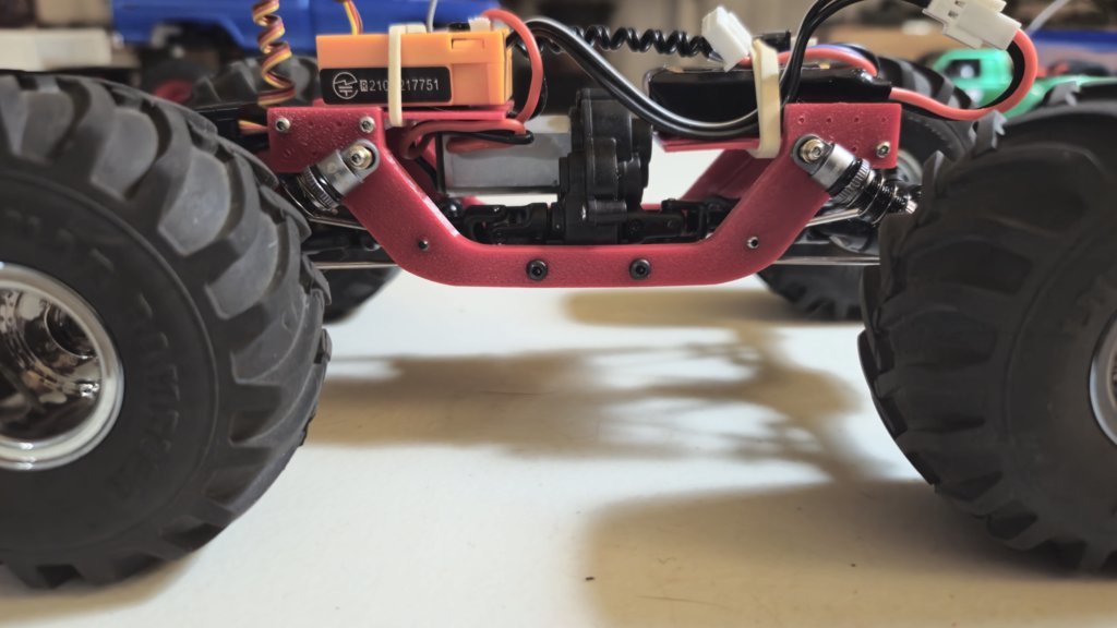

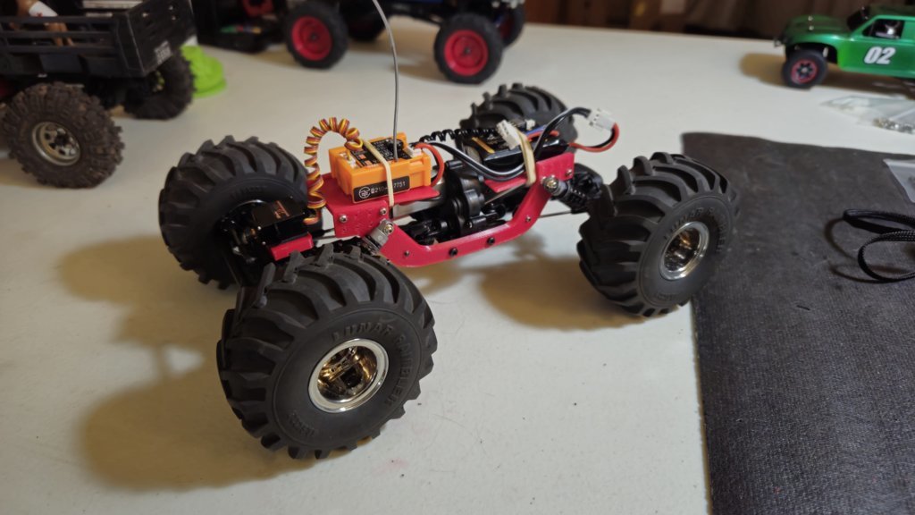

    @Strictlytoyz
    So the links he's building me are C-Bolt; I only learned this term like 2 days ago and it consists of a C-10 front and Deadbolt rear (as far as lengths go).
    It's what he suggests for best performance.
    Here's a pic of the setup using the Cliffhanger body I got.
