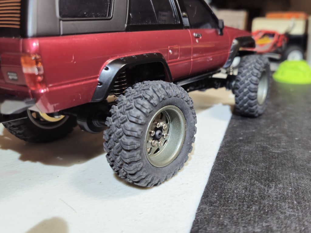

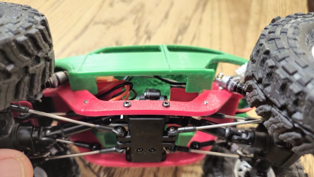

    I see now that I had one side of the scales on the wrong side and will need to redo this and see but either way the weights are correct even if the locations are misinformed.

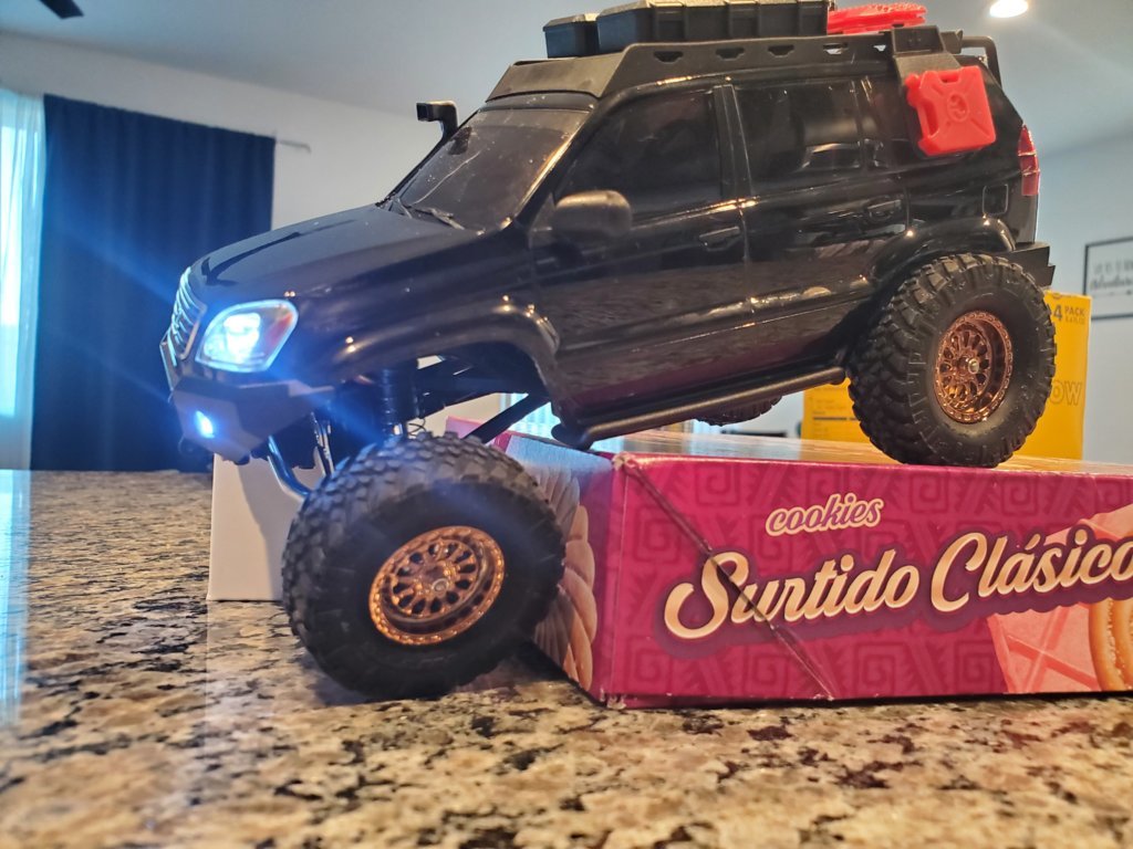

    I must've missed the fine print; I had to go on Injora's website because my GX470 was experiencing weird behavior.
    Going forwards, it drives normal. However, it actually climbs better (and handles even easier) due to the wider track width.
    When going in reverse, the front sort of raised along with the rear. Thought there was some binding but it drove fine?
    I put a piece of tape on each wheel, lifted the rig, and slowly throttled only to see the front spin faster.
    Yep, online it says 23% overdrive up front! It's definitely noticeable when it comes to climbing. So I guess just a heads up for the noobies like me in case your RC displays this behavior with the shocks extending/compressing while driving on a smooth surface.
    Easily a fun crawler for only having upgraded axles.

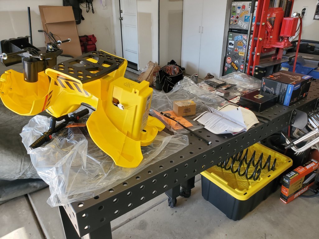

    My welding table is full of shenanigans atm :rofl:
    So definitely not opening anything yet!
    Had just put my kids powerwheels together.

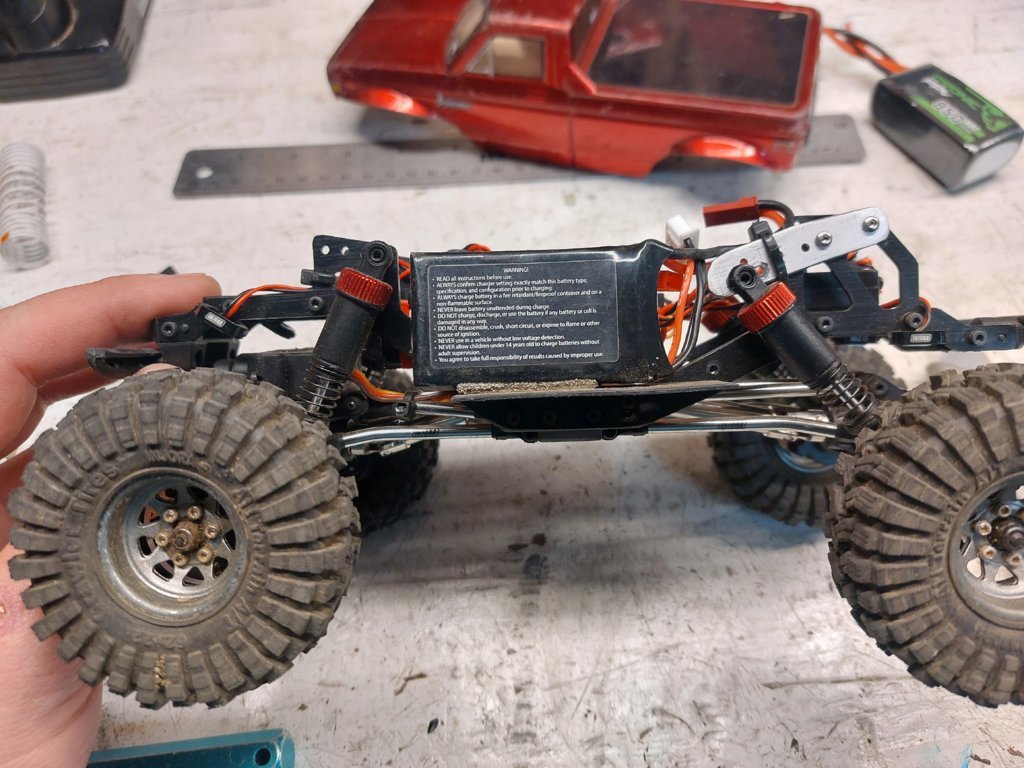

    As promised some pics.
    Injora SS links and driveshafts are almost necessary imo for durability, it's money well spent.
    I have some injora rock lights on there (which is all the extra wires you see). They work awesome plug into the 3rd channel on the stock electronics like a charm. Bright as hell. But not needed though well worth it bang for the buck wise.
    Here's the performance mods:
    • Lower boat sides removed for extra clearance, no point to have them IMO.
    • Battery double sided taped down to driver side boat side. (Weight forward but NOT tall, putting it above the front axle on the chassis like lots do puts weight REALLY high and too far forward which makes for a tippy vehicle).
    • ESC/Receiver double sided taped down to passenger side.
    • 2x 7gr wheel weights forward of ESC/Rx down low and forward to keep left n right balance close.
    • Front shocks filled with 30wt (losi oil) and furthest rearward upper mount.
    • Rear shocks filled with 50wt (losi oil) and 2 lil extensions made out of some aluminum to lay the shock down up top for more flex and also to get the truck to sit a lil lower statically in the rear now that weight has moved forward.
    • Front bumper trimmed so it doesn't rub tires
    • Body trimmed so it doesn't rub on tires
    Like stated stock tires work great, but the injora ones I linked to above def grip better, give a slightly wider but not overly wide stance (~2mm wider per side), look good, and get some weight down a lil lower thanks to steel rims/headlock ring.
    I have put some front brass "extra heavy" portal covers on and have done the under/over drive portal gears but TBH neither of those really did much vs the free stuff above and tires so really not needed. If you do above sans tires and just durability mods of ss links and driveshafts the thing is great and cheap. There is no need IMO to shave the upper corners of the steering servo because it "hits the chassis". It only does so under full straight compression but does not hinder ANY articulation so don't waste your time with that.
    I am half tempted to try 3S for kicks n giggles but it really just works so well on 2s for it's size

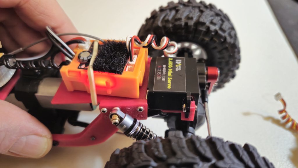

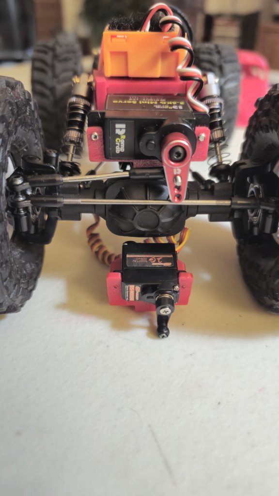

    Swapped out the 2g servo for 13g of torque. But much less speed. The little guy was faster, but struggled to stay consistent.
    This improved a lot of things, steering lock is consistent now, turns wheels in a bind, has a sweet red arm, and it still clears under the hood.
    I assumed I would be trimming or reprinting for clearance, but it fit better than OJ's glove.

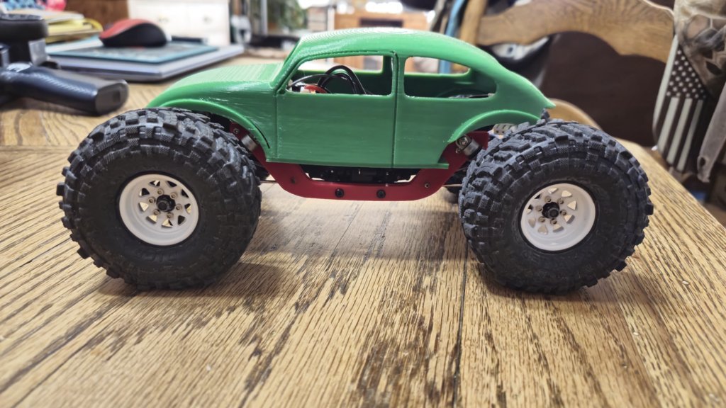

    Quiet in here, must be turning screws...:popcorn:
    Final color choice, for now. Maybe off-white next with a color change at the end to give it a moon roof, and number it 53 with a blue and red stripe. Redid the mount for the body, sits about 4mm higher now, locks into place better.
    It's just a friction fit to the frame, and a tiny piece of Velcro under the hood.
    it took a mild tumble today and the body stayed in place.
    Strictlytoyz, lowmower and Kwikvette like this.

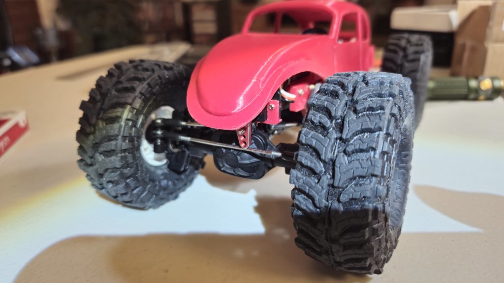

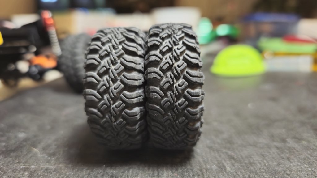

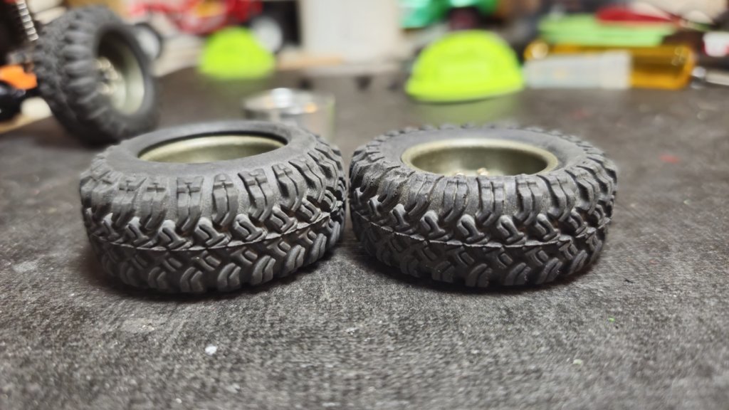

    The profile on the Z tires has never sat well with me. They have a fat bead that didn't sit right and caused the tire to bulge. Ran on the side wall quite a bit.
    Before.
    Printed a new ring and made it 2mm larger in dia. to fit the fat bead. I was just gonna print it thinner, and realized the inner and outer ring wouldn't seat. So tried this first.
    :cool:
    They stand taller too!
    After.
