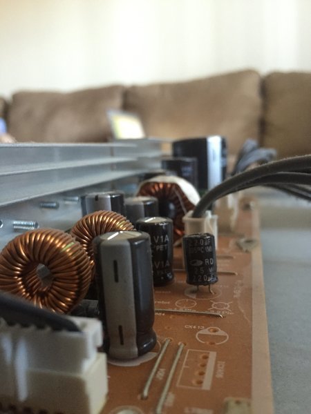

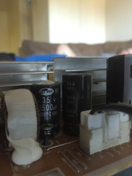

    Hey guys so I recently got a old plasma tv for super cheap. It's a 50" Samsung. Worked great and watched the tv for hours. Last night the tv screen went black after 10-15 mins of use. If I let it sit then turned it back on picture was restored for another 10-15. I pulled the panel to heck the capacitors. Most places online said it would be on the Y board, but j found these on the power board. Could this be me issue?

    Yes. Swollen capacitors are not good, and could eventually leak or short out.

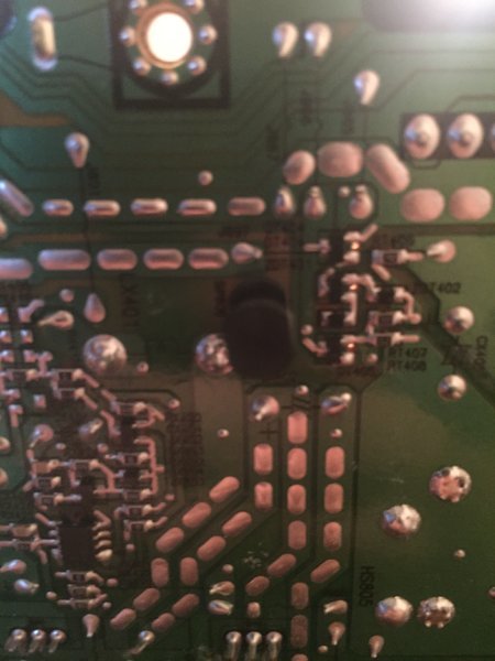

    The connections are so close together, would be worried about connecting multiple pointsimage.jpg

    OP, I did this for a living for 25 years.
    1) It is easy to do but I can understand your hesitation.
    2) Go to Willy's Electronics on Mercury Street in Kearny Mesa and get a good adjustable soldering iron and solder wick.
    3) Anytime you see a swollen CAP it's bad or going bad. I've saved a ton on computers, TV's, and other consumer electronics replacing CAP's.
    4) The bigger the blob, the better the job! (This is a joke and usually at the expense of people who can't solder worth a crap) You need very little solder to get a good job. Flux, Proper heat, and just a dab will do you. We used to practice on crap boards to get the feel for it. Find an old circuit board to practice on.
    5) when you do it. Heat up and pull out the old CAP. Then insert the new cap with those nice long leads into the holes, following the polarity as stated above. Then put a small squirt of flux on the circuit board. Touch the soldering iron about 1/8 inch up the lead on the new CAP and place the solder on the circuit board on the metal ring. Once the lead heats up enough with the help of the flux that solder will flow into and seal the connection. Clean with Technical Alcohol (not that crap they sell at Rite-Aid, get the good stuff at Willy's). Then clip off the extra lead with dikes. Tada.
