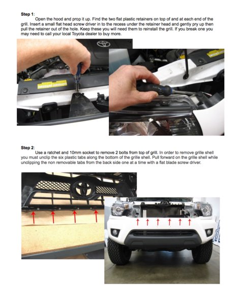

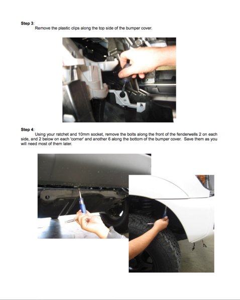

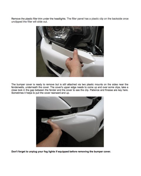

    before i get all into it tomorrow, anyone got any input on where to get started? i assume its like most bumper covers these days, everything done from underneath?

    Just pulled mine off a few months back. There's a YouTube video I used to find bolt locations.
    But as you thought, they're all underneath.

    yep, saw them, thanks those are great. i gotta replace this sketchy end piece, and the windshield, and truck is going on autotrader =/ first world problems haha
