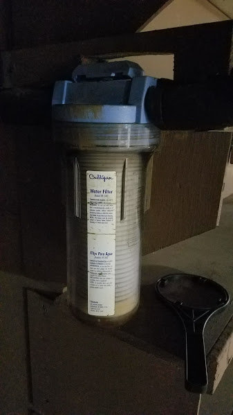

    Yes, it does. I don't touch the cold knob at all on the sink and it's the same behavior as if the tub was turned all the way to hot.
    There are two filters, one just after the jet pump, another just before the boiler. They looked horrible when I got here--don't think they had been touched for a long time. I cleaned out the canisters and replaced the filters.
    Where would the buildup be? That's what's puzzling me since most things work fine.

    Even with inline filters, sediment crud can start building up, especially if the filters have been ignored for a long time, the sediment can force its way into the system, once it starts to build up it gets nasty, especially at corners and bends and in galvanized pipe connections, very common in older homes, the galvy can get a huge buildup restricting flow, the inside diameter can get smaller and smaller, eventually to the point of not flowing at all...

    This is the tank off the boiler. I believe it's pretty simple--a coiled pipe with hot water from the boiler runs through, transferring heat to the water in the tank, like shown here: https://energy.gov/sites/prod/files...ublic/indirect_water_heater.jpg?itok=lPi0rSXW:
    The filters both look like this:
    I highly doubt it's an issue with the way water is heated. There's got to be a 50 degree difference between the water in the kitchen and the water in the bathroom--only 12 feet or so apart.
    I also don't see how it can be an anti-scald device or anything like that, because then only the shower would be impacted.
    Something sediment related sounds right--I just don't see where it could have built up in that span of pipe--unless it's at a bend or at the ball valve shutoff.
