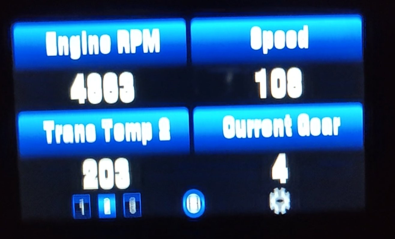

    I'm was just thinking about how many RPM's is the minimum you would need to be sure your driveshaft is balanced under any circumstances. I think the standard shops go by is is between 7500 and 10,000 RPM's? With the 3rd gen, once you hit about 75MPH it goes from 6th gear to 5th gear, then the faster you go, it drops into 4th. So if the engine is turning 4,800RPM's , in 4th gear, how many RPM's is the driveshaft turning? Does anyone know the gear ratios for each gear in the 6 sp auto trans?
    (FYI 325,60R20 with 4.56 gears)

    As I said earlier. 4th gear is 1:1. Driveshaft is at 4800 if engine is at 4800 in 4th.
    The transmission ratios were already posted earlier.
    The picture is blurry but it appears you’re going 108 mph. That’s not even close to high for that speed. I’m at 6200 driveshaft rpm at 108 mph.
