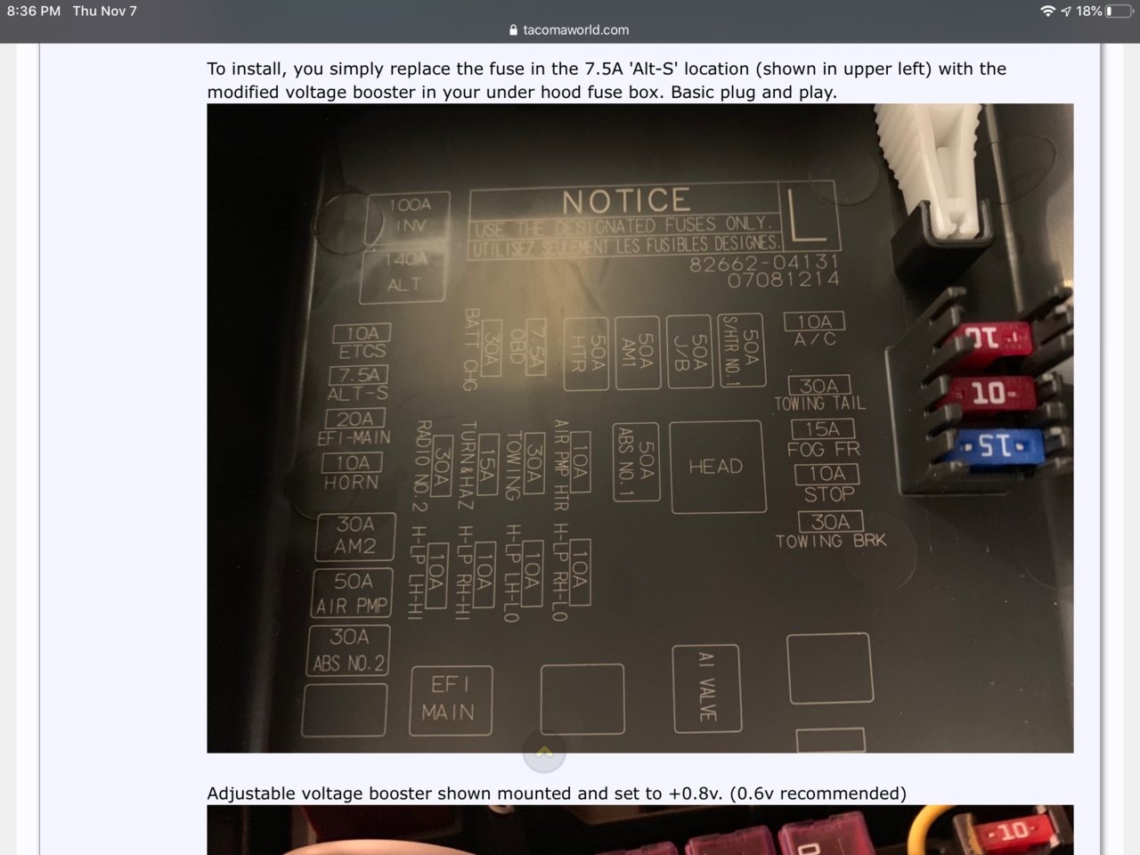

    The 2017's don't have an alt-s fuse.

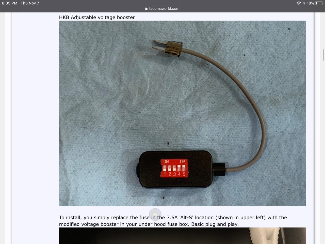

    No confusion. The Taco regulator is ECU controlled and tops out at 13.5V, if I recall correctly. You need north of that to not shorten the life of an AGM, like your Battery Tender does.

    Typical charging voltage is 14.2v or roundabouts.. it is controlled by the voltage regulator which is typically in the alternator housing itself (there are some ECU controlled alternators out there.. they are pricey too...) the ALT in our tacomas is designed to shutoff charging for fuel economy..... it will charge with 13.7-14.3v unitl it sees that the battery will return a signal showing about a 12.6v charge state.. it will then shut off and discontinue charging until voltage drops again due to accessories being used, radio, lights, cooling fans, etc... an AGM will like to see 14.7-14.9v to charge... it will accept the 14.2-14.3v charge, but will never "fill" the battery to capacity, couple this "never full status" as well as cell degredation (typical to see anywhere from 70-80% loss in amperage, and you have effectively negated the $300-400 you spent on that extra capacity, and or Ah storage.. add in freezing temperatures that rob amperage, and you may wind up in a no crank situation.... so be selective on what battery type you get.. its all about choice really... honestly I'm looking at the northstar 27f, or possibly getting a 31... and eventually expand my 12v system to involve the dc to dc charger, and a house battery for all my camping needs, and device charging responsibilities.

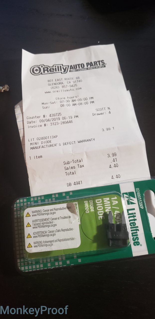

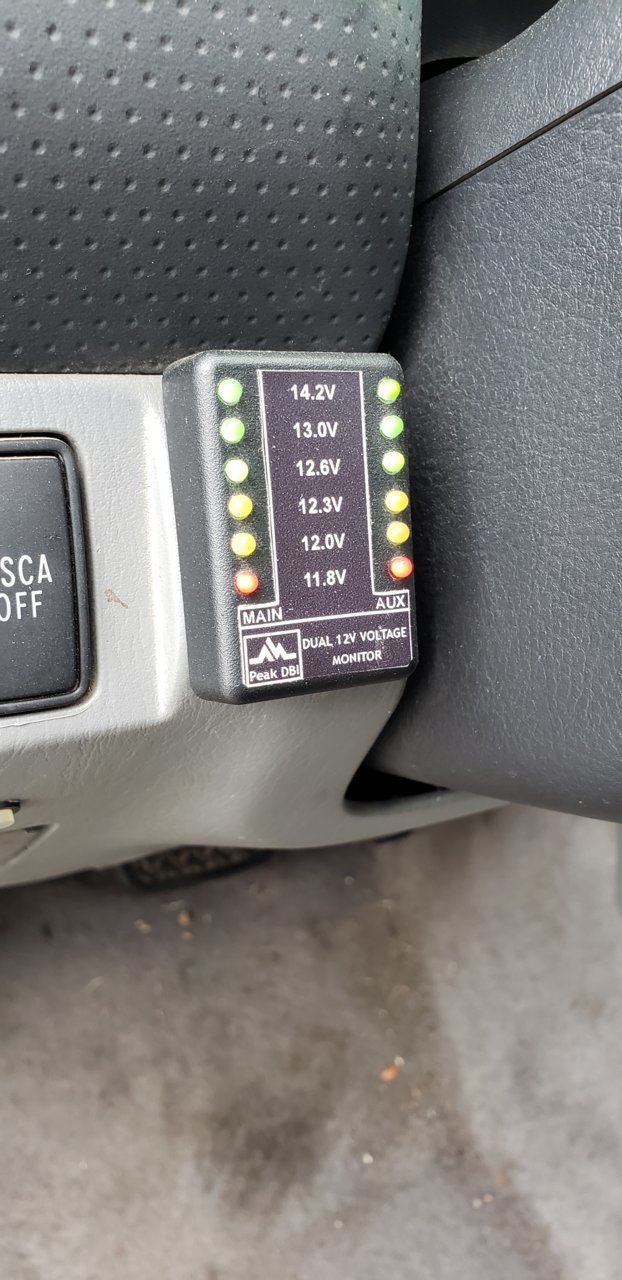

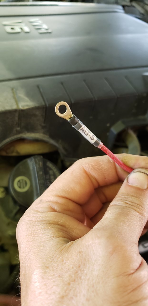

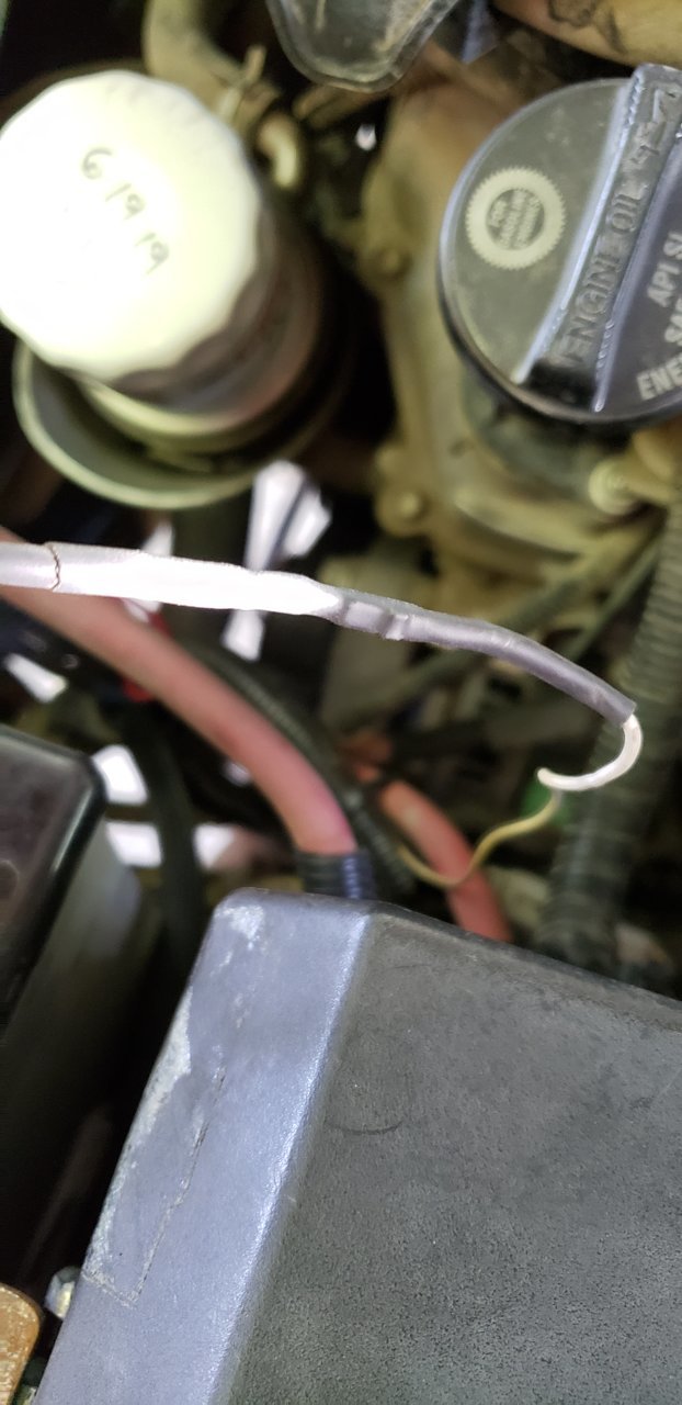

  19. Dec 4, 2019 at 11:36 AM
    #39
    MonkeyProof
    MonkeyProof Power Top
    Oct 7, 2008
    #9774
    12,812
    SoCal- SGV
    Edit: Didn't realize this is a 3rd Gen. thread...
    this mod applies to 1st and 2nd gen only

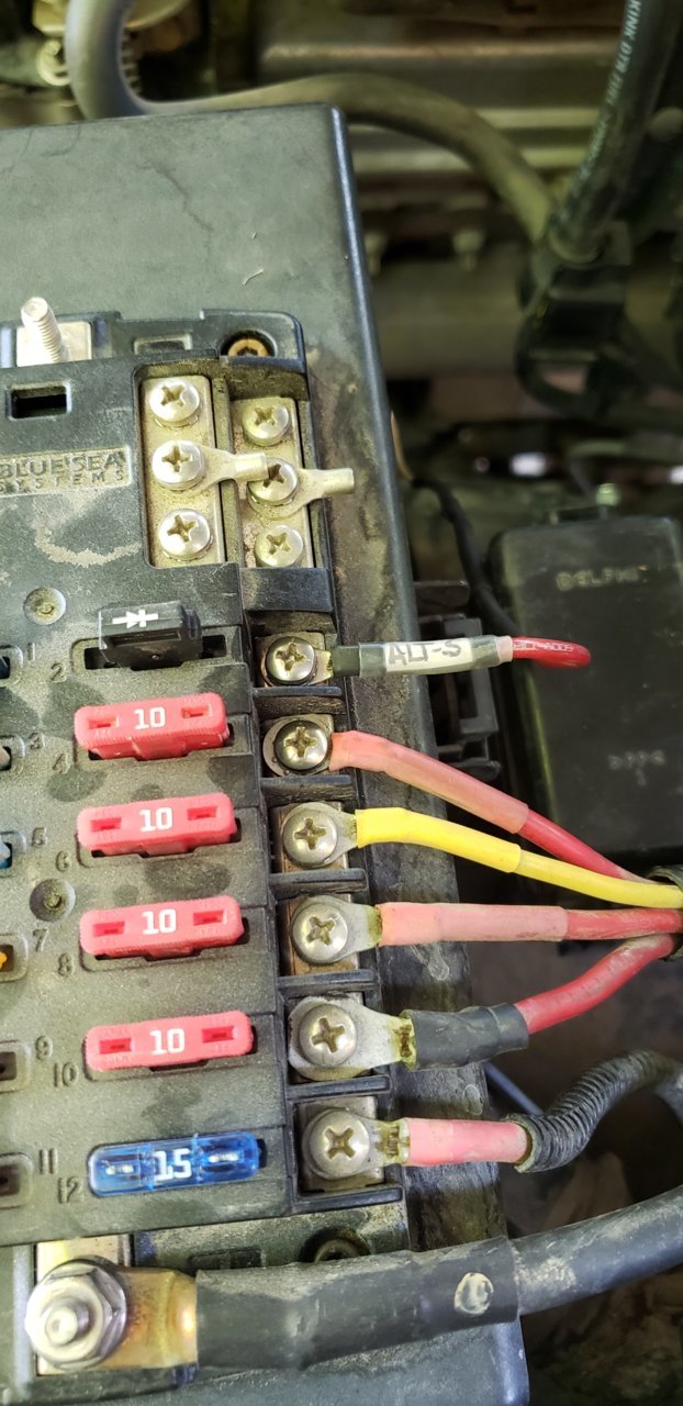

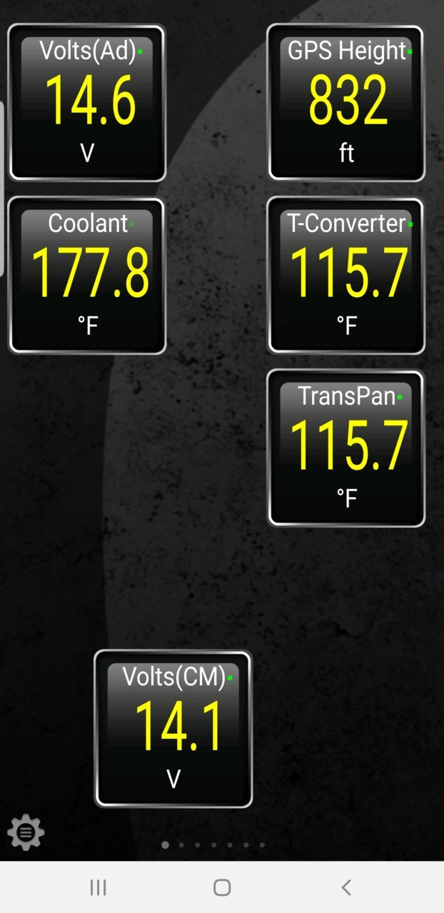

    A 5 dollar diode and voltage sense wire relocate is one would ever need to sufficiently provide the proper voltage to maintain an AGM battery(s)...
    20190908_165900.jpg 20171008_143811.jpg 20190906_110703.jpg 20190906_121145.jpg 20190906_125817.jpg Screenshot_20190906-125538_Torque.jpg 20191204_113400.jpg
