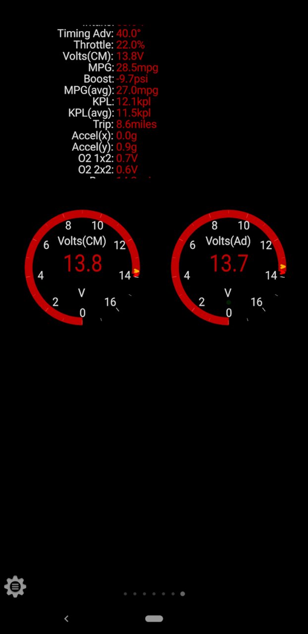

    Great question. My info is coming from my OBD adapter which is sensing the voltage at the port. I will get shot of both the OBD and a DMM.
    That is still a bit low for keeping AGMs happy long term though.

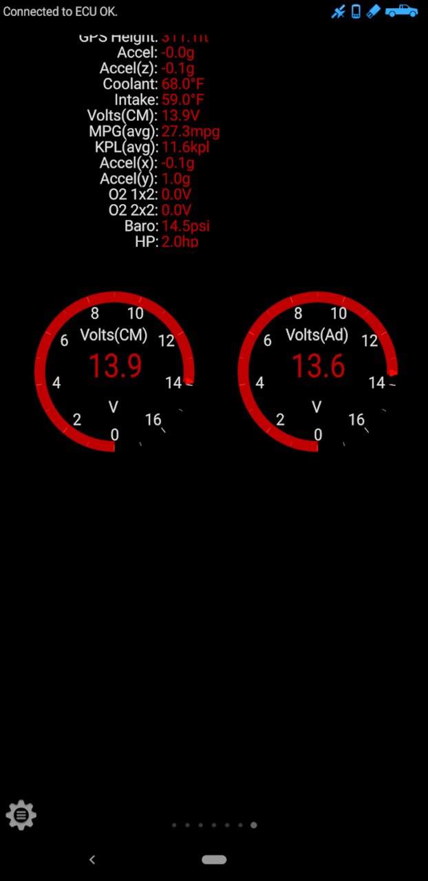

    This is what Torque said this morning:
    Start up:
    About half way to work:
    End of the trip:
    The range carats show that like what I said, the charge voltage is rock steady on my Taco. Typical on the ECU commanded side, it showed 13.9v and the Adapter measured side was usually 13.6v. About 0.3v drop isn't bad. On my bike before installing a large gauge harness with the new light, there was a 1v drop measured. I wouldn't be surprised if the malaise era GMs varied by more than 2v, remembering seeing the lights dim and flicker at idle. :D
    I have my DMM with me and will verify the battery voltage. Was yours at idle or a bit higher RPM?
    I suppose my 13.5v assumption that I posted about was that the battery was seeing the same 0.3v drop. It is pretty cool that the battery does see commanded voltage at any rate.
