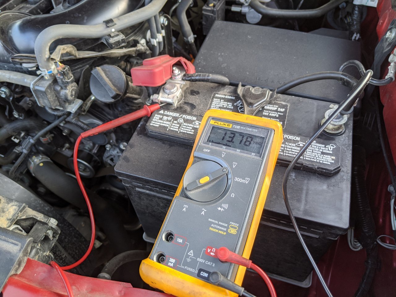

    This was my measurement after a longer than normal drive home while idling:
    Not really that far off from yours, but a bit different. I'm at 28k and over about 2.5yrs old battery.
    shakerhood[QUOTED] likes this.

    LOL, I am just about to turn 28K too, my battery is probably a few months older though as i have a March 2017 build date on my truck.

    Yep. I'm June, 2017.
    I'm happy that it cranks well even with some drain (light, accessories, and such).

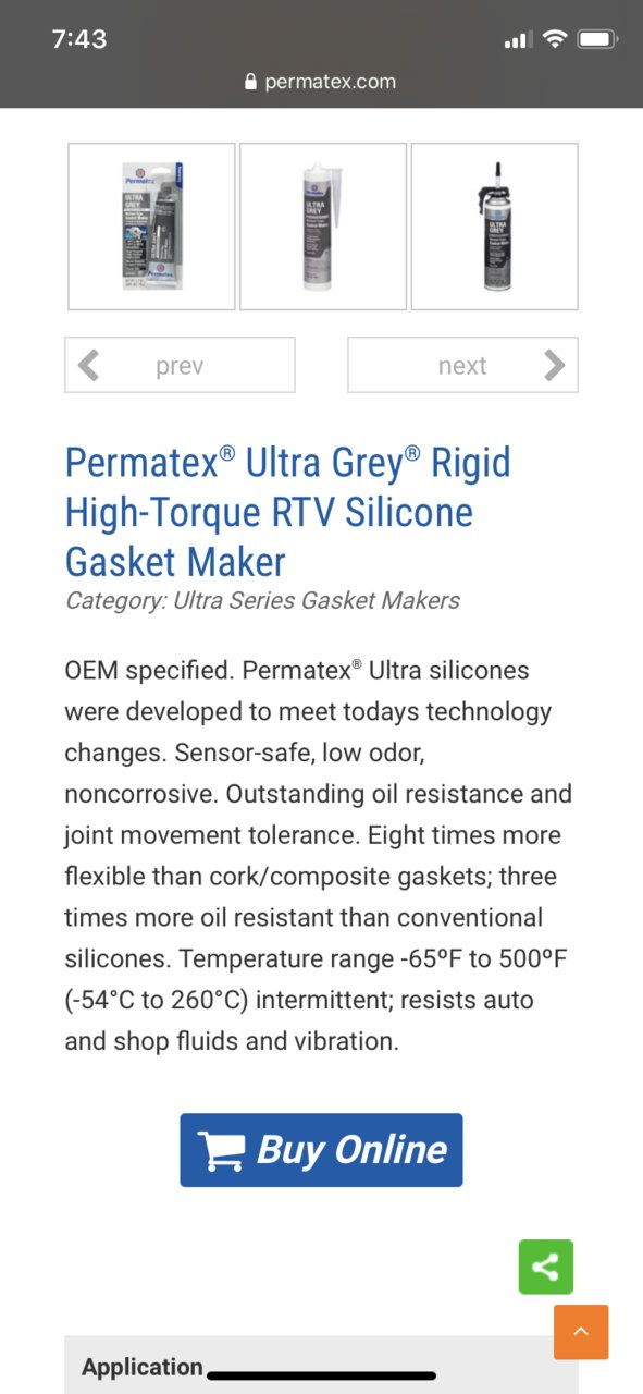

    Silicone outgassed acetic acid. It just speeds up corrosion.
    Is that trolling too? LOL

    definitely not trolling. I didn’t think silicone would outgas acetic acid? Acetic avid is vinegar right? Never had that smell. Haven’t needed it since I switched to agm? I used to use some permatex on spark plug caps and other stuff under the hood for water fording protection.
    edit: permatex ultra grey it says non corrosive. It does say it’s silicone....so I don’t know, but it seemed to work for me. I know I used on my transfer card when I built my dual case and used it on both 3rd members when I rebuilt the front and rear axles.
