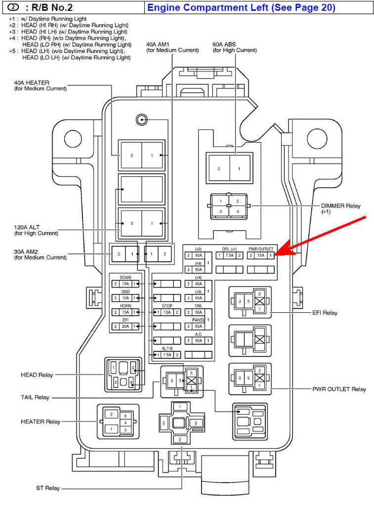

    On mine the circuit is fused from the factory."PWR OUTLET 15A", upper right, 4 up from the relay spot (yellow arrow).
    Additionally, each outlet has a fusible link on the back.

    Interesting my 2000 does not have the fuse

    Interesting indeed, 2000 wiring diagram.
    2000 fuse box.

    Since your now going to be Hot all the time there is no protection on the other side of what was the relay till you get to the 120 amp alternator protection .
    I tend to err on the side of being safe to many years working on other peoples Trucks
