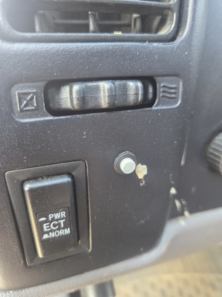

    Flashes red but isnt that bright, thats why it looks white

    That’s not a factory alarm.

    Something tells me that this isnt OEM

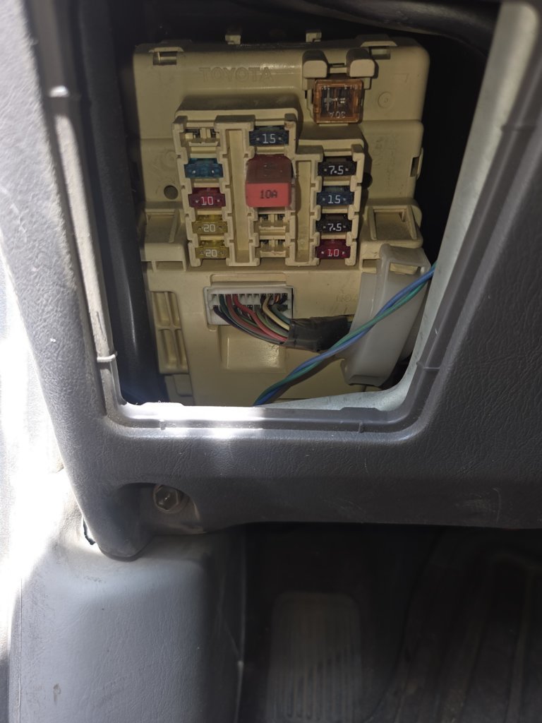

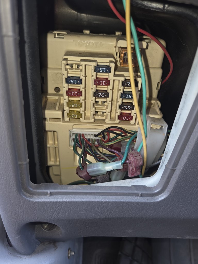

    My friends 2002
