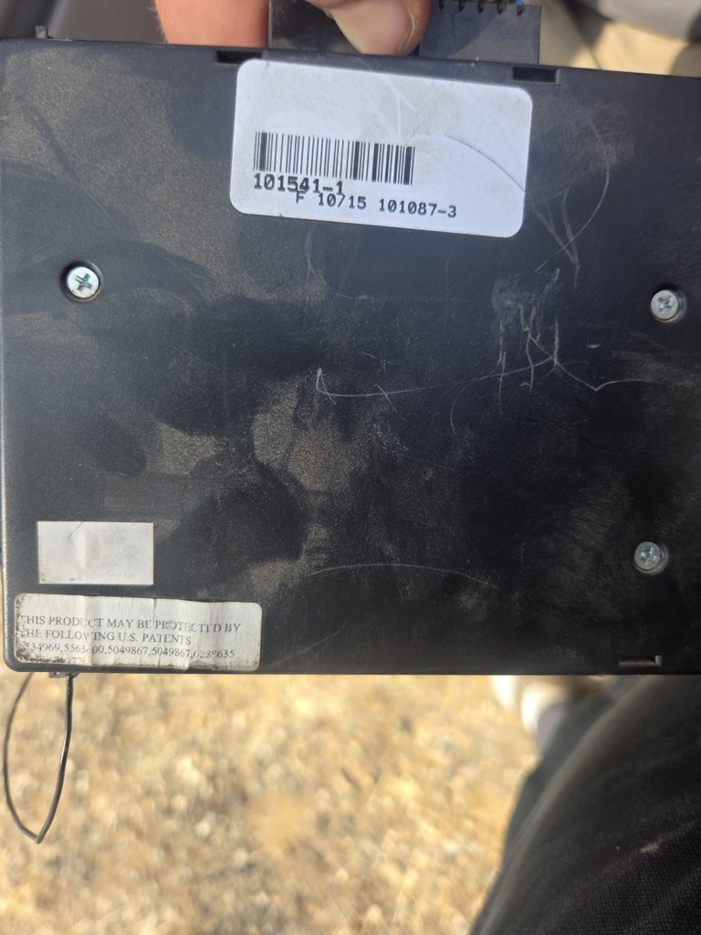

  5. Jun 15, 2025 at 10:36 AM
    #25
    TacomaFloppa
    TacomaFloppa [OP] Well-Known Member
    Jan 6, 2025
    #463665
    115
    Its out! Had a reset code but fuck this piece of shit alarm

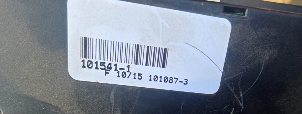

  6. Jun 15, 2025 at 10:37 AM
    #26
    TacomaFloppa
    Jan 6, 2025
    #463665
    115
    Another pic
  7. Jun 15, 2025 at 1:01 PM
    #27
    Glamisman
    Glamisman Well-Known Member
    Oct 22, 2016
    #200436
    4,896
