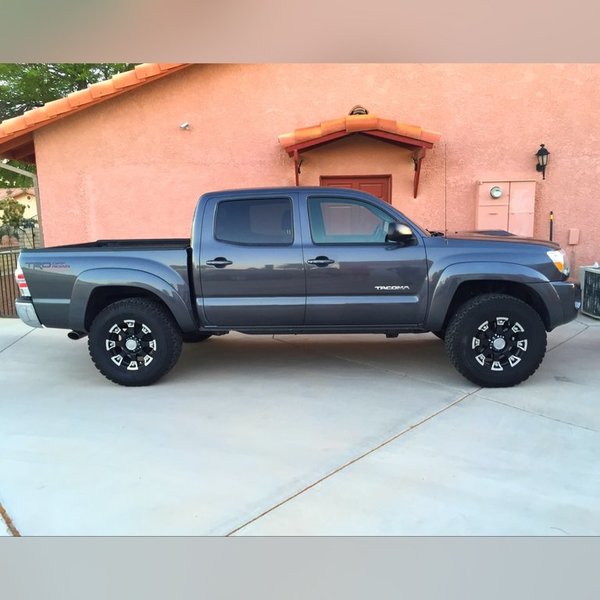

    from 30-60 mph my whole truck shakes. Steering wheel takes the worst of it. Just had front end aligned and I've had the tires rebalanced 3 times. Going 55 mph I've put it in neutral and it still vibrates.While turning into a corner it appears to go away. It also has no lift just bigger tires. Any suggestions?
