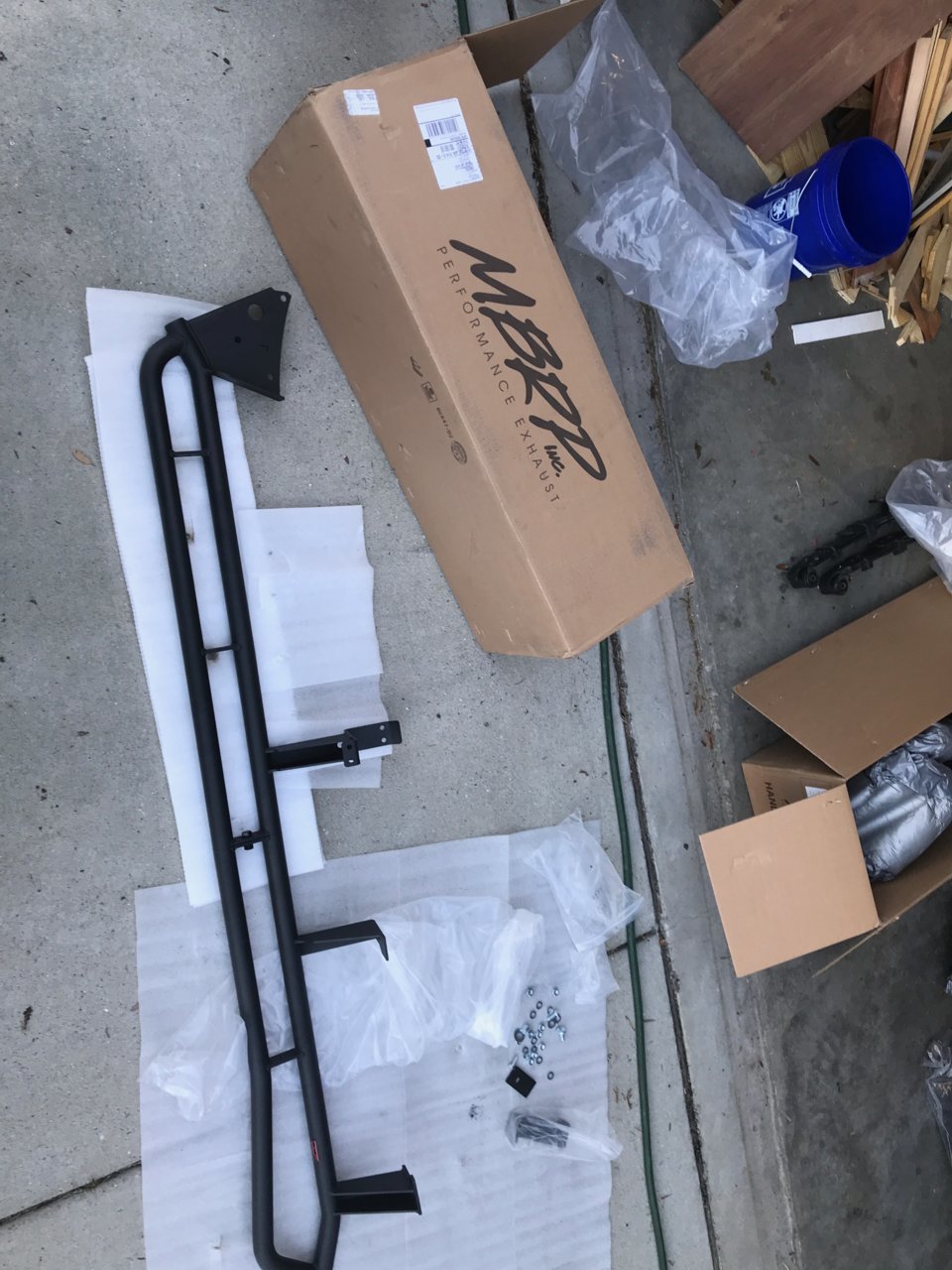

    Oh, sorry. It was delivered late last night so all I could do was store it in the garage. The two boxes were larger than expected, had to use a hand truck to move them. One box was damaged, so hope packing protected the contents. Will unpack and try to install after work today.

    Ok, unpacked after work today and everything looked good despite the damaged box. Front and rear halves bolted up fine. But thats as far as I got. There is this bolt and spacer your're suppose to get between the frame and rear suspension mount using a bolt thread lead, step 3 in the install instructions. For the life of me could not get that bolt to turn into the spacer and bracket hole using the lead. I played with it for an hour and decided to call it quits for the night.
    Oh each rail weighed 46.2 lbs and hardware weighed little over 7 lbs.

    Called MBRP, they're sending a new bolt that's suppose to feed easier through the holes. Told them about a couple dents that wouldnt be visible when installed and they asked for pics so maybe getting replacement pieces too. Will update when I hear back...
