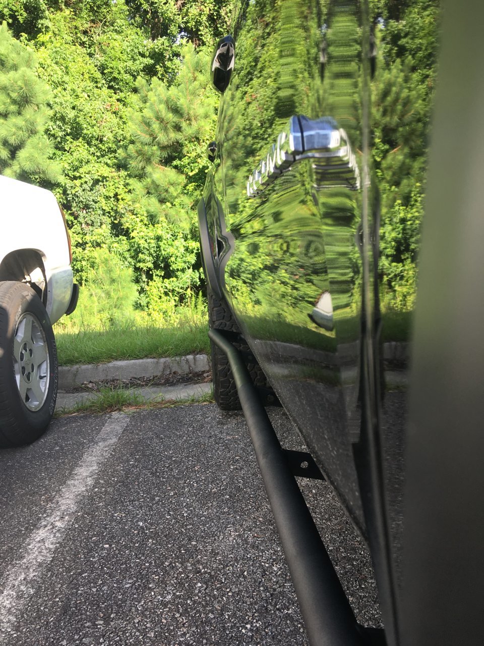

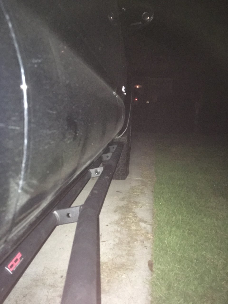

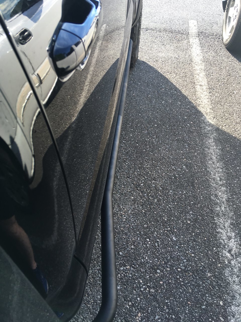

    So I took a couple extra photos of the sliders this morning. I wouldnt say they won’t protect you from doors.. but they do stick out enough that if you have enough lift- you should be protected.

    -But they certainly are not sticking out like the more common styles that everyone is familiar with. I hope that answers your question

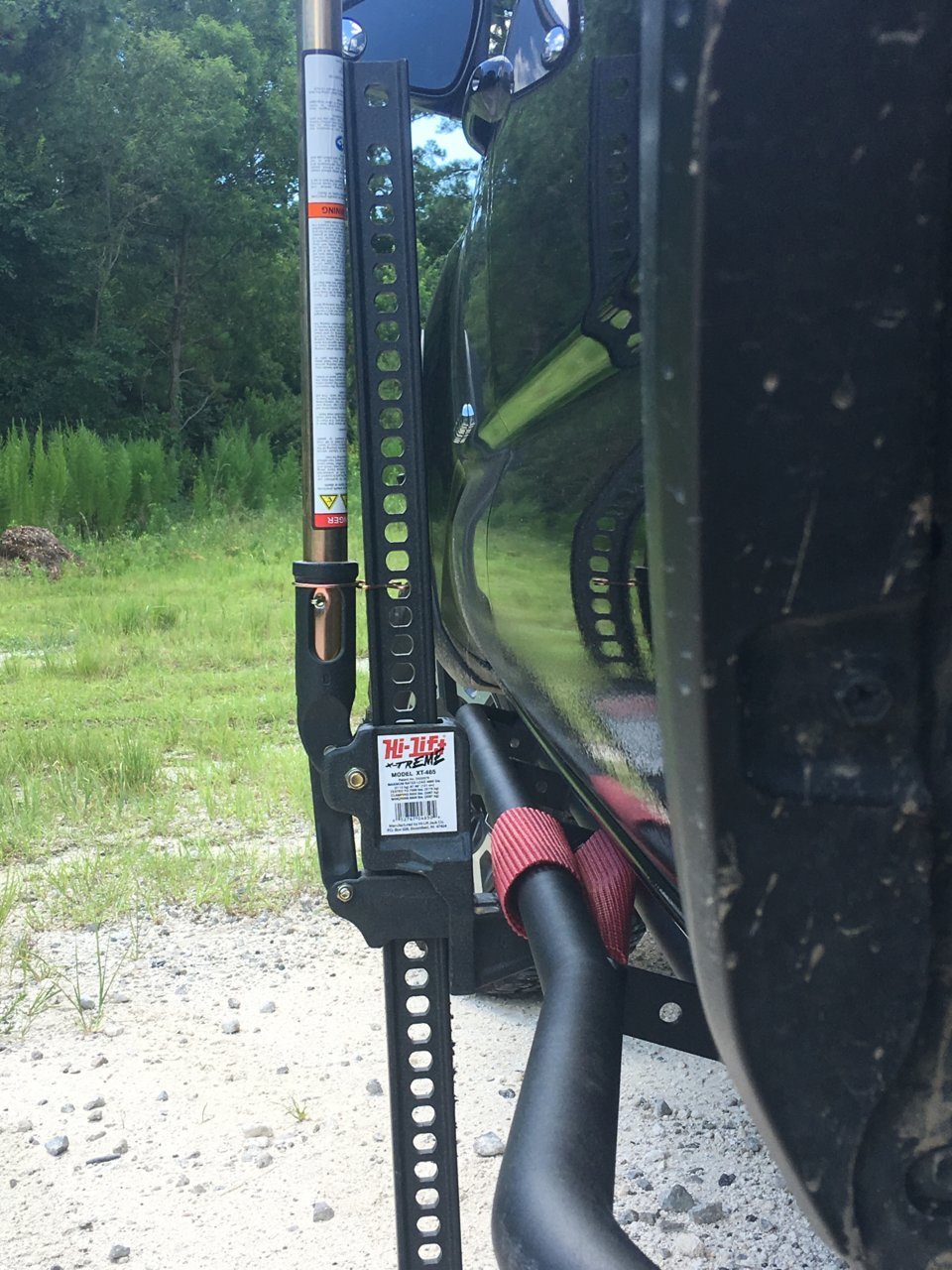

    Just threw the hilift on it. No sign of bending or anything else that would make me insecure. Again, the set is pretty solid.
    Side note: wrapped some rubber liner I use in my garage to protect it from the hilift. Ill be purchasing a slider attachment to keep the process safe.

    Be very careful using a Hi Lift with the door shut. They can slip out from under the slider and destroy the sheet metal on a door or smash the window out. Safe practice is to lift with door open...

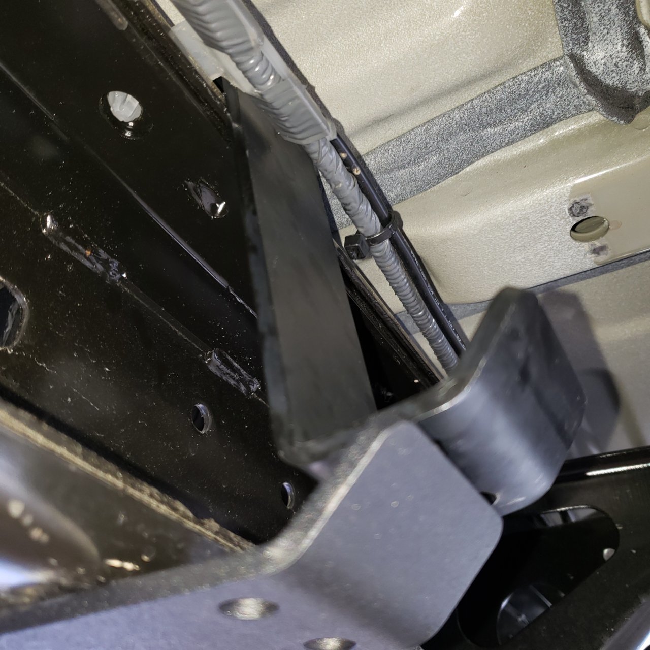

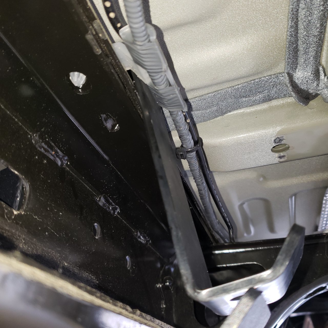

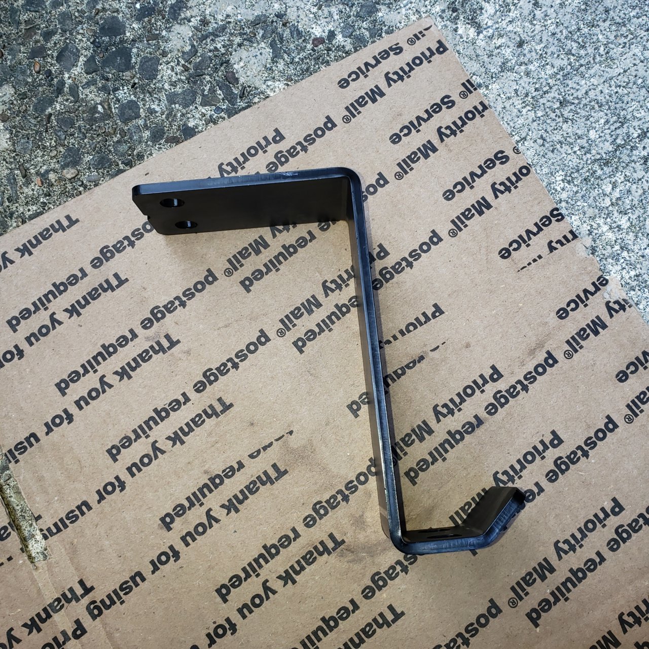

    Did you have an issue with the front inner bracket not fitting the frame and the bolt holes not lining up? When I line up the top bolt holes the bottom bolt holes on the other side is way off. I have a 2019 TRD offroad not sure if Toyota might have added some thickness to the frame making the bracket too small. I attached some pictures, not sure if I am explaining correctly.
    BTW these sliders was the most annoying thing I have installed in my life, I would not wish this torture on my enemies.

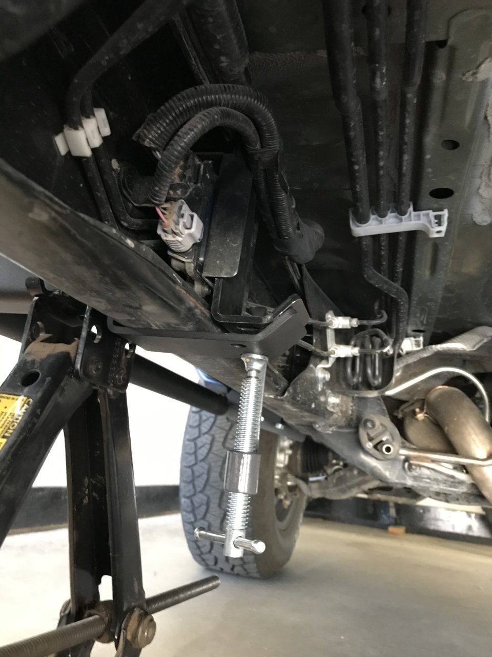

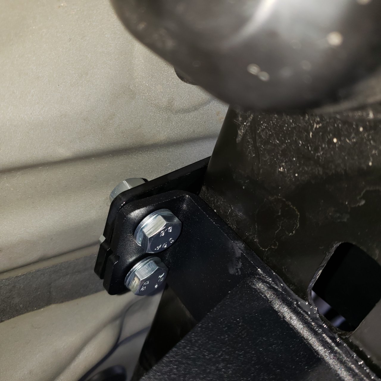

    Justin Case anyone else has the "bracket not aligning" issue. I know this is too late to help gen-tso, but maybe someone else has this issue. Also it's easier to use longer bolts to first clamp it together then you can change those out with the bolts that came with the kit.
