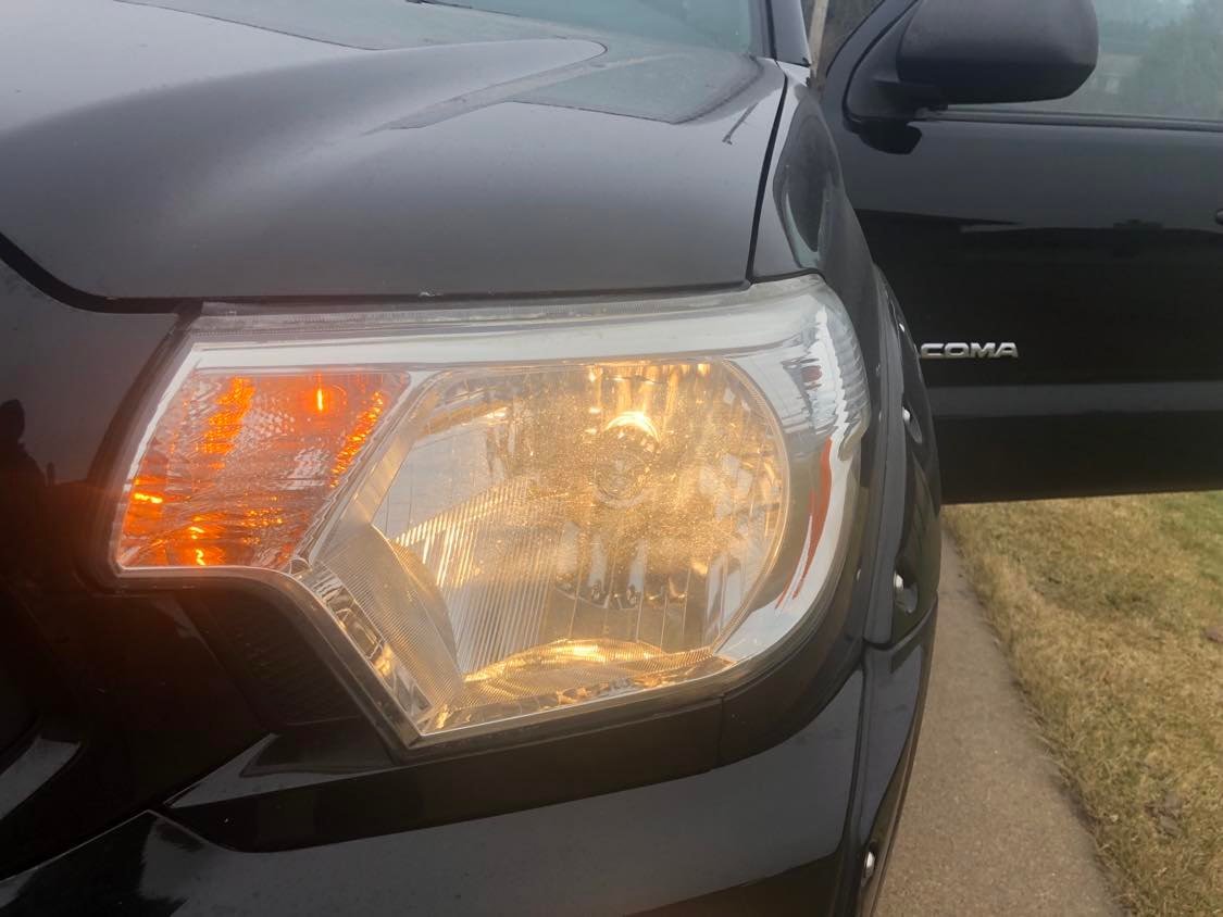

    Anyone know part number for the small corner bulb on the headlight? Mines is dead

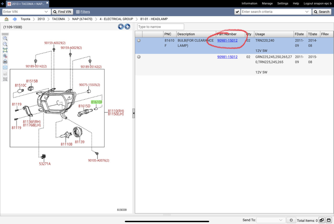

    Should be 2827 amber.

    When I replaced the stock ones in mine they had Euro-type markings that said, amongst other things: "5W". (5 watt) The equivalent "parts store bulb" is a: 5-watt 168NA (natural amber). Some will say 4.x watts or some other nonsense on the package. Try to find one that says 5W on the package. FWIW, a 194 is 3 watts.
