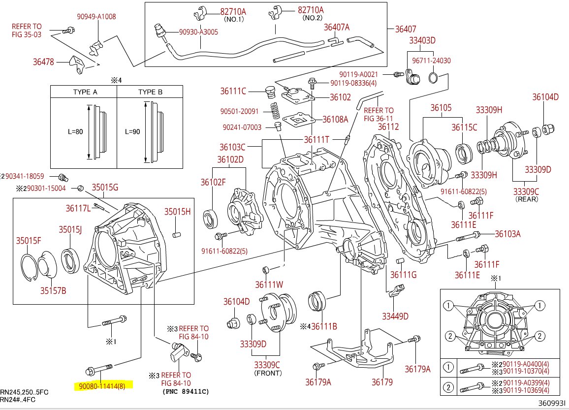

    90080-11414

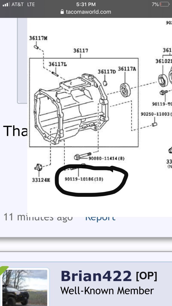

    I’ve found a couple of different part numbers but not sure wanted to see if someone would confirm my findings

    That’s not the right tease adapter

    I think it’s this one

    That looks like tranny to block

    looks like the -11414 to me. The assy in your last post is spun 180 degrees from you first post.

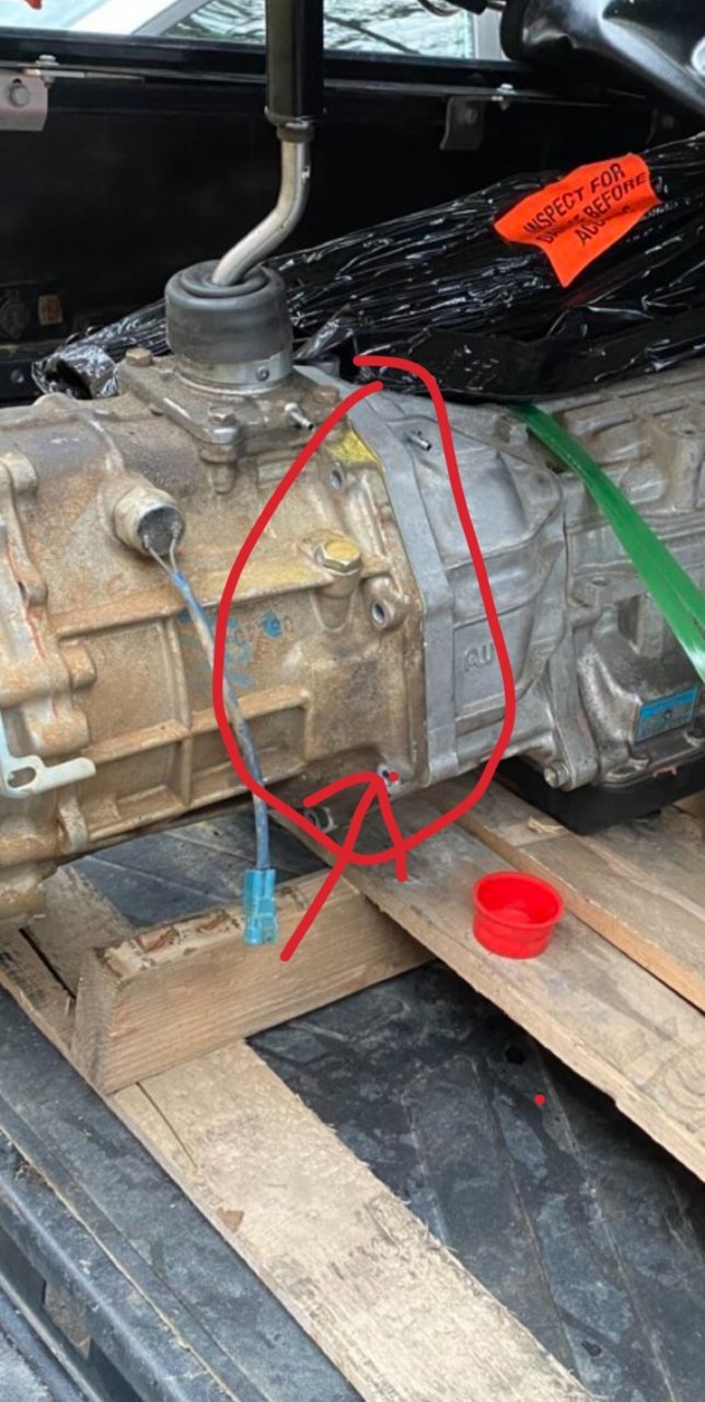

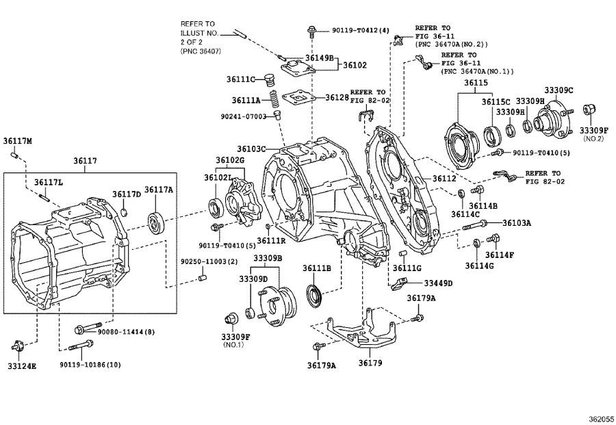

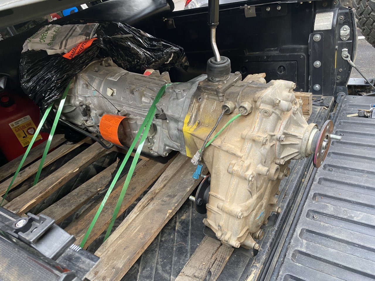

    Let me show you guys a better pic of adapter housing. It does not have that squarer look to it on the side that bolts to trans. It has the same look as the pic I posted. Also it does not have that plate at the top.

    I’m going to say 11414

    I was looking at the pic backwards thinking the clean piece was the transfer case not the dirty piece.

    Ahh yep, I can see that

    I'm late. But the 90080-11414 is your bolt. Eight of em.
