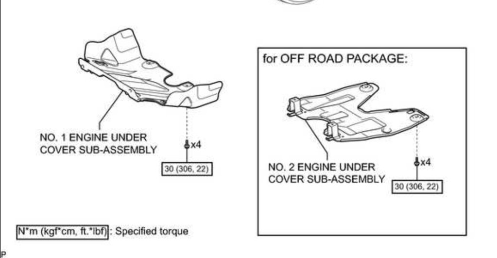

    18
    Anyone know the torque specs for the oem upper and lower skid plate on Tacoma Trd off-road? For 2022

    First Gen
    Spec sheet I've been using says 22 ft/Lb.

  9. Nov 8, 2024 at 3:11 PM
    bryan_taco
    bryan_taco Member
    Jan 25, 2019
    #280610
    21
    Bryan
    2019 Tacoma Off Road
    Front 4 bolts are 33 ft lbs 17mm bolts
    Rear 2 bolts are 21 ft lbs 12mm bolts

    If the OP has the TDR plate the 5MM Hex are 18 ft lbs.

    22 lb ft
