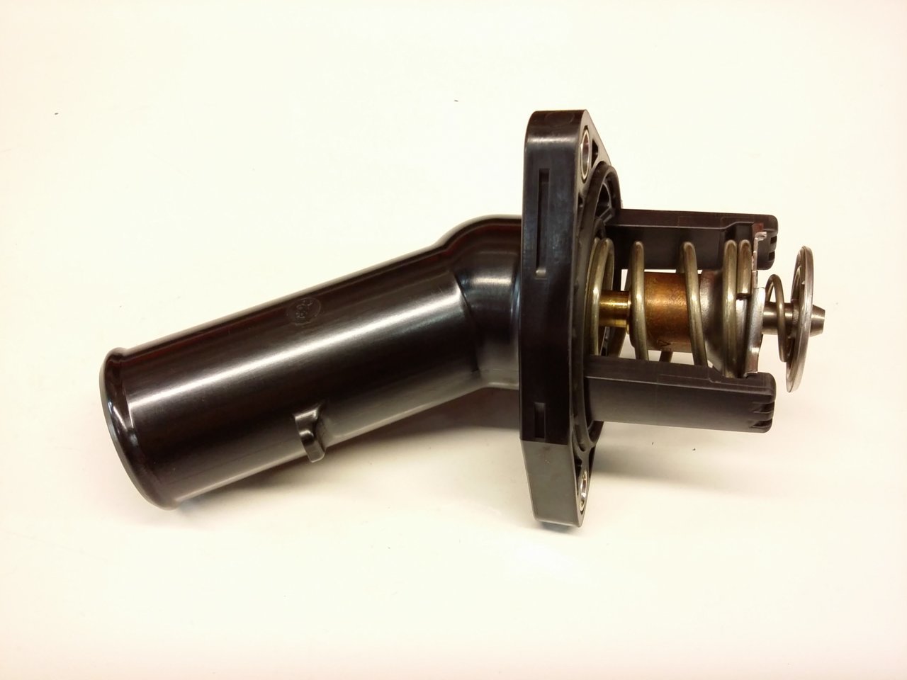

    I have a 2012 and can't find the part number for just the thermostat. All I can find is the thermostat/housing combo. Do they not sell the thermostat separately? a_20150818_1244109723.jpg

    It's sold like that.

    Yep. Comes as an assembly.

    Does anyone know and can confirm the part number for the thermostat gaskets? I think its 16326-31020?
    Also, when changing the thermostat is it recommended to change the housing as well? I'm just wondering because they sell an assembly kit (t-stat + housing + gasket (16320-31011)) ; Toyota often sells kits when they recommend doing the whole thing...

    As others have mentioned it comes as a complete assembly, housing and thermostat together. The gasket is separate. And yes that's the correct part number.
