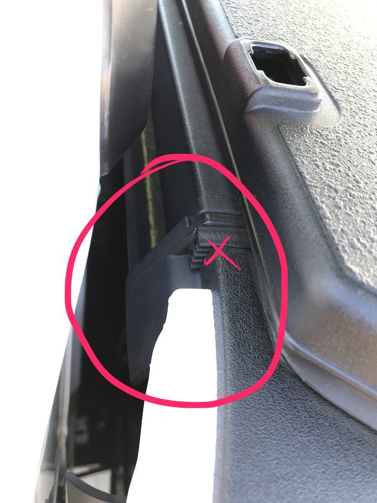

    I'm looking for the oem tonneau cover part number for the rubber plug/seals that go on either side of the front of the bed. I have a picture of them below. Any help would be gladly appreciated.

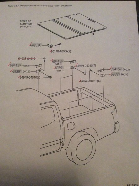

    Your car came with the tonneau cover from the factory? Toyota said if you can give them the vin, they will be able to give you any part comes with your car.
    I'm looking the part number of the bolt and the lock goes underneath, but the problem is my vin number doesn't show the tonneau cover, if your car comes with the tonneau cover you will be able to give me yours, to help me buy the part? Thanks.

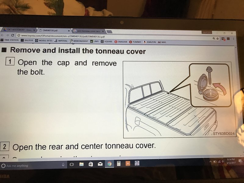

    Same to me, I bought the oem tonneau cover from somebody on ebay, and I'm being buying the pieces to put it together, but the last one I need it's the this bolt (see attachment) and also the lock I think goes underneath. Hopefully you can give me a clue how can I get this or do it without it.

    I found this on another post. Looks like you need the type 2 mount and bolt.

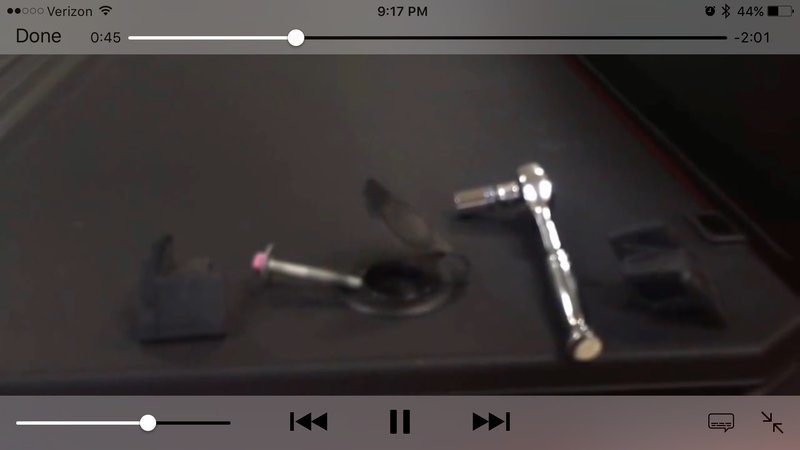

    Hey I saw your picture about the part number your are looking for, could you do me a favor could you take a picture underneath of that bolt, I want to see what goes there, I need all those pieces.

    My picture was from a video online. I haven't ordered everything I need yet. I was trying to find the p/n for the rubber seals that go between the front rail and side rails.

    I think the part numbers you are looking for are:
    69442-04030 is the striker (type 2)
    69415-04040 is the striker cover (type 2)
    I'm unsure of the bolt part number, but when I got my cover it included from my seller.

    I found the numbers for the seals I need. 62541-04010 and 62542-04010

    This is to avoid leaks inside of the bed? Right? I don't have it either.

    Yes it goes up front to prevent leaks.

    I got a pic of the driver's side installed to help you with orientation. You will have to trim the bed rail caps back a little at the front.
