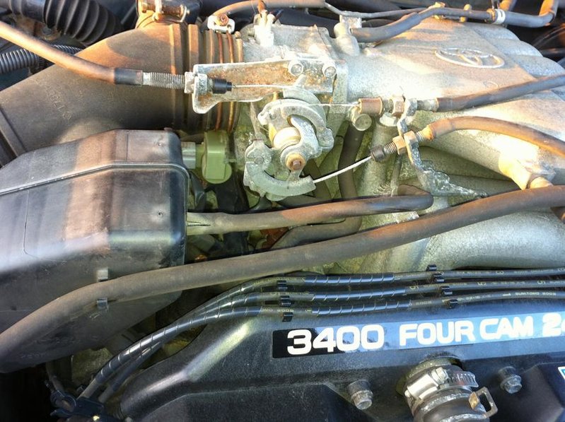

Anyone know what hose this is and part number? Tacom 3.4 2001

    Yea, i replaced it with some hose I cut, but the stock hose gets wider at the end, so the new hose is barely on. I guess I'll hollow out one end and see if that works. I'm little OCD with my truck so I would like the stock hose on there.lol

    I had to replace that hose on both my Tacomas. The nipple in the black plastic is bigger than the nipple on the metal tube (on the right in your pic). I bought vac hose to fit the plastic and used a small hose clamp to tighten the hose on the metal tube. Could have used a zip strip probably, but I had a small clamp handy.

    I think it is number 17343B in the link below.

    Yea I think that's it. Thanks for the help!

    mine was cracking just like yours; I bought a 6' length of vaccuum hose from Advance Auto parts and cut it to length. I used a lighter to heat up the end so that it would slide completely onto the nipple.. hehe..
    then I got the urge to clean up the engine bay a little and went ahead and removed the ISR all-together (aka ISR delete mod)
    I have since painted that cap all nice and black.. Its louder, haha especially at WOT maybe a little more throttle response but thats just the butt dyno talkin
