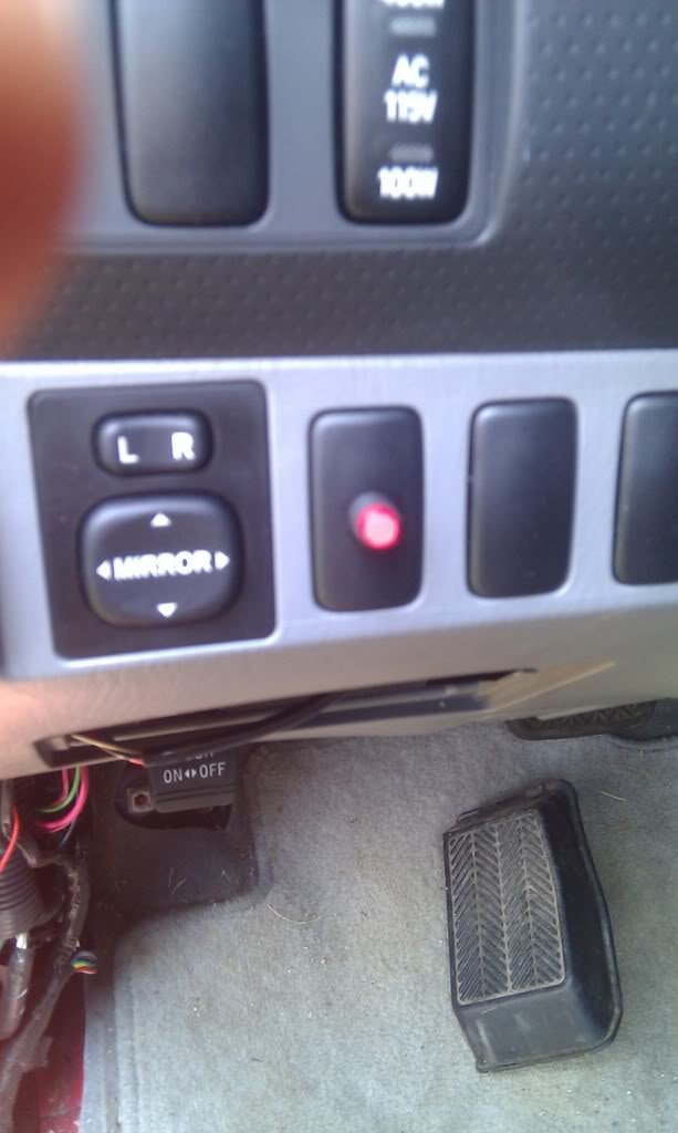

    I was told when I bought the truck that the mystery button was something to do with an old alarm...they thought.
    Well I got to doing some detective work today and here is what I found.
    Button on dash (and my finger)

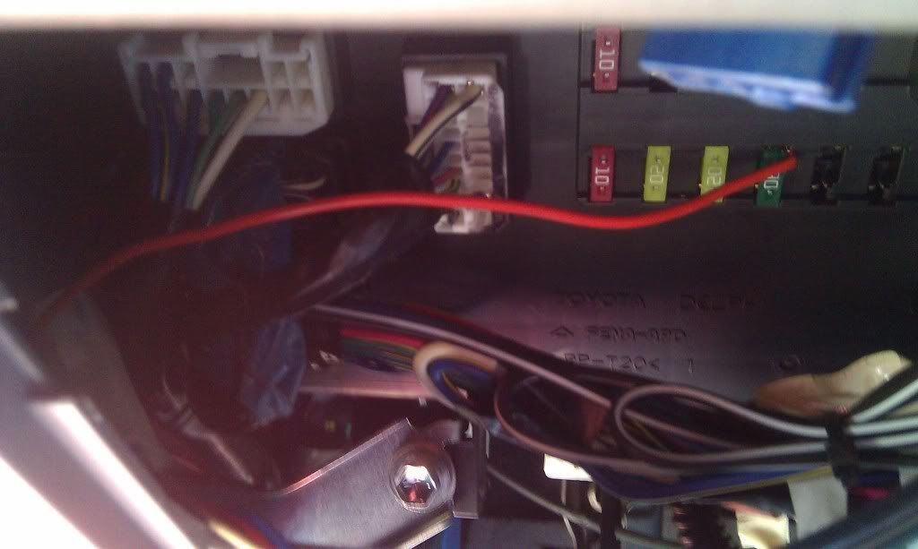

    Fuse block (powered at a 10amp) looks as if something has been done to the bottom left plug also.

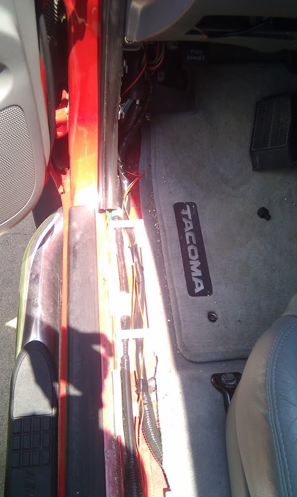

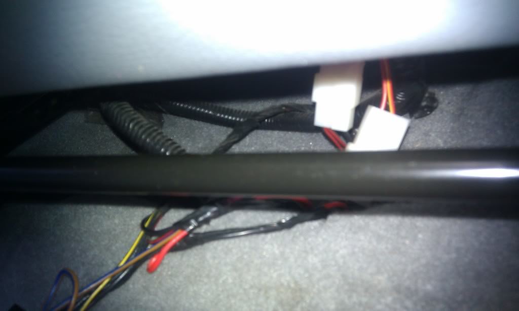

    Two red wires that run under the driver seat...
    Wires under the seat???

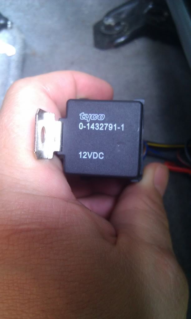

    Wired to a relay that has one set of contacts jumped...

    Ok it has factory heated seats. There may have been at one time an alarm on the truck but I have yet to located anything more then what is pictured here and a hood pin.
    And if you push it it will light up one time seems to make no change running or not. 2nd push no light up.

    My best guess would be an aftermarket seat heater. Can you trace the wires any further?

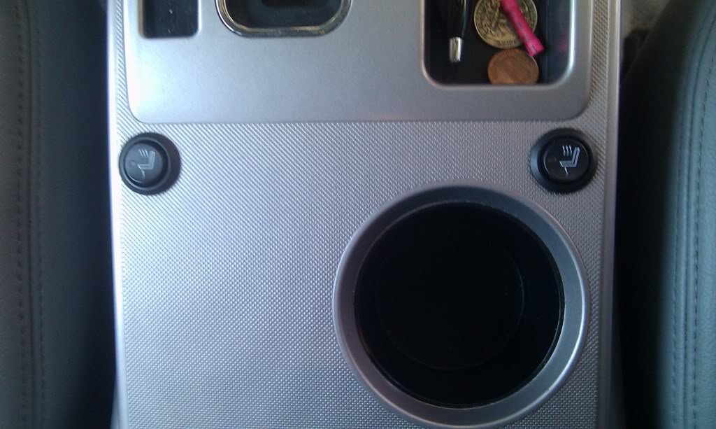

    From what I can see they go from the relay to:These buttons for the seat heaters. (for the record I didn't know that Tacoma's didn't come with factory heated seats. This is my first Toyota and am learning) With that being said why the heck would you want it ran to a lighted switch on the dash anyway...?

    Hood pin tied to light= light changes when pushed... old alarm system would be my bet.
    edit: hmmm hood pin switch to old lights or old alarm?
    (btw- center comes off VERY easy, easy to check under to confirm)
    pos. to "seperate" systems?!

    Pull that fuse out , remove the wire and pull that out! As long as it's plugged into your fuse it is HOT! It's aftermarket that someone had rigged up.

    The heated seats may be a dealer installed option, not factory from Toyota. It also looks like you have leather seats, again not a factory option. That button is probably a shut off for the heated seats. I'll bet the heated seat buttons don't work unless that button is lit right?

    So depending what the last owner was doing, here is what is probably happening here.
    The original owner more than likely wired the seats straight to the battery, this in-turn killed his battery one day. So said owner decides to wire the relay control through the ignition circuitry like it should have been done originally. The fuse that it is hooked to is what fuse? That will tell you for sure.
