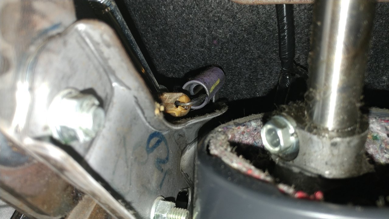

    This happened on the sb prerunner i traded in. I think it belongs to the break pedal. When i found that my break pedal got very noisy.

    After i pushed pedal it would almost clunk back into position

    I have a guess.... Have you pulled your dead man's pedal off? That looks like a broken part of the tube that clamps over a nub that holds the dead man's pedal to the floor.

    So I re-discovered this part still sitting in my glove box...thought I would revive this thread to see if anyone has identified it...

    Looks like the rubber brake pedal spring silencer, see if the coil spring that returns the brake pedal has a piece of plastic or rubber inserted into the center of the coil spring, if not shove that in there to keep your spring from creeking when returning and going braaaaang as it stretches out. Sometimes they back themselves out. Install it near the top 1/3 of the spring coil.

    Thanks KR, I will check it out. Do you by chance have a pic of it installed that you can post?

    Does you drivers side visor hang and have slop in it. Could be the bushing that keeps it from falling. That's a maybe though I've never saw that part in a Tacoma before

    OK, I got under there and found the spring. Inserted the rubber piece into the spring from the top...looks like it is just the right size so I guess that is where it is supposed to go. You win KR!!

    Yay! Sorry I forgot to take a pic...

    Here's mine... :D
