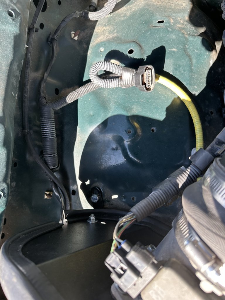

    Added a k&n intake, reinstalled the MAF and plugged it back in. Runs drives fine but I noticed this plug hanging under the stock intake. Any idea what this plug is? 2001 Tacoma 2.4l 2wd

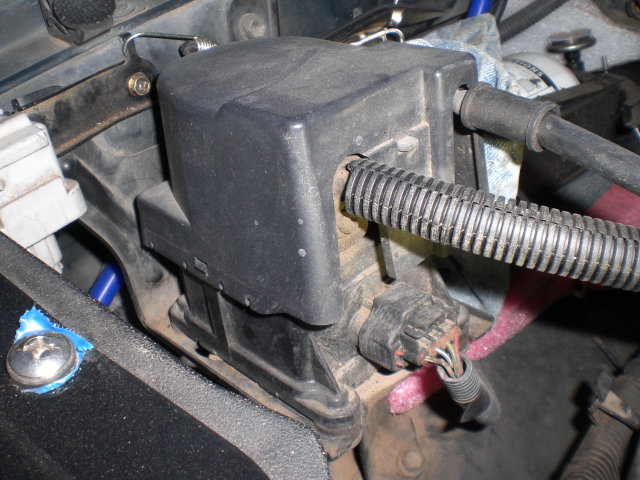

    Cruise control or abs pump is at the location. Trucks may have the pigtail but not has the system

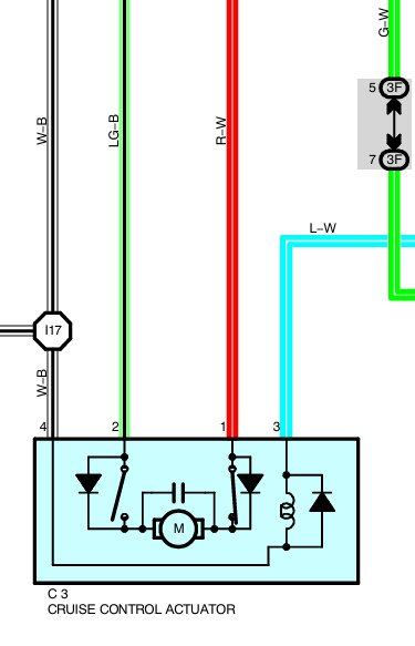

    It's the connector for the Cruise Control Actuator.

    Looking at that photo, I’m counting 7-pins. Are my eyes deceiving me?

    If you zoom in it's just 4 pins, the other 3 smaller holes are blank.
