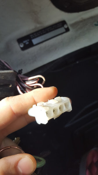

    Looking to buy the male end to wire up my new cap. Anyone know what this plug is called?

    You can go to any auto parts store and pick up a new set of 2 or 3 pin connectors
  3. Feb 14, 2017 at 11:22 PM
    koditten
    koditten Well-Known Member
    Sep 8, 2013
    #112077
    18,434
    Kirk
    Central Michigan
    04 trd x-cab 4 x 4 3.4l
    Reserected from the dead.
    If it was me, I would solder in male and female flat 4 trailer plugs. You can get them anywhere and you can only plug it in 1 way. Cheap as hell, too.
    ready6delta likes this.
  4. Feb 15, 2017 at 8:10 AM
    cliffyk
    cliffyk Well-Known Member
    Oct 27, 2016
    #200890
    2,039
    Cliff
    Saint Augustine, FL
    2009 DCSB SR5 TRD Sport 145k miles
    They are called Molex connectors. "google" it and you'll find many vendors and references...

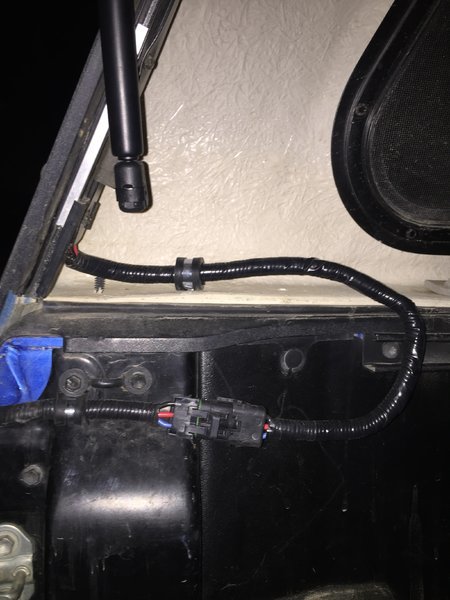

    Ended up slicing a 4ft 4 pin trailer extension in two and doing this today. Really pleased with how it turned out for the most part
  13. Mar 2, 2017 at 6:15 PM
    tacotmac
    tacotmac [OP] Well-Known Member
    Jan 8, 2017
    #206938
    102
    Athens, GA
    '12 DCLB
    Nice and out of the way and easily disconnected

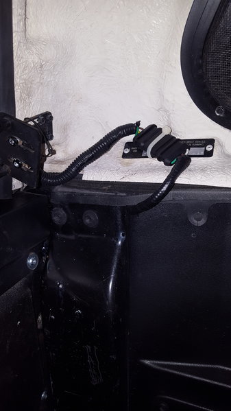

    Here's my setup with the weatherpac 3 pin.
    I still need to shorten the wires from the plug up to the topper and clean up the electrical tape.

    Looks like you got a good start. Even though it's not done out looks cleaner than most dealership installs.
