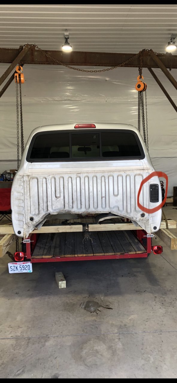

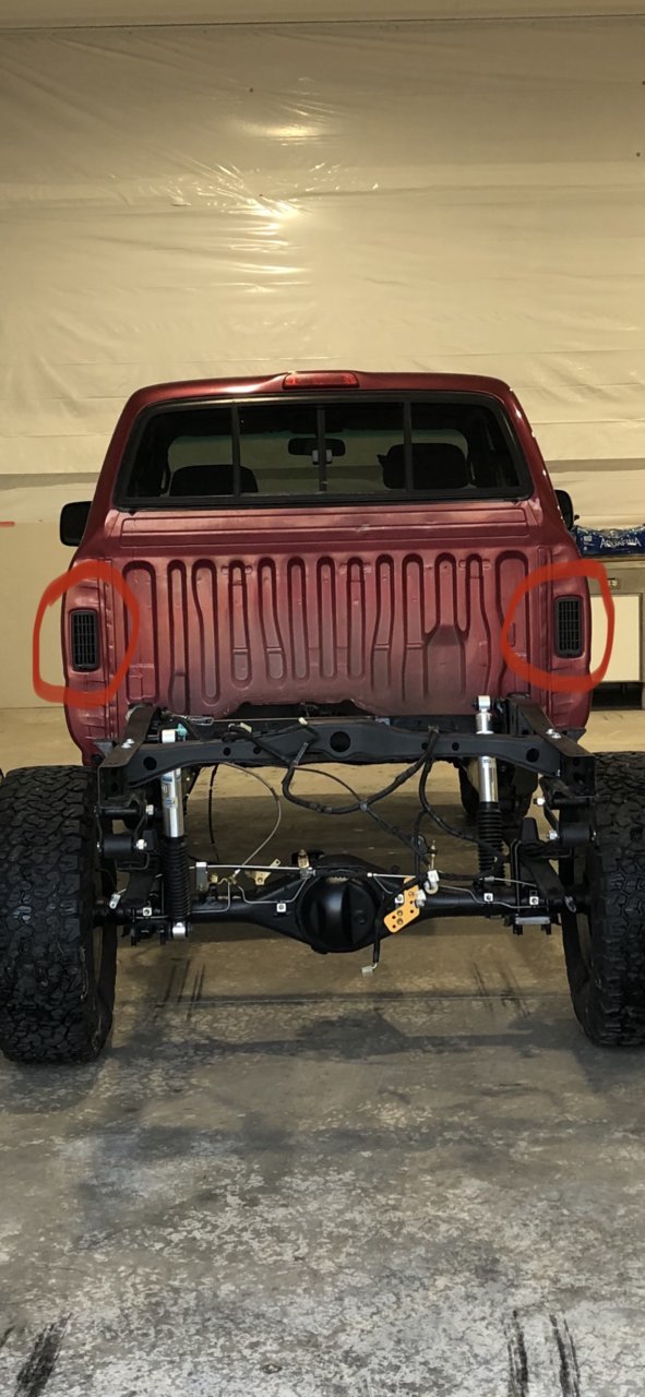

    The vents should be on the back wall behind the seats, they vent into the space between cab and bed. You usually have to pull a panel to see them.

    hi, thanks. what year is this truck in the photos?? when you say: "pull a panel" do you mean inside the truck cab or the black outside cover [vent] ?? does this black thing have some downward facing vents or what? mine is a gen 1 2003. thanks for info & photos. jerbo
