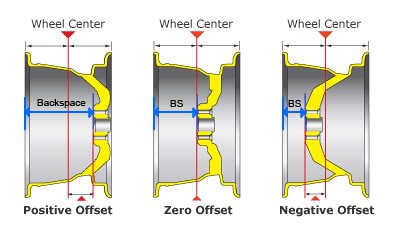

    Also I'm confused where it says backspacing 4 inch. Offset -13mm
    Are these the same thing?

    They are related but not the same. Offset is the distance in mm from the centerline of the wheel. Backspacing is the distance in inches from the back of the hub to the wheel edge.

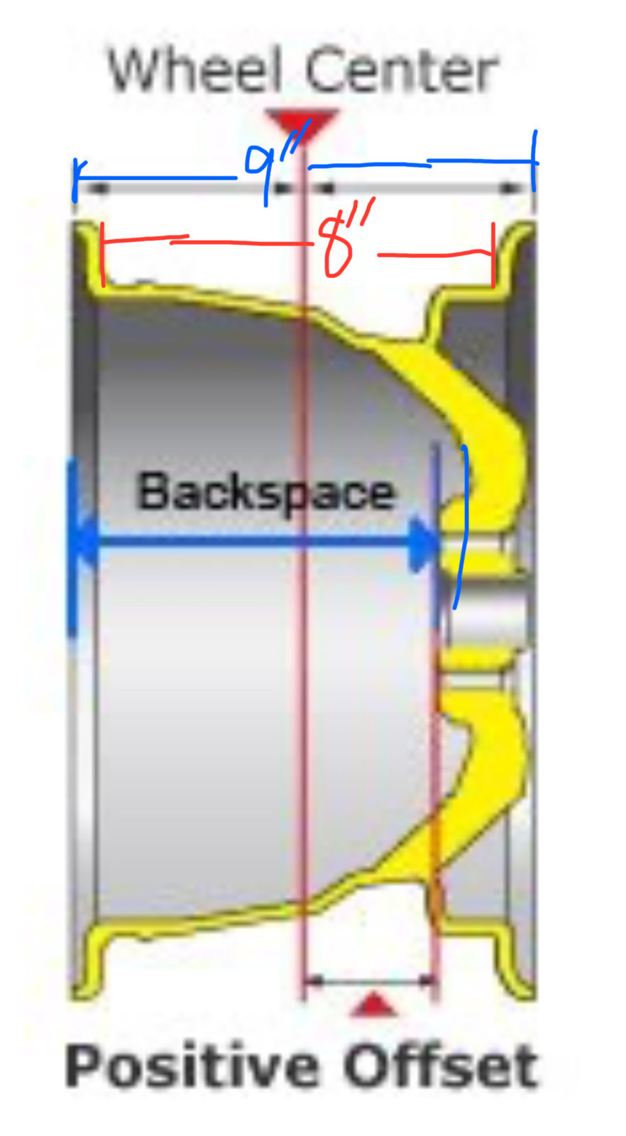

    Ok I understand, I think the item description is conflicting with itself. How can an 8 inch wide rim have a back spacing of 4 inch and any offset at all? I believe what it should be is a 3.5 backspacing approx.

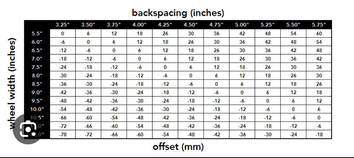

    There must be more to it than that. I just used a backspace to offset calculator last night, 4" bs on an 8" wide wheel came out to -12.7mm offset.

    It’s 8” wide from bead to bead, actual width lip to lip is closer to 9”

    Thank you that makes all much more sense. I see where the extra 13mm is coming into play.
