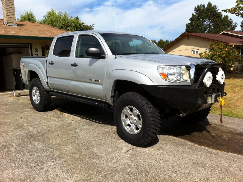

    255s were easier to fit than the 285s, but I have a Relentless front bumper (as seen above)
    Stock TRD OR rims, mudflap removal, cab mount chop, flare trimming, spidertrax spacers optional.
    My old 285s were on 4" BS rims and worked pretty well. My current 285s are on stock rims with the spacers and I'm pretty sure they are going to do some rubbing at the upcoming TSF offroad meet.
