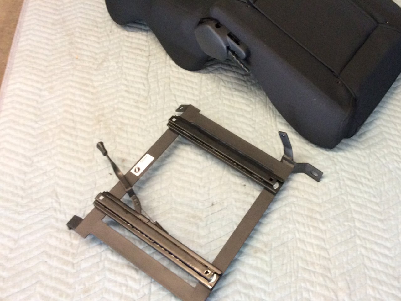

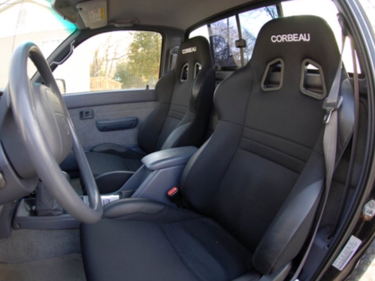

    Corbeau makes the rails, and sliders
    Perfect bolt in, no mod.

    Right on, Thank you 1997tacomav6, found these that are sold for my set up- https://corbeau.com/toyota-tacoma-oem-bucket-60-40-95-04-seat-brackets/
    @1997tacomav6- the seats pictured in your post above are they these?- https://corbeau.com/baja-xrs/ the black vinyl/cloth. Those in your pictures look super rad. Any spacing or anything like that needed for height? I am roughly 6 feet tall about 165lb, going to be auto crossing and cruising mostly. would you recommend the baja-xrs for that application. I believe I will have a bit more room in between both seats as my 95 has the 60/40 seat style so no arm rest.

    Mine are the LT1 seats, non suspension seat so you sit lower , lots of headroom

    They make a newer little different version now then the ones I have

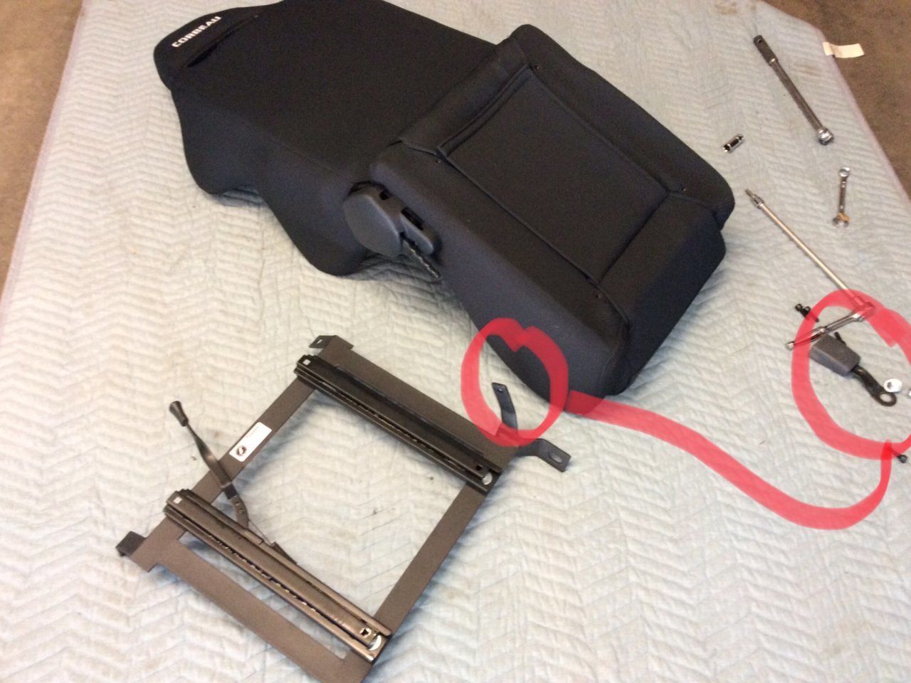

    Could it be these? https://corbeau.com/lg1/
    stoked to get this 60/40 out. My lady hooked it up for my birthday with some Enkei Rpf1s (she’s a keeper!) and she was asking what I’d like for Xmas. Some new seats would be killer I’m thinking. It’ll benefit her as well when we go out in the taco
    Hopefully loaded the picture right, in my 30’s but haven’t been on a forum since my teens. Learning all this over again. Appreciate all the input no doubt. Helping this build come along.
