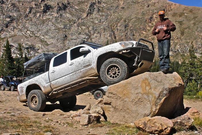

    I made my own. They've worked great so far. The only picture I really have right now where you can see them good is this picture.

    So for those who have built your own, bump out or no and why or why not?

    I chose not to make mine with a kickout because I didn't like the look as much and I felt like it would almost give it more of something to get hung up on.
