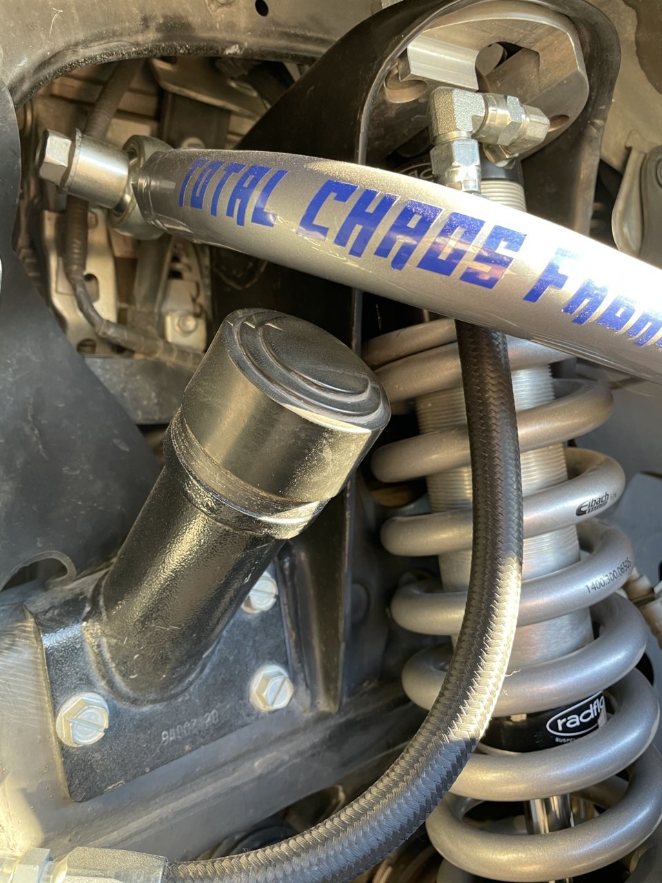

    Anyone with a mid travel...aka under 13 inches... build a mount to have a hydraulic bump strike the upper control arm at the upper uniball?
    that way it doesn’t effect shock valving?

    This type of mount comes with the RC 6” kit on my FJ. Although not hydraulic, it does keep my uniball/shocks from maxing out. I have another set I will attempt to mount on my Tacoma, but it may need to be shortened a bit..

    Interesting. But that’s a droop stop

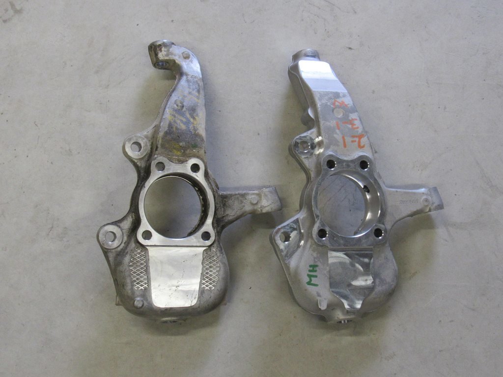

    You will break/bend spindles long before you need to revalve your shocks. The only way this will work long term is if the spindle/upright is made to bump off the UCA.

    I can’t speak for the arms. They are baja kits typicals. But the knuckle is the forged aluminum one on the right.
    (I believe I read they are forged and not cast. Impossible to tell by look now a days)

    Ford Parts? Looks like a Raptor upright.

    It's easy enough to build an engine cage and put the bump stop in the right place to hit the uniball bolt, look on IG for race truck builds for ideas.
    The problem is the stock taco spindle probably isn't up to the task, and will bend.
