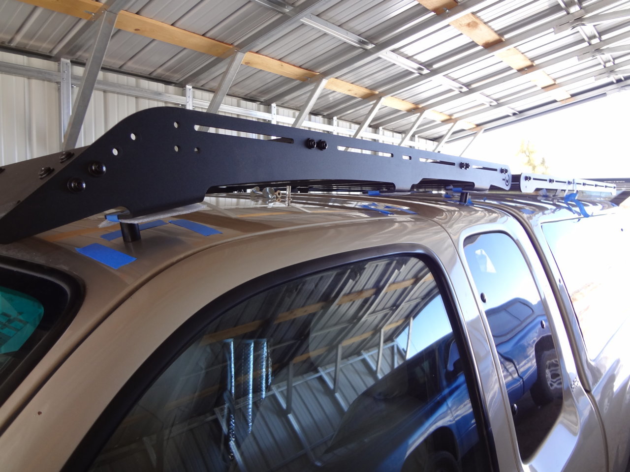

    I'm in the process of finally mounting my Prinsu cab and topper racks, a seemingly endless process it feels like right now. I'm making some custom rubber spacers since the ones they sent me don't work w/my 1st gen truck. I'm planning on mounting 2 100 watt PV panels that I have once I get the rack up. In the back I'm going to mount a 270 degree awning.
    The pic. shows the 1" tall 3/4" diam. spacers that came. I'm using 1 1/2" diam. 1" tall (plus some others) rubber spacers instead.

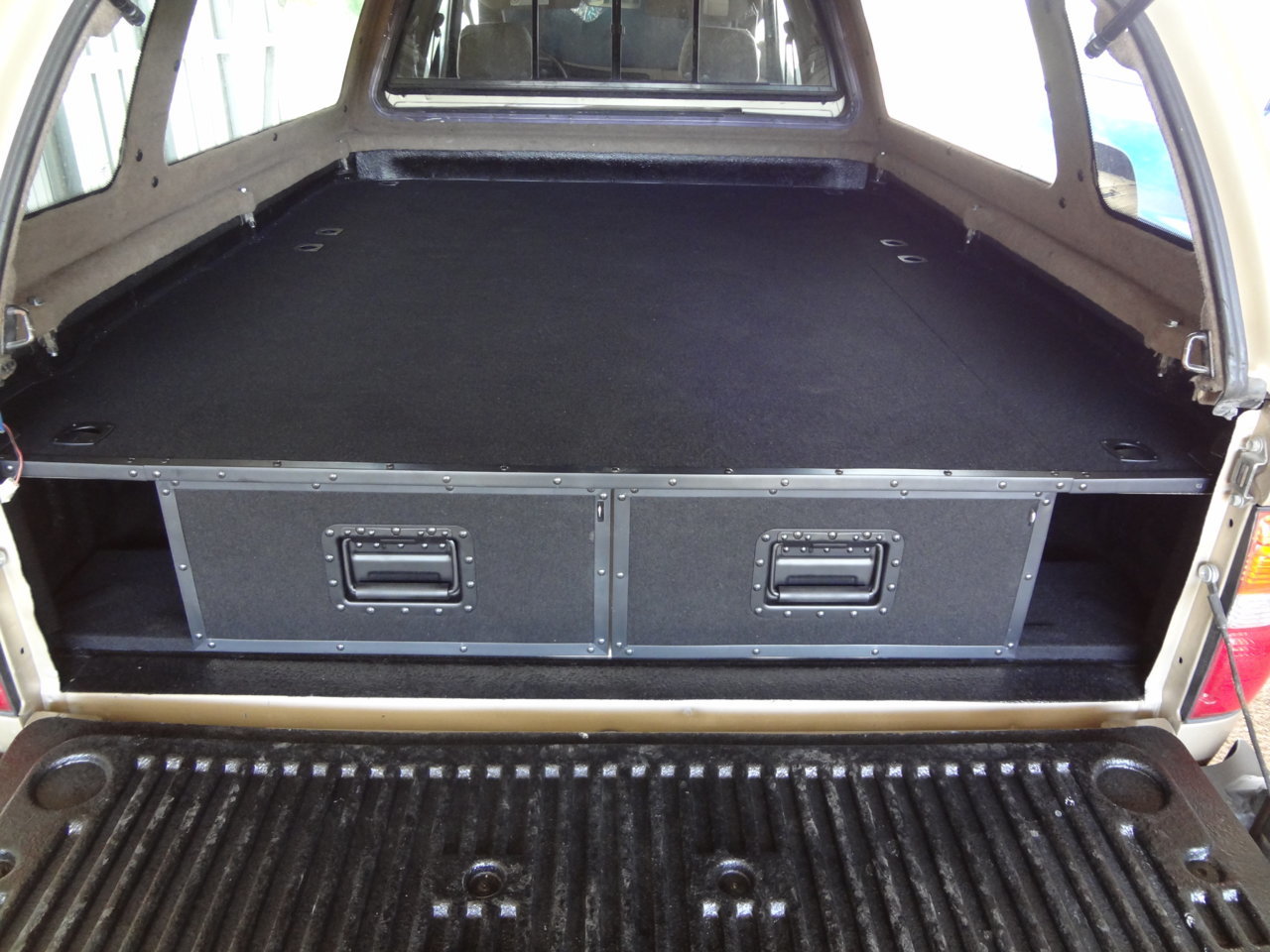

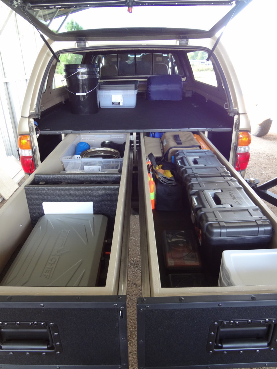

    Yeah, strange things are abound. I have a 'snugtop', I use for camping/storing etc. I built a drawer system back there so I can have 2 6 ft. drawers plus a sleeping plat-form.
    I looked into tracks for the topper, but even more holes would need to be drilled. The intention is water-tight, using some RTV sealer for that.
