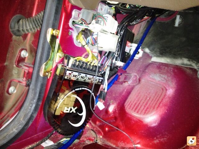

    Don't really know how the 2nd Gen are but in my 02 I run my front crossovers in the kick panel like seen here:

    That is NOT possible on a second gen. That was the route I was going til I pulled the kick panel off.
