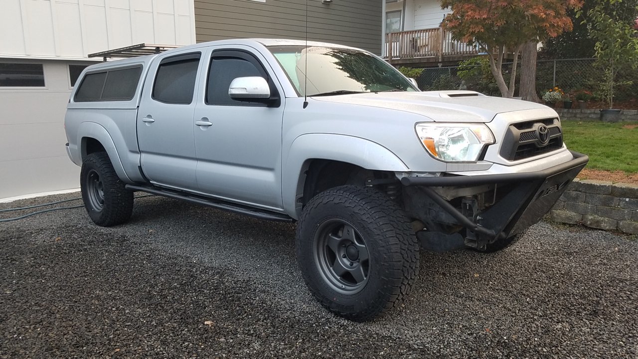

    I bought the 59" bars, but I ended up cutting them down to 50" when converted the rack into a platform.
    Sorry, those are the only pics I have handy, no close ups at the moment.

    No worries! Thanks! Was it as big deal to cut the bars? Did the end caps work ok afterwards?

    The bars were really easy to cut, I just used a hacksaw. The end caps just popped right back on.

    I’m super intrigued by you converting your rack to a platform. How did you do it?

    I've never gotten around to taking any good pictures of it, but the gist is I used some angle steel to connect the two bars to one another (the ends are threaded, though I had to rethread one side when I cut them down). Then, for cross bars I used some unistrut.
    https://www.homedepot.com/p/Everbil...in-Zinc-Plated-Slotted-Angle-800087/204325585
    It's quite sturdy and I've had a decent amount of weight on it without any issues. However, if I were to put a roof tent up there I'd probably want to add one more of bases in the middle, as the span between them is almost 4 feet.
    Here's another view of it, though it still isn't that usefull.
