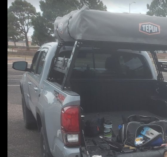

    I can dig for pictures, but I attached the water port mount to the back of the driver side on the outside of the voodoo rack. I only use the top 2 bolts for the mount onto the rack though. I put the water port in the bed while I'm driving and only put it on the mount when I get to camp and want to use it. I do have a little travel lock to keep it on there if I wanted to drive, but I'm not a fan of seeing it in my side mirror while I'm driving.
    I'm planning on getting a shell this year and will be figuring out how to mount the water port to the passenger side bed rails with some supports under it so it sits on the wheel well.

    Heres a pic of the rack and mount without the tank on it.
    looks like i dont really have a better picture or one with the tank on
