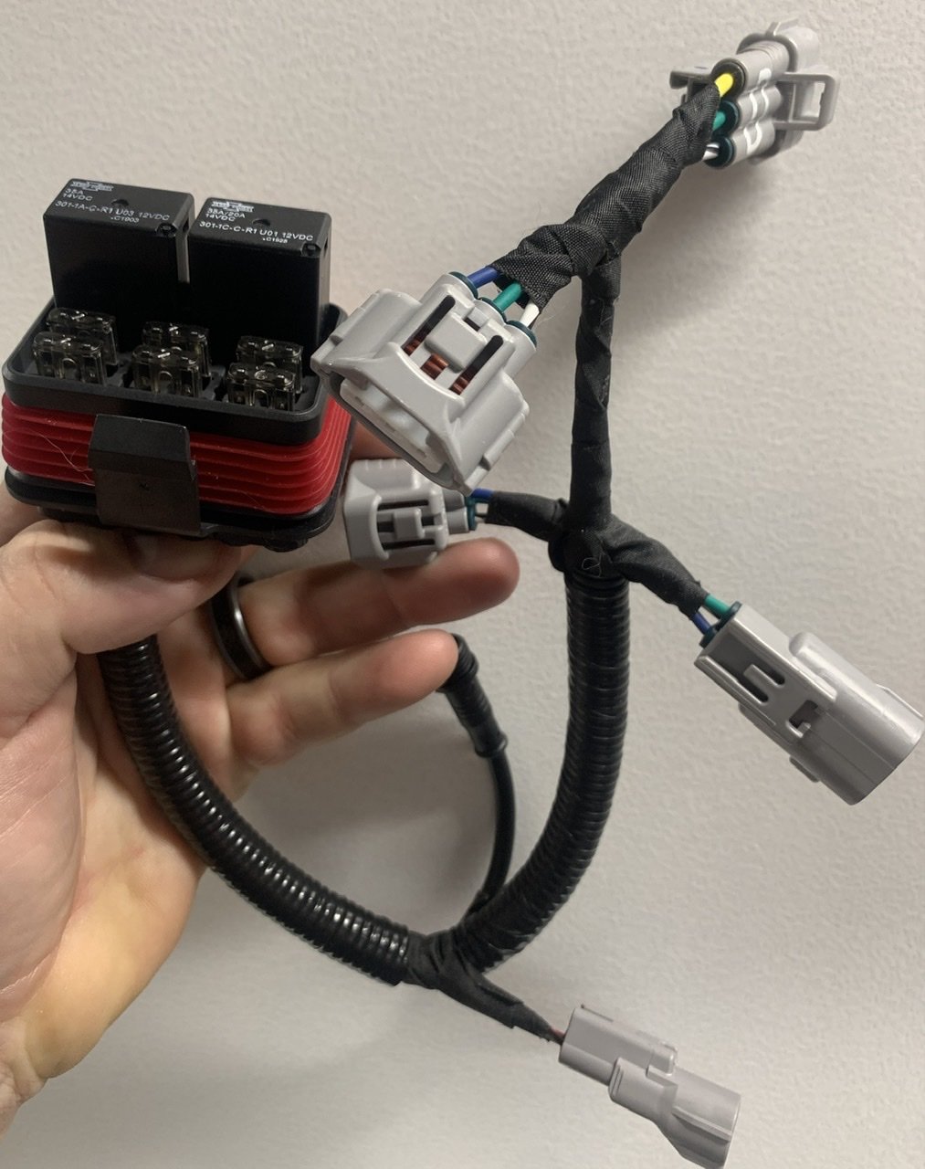

    Any chance you’re willing to share connector and pin part numbers for those of us diyers?

    Great minds think alike. What started as simple side lights for my rack morphed into brake/reverse/turn/side spot lights. It’s so tempting to throw “scene light” function in there too, but at some point I just have to stop myself.
    But what you are looking to do is absolutely doable. Also a good example of where a more customized approach is the best I think. When I get running on all this, I’ll let you know if you’re interested. Yours would have to be 2 taps, because of the turn signals, but it’s doable. Also, real easy to just make all this stuff feed relays. Or so I’ve heard....

    Absolutely! I am all for the free flow of info. After all, without the help I've received from others, (cough... @caribe makaira @MESO ...cough...) I'd be lost on this stuff!
    The housings are Sumitomo TS 090 seires. The male is the tricky one to find:
    3P090 Type TS /waterproofing/ Male terminal side coupler kit triangle - [color Gray] M090WP-TS/3P090WPK-TS-99179-M - hi-1000ec.com (hi-1000ec.com)
    The females are a little easier:
    3P090 Type TS /waterproofing/ Female terminal side coupler kit triangle - [color Gray] F090WP-TS/3P090WPK-TS-99179-F - hi-1000ec.com (hi-1000ec.com)
    or
    3-Way Kit (corsa-technic.com)
    I would recommend using a 14 gauge terminal (I used the male pin, but which side doesn't really matter) for where you are cramming the 2 wires into it. I used 18 gauge TXL. GXL is a thicker insulation, but its makes it pretty hard to fit both wires in one terminal. Sourcing this stuff is where it starts to suck though. hi1000-ec has a great selection, but the shipping will get you. And they don't offer much selection for terminal size. Corsa Technic is also great, but they only stock the female (for now, I did write them before the holidays to see if they could carry this one and a few others, so we'll see). But, with Corsa Technic, you can get the larger seals and terminals.

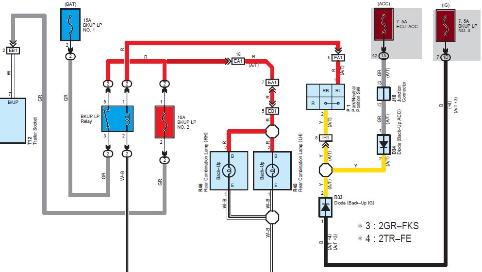

    @Puppypunter ; if vehicle has towing package, the main 15A fuse gets split downstream of relay to 10A for Tow and "5A" for vehicle.

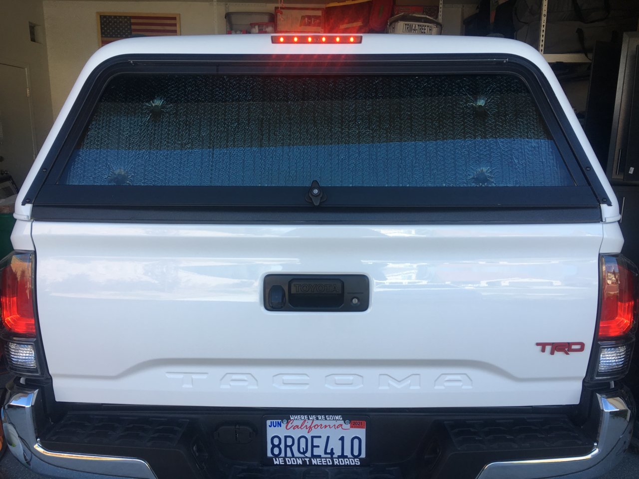

    6753351C-4FD6-4A20-AFC4-9A446AF3717B.jpg Worked great , easy install and no issues. Thank you again !!!!
