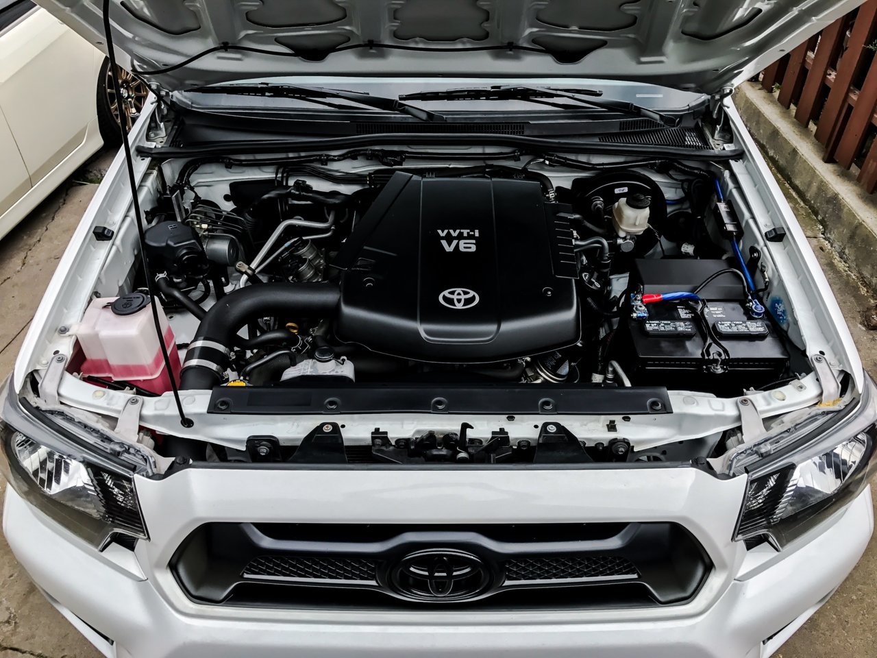

  15. Mar 8, 2022 at 3:26 PM
    #35
    Hal Geiger
    Hal Geiger Well-Known Member
    May 27, 2015
    #156127
    101
    2015 TRD Sport - V6
    Now that's a clean engine bay - I hose mine off every spring, 6 years, no problems. I do run the motor after for 15 minutes.

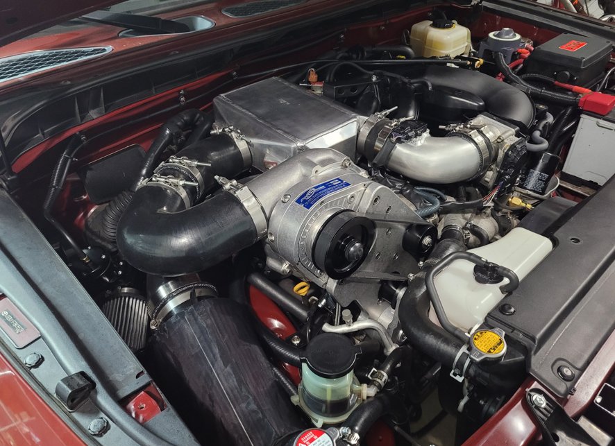

  16. Mar 8, 2022 at 5:57 PM
    #36
    Musubi3
    Musubi3 Well-Known Member
    May 16, 2016
    #187108
    1,695
    Big Island
    2014 Tacoma DC 4x4 TRD Off Road, Supercharged
    You can probably just get away with wiping things down and using a vacuum while loosening the dirt and debris with a brush. No washing used. I believe that can make a big difference in itself.
    But I've washed down my engine bay before, covering my alternator and battery, blow drying it, then protecting it some with 303. Comes out great. No issues.
    EatSleepTacos likes this.
  17. Mar 8, 2022 at 7:21 PM
    #37
    LuckyRT13
    LuckyRT13 Well-Known Member
    Jan 30, 2022
    #388794
    55
    2012 Tacoma Super White DCLB TRD Sport 4X4
    265/70R17 Falken Wildpeak AT3W 17x9 Fuel SHOX Bilstein 5100 front shocks
    Looks brand new? How’d ya do it?
