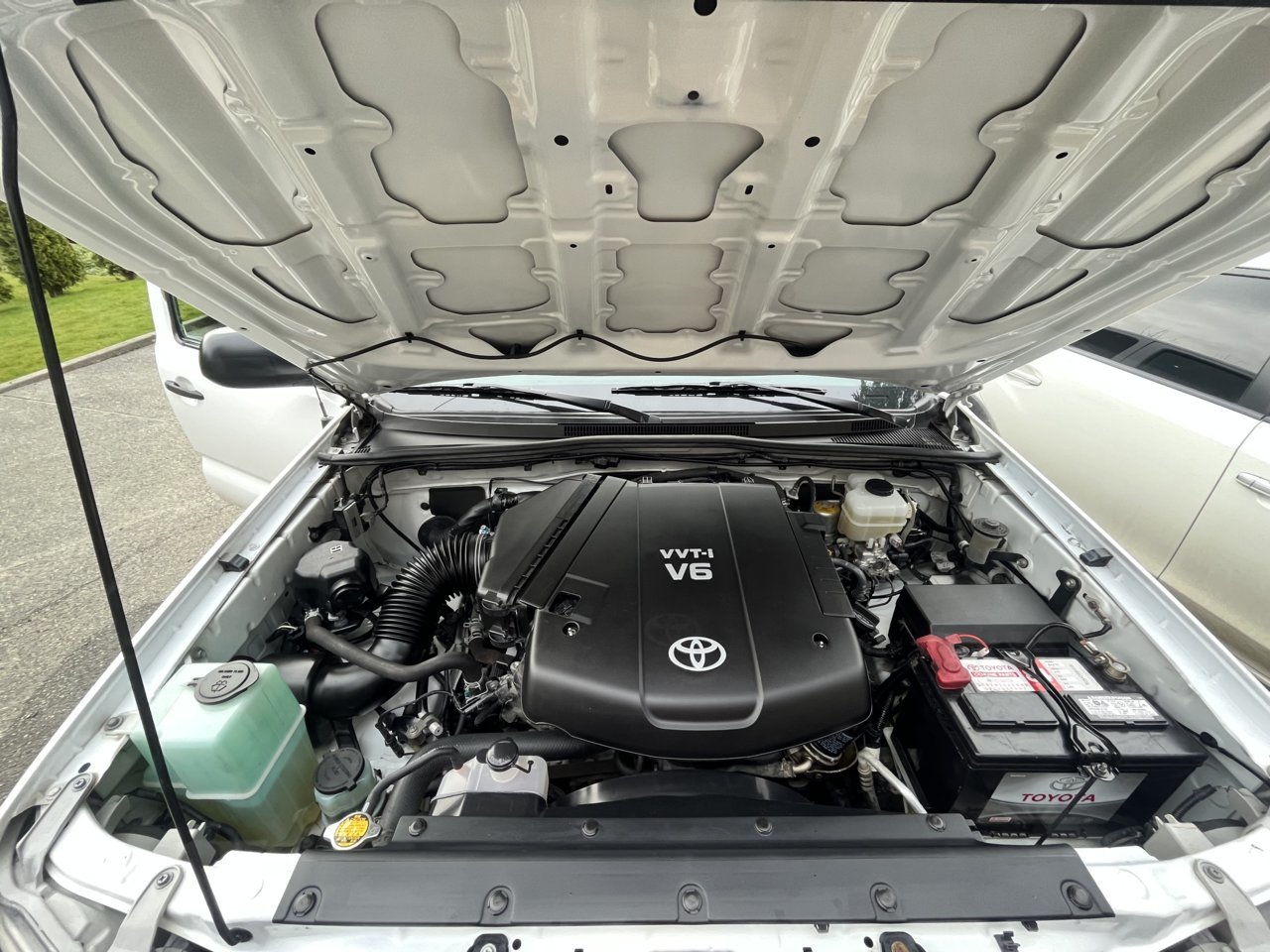

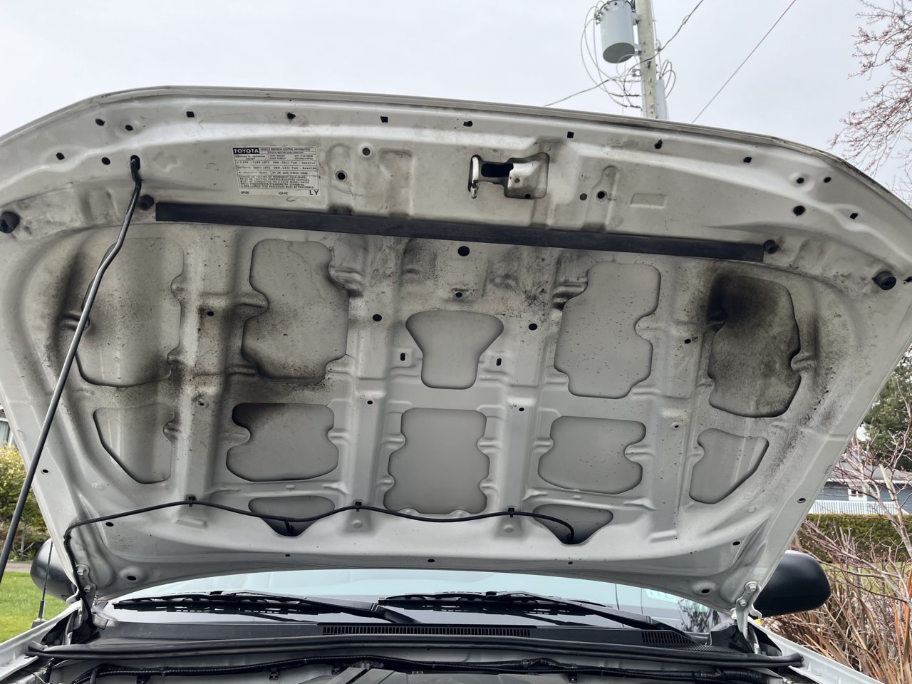

    Just cleaned mine for the first time today. Don't really have a great before shot aside from the hood shot, (I had already taken the plastic cover off and cleaned it in the before shot). First time in 10 years!
    Used Super Clean degreaser, bagged the alternator, electrical connections and computer, let it soak in for a few minutes, agitated with a paint brush and gave it the ole' rinse. Used an air compressor to blow out any excess water, then 303 Aerospace on the plastics.
    After:

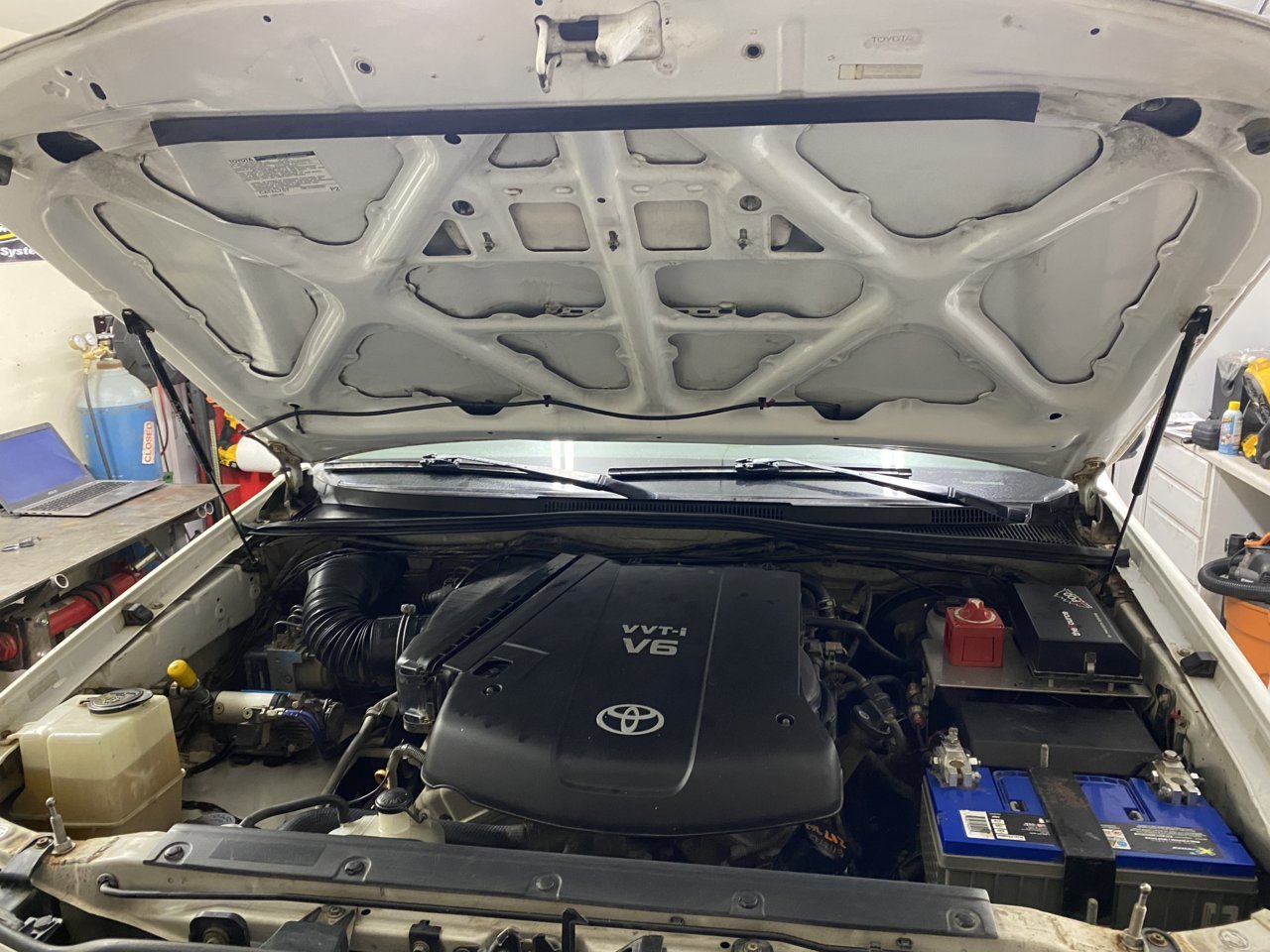

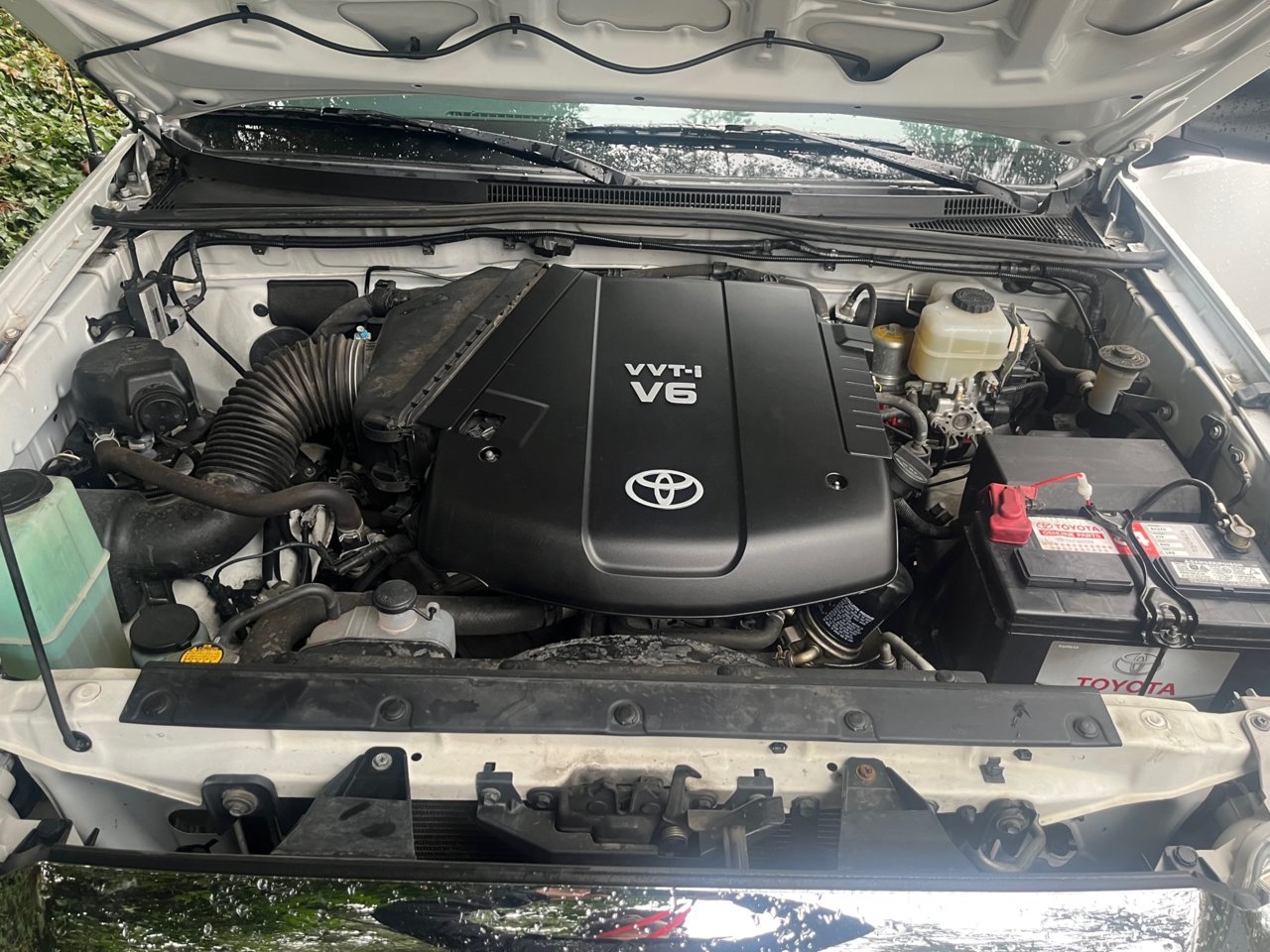

    I rescued this 06 from New York last May. These are some before pictures and an after from detailing the engine bay. Ive also been replacing rusty hardware with zinc anodized as Ive removed shit
    Before
    After

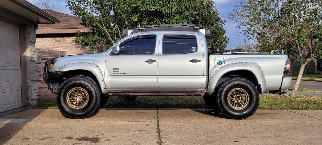

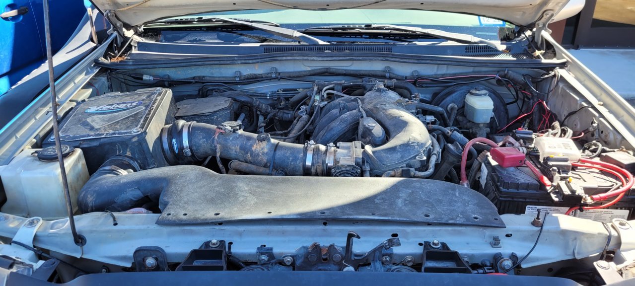

    I think the only real important component to clean is the condenser and radiator... Personal experience from driving with them caked and filled with mud lol.
    I will clean areas before working on them but usually don't go out of my way to clean the bay..
    Here's a current engine bay picture and freshly washed exterior picture :rofl:
