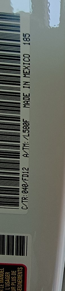

    Update for today. Went to dealer to show my service advisor the extent of paint issues I was having so he could see them with his own eyes. We both looked over the vehicle and found multiple places on the paint where it looked like material was stuck to the paint and we noticed that they had painted over spots that had debris from prep. We also looked in all four door jams of the vehicle and notices many of the inside jams paint were showing a slight yellowing but not as bad as the spots on the passenger side. The big kicker is my service advisor noticed that the paint code on the vin is 040. I would hate to think Toyota is still using the same paint they had issues with years prior on new gen Tacoma's. So, it is confirmed Toyota still is using the 040-paint code on new 2025 4th Gen. We also noticed a few spots on the right rear quarter panel and just before the rear wheel well rock chips are hitting straight to the primer. It seems as though the paint is too soft. I notified Toyota Corporate of our findings for my case number and will just have to wait for next Wednesday for the technician to look it over and report his findings to Toyota.

    170
    As mentioned previously it is not the same paint ,the code is the same but the 24 and up is a two stage paint. The white on the 23 and lower years are a single stage paint.
