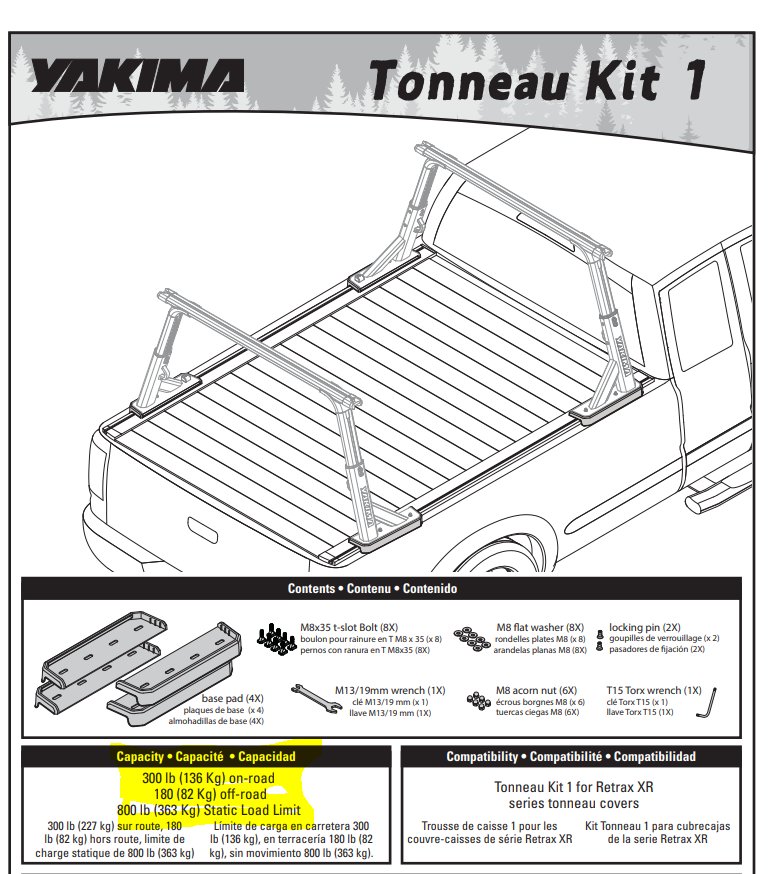

    Retrax Pro XR with Tepui Tent
    I have a retrax pro xr on a 2019 TRD Pro with a yakima outpost and tepui tent that I took off for the winter. The setup is nice but I learned you have to be careful when torquing the outpost on the tonneau kit because the aluminum tracks can bend if you tighten the cap nuts too much. Also the weight of the tent plus outpost is at the off road limit of the yakima tonneau kit and rails on the retrax. So things like awnings ect will put you over the stated limit. I suspect the aluminum tracks are what limits the weight on the system.

    You’re not alone on that. Ran into the same issue weeks ago after running the setup for a month.. I contacted Retrax soon after and claimed it wasn’t under warranty but went ahead and shipped me another set of the railings. Awesome folks over at Retrax.
