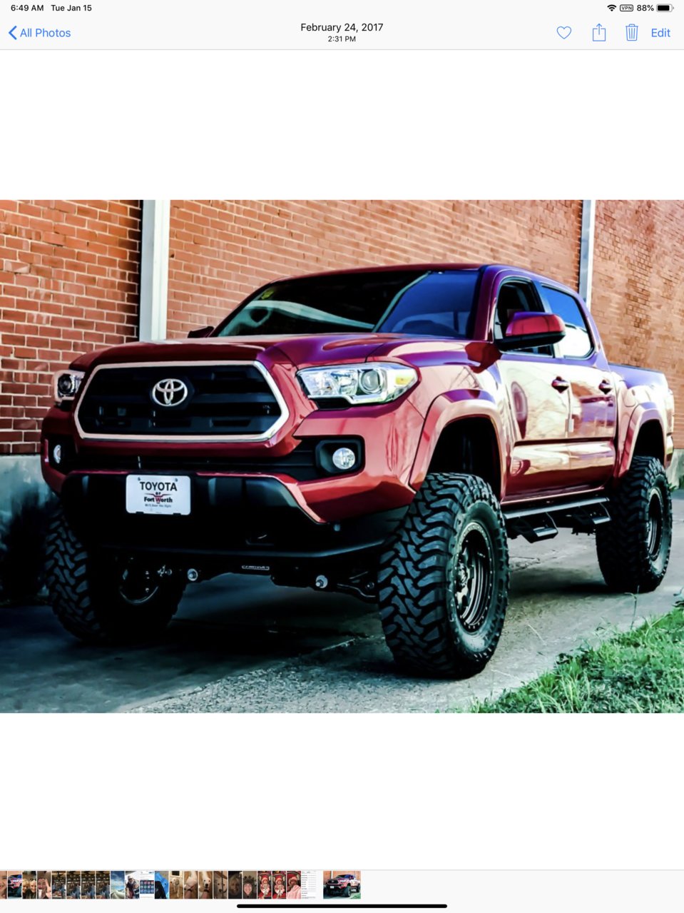

    I saw this Tacoma pic the other day. I am curious if anyone could guess what size lift and tires are on this beauty? I would love to do the same to my Tacoma.

    Not Stock
    Diff drop with a dash of ugly thrown in

    Logo appears to say Fabtech, so Fabtech 6" drop bracket lift, requires cutting a crossmember from your frame and welding in the Fabtech crossmember.
    Tires look like 35s, so budget another $2k for regearing unless you DIY.

    That's gotta be a 6 inch lift.

    Yes, lets make the image dark AF so no one can tell what lift it is.

    Yeah at least 6-inches.. with big ol Toyo MT tires.
