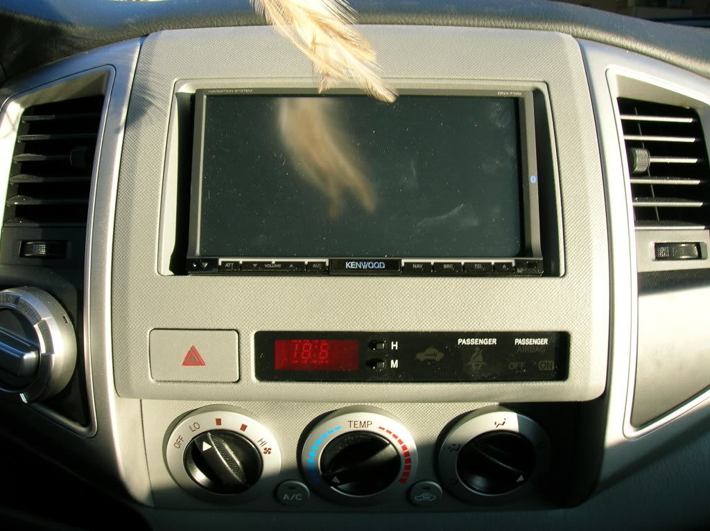

    yup . . . painted everything gray to match.DSCN0990_9c578d7ad8c652895f058ba9cf1e40e3e3757b49.jpg

    What brand of paint and what color did u use to paint the piece?? Where'd you buy it?

    man that looks clean. I've seen a few painted from solid colors to AK47 pictures but this looks by far the best. What kind of paint did you use?

    ^^^ It's been a while, but I think I took a factory part to Home Depot, where they used a color scanner to make a custom color paint -- I think it was just a latex based paint. Then, I watered down the latex paint, and used an aerosol kit available at Home Depot to spray paint the pieces. The aerosol kit was in the spray paint section of Home Depot. It just has a glass bottle and a propellant with a spray nozzle.
    I want to say that the only two parts in the vehicle exactly that color are the audio/AC control trim panel and the trim panel around the gear selector. So, once you have those two parts isolated from the vehicle, you could paint them any color you wanted, and the two would match eachother. Just remember to pull out the AC piece from the back, and the clock piece. That's easier than trying to mask them off with masking tape.
