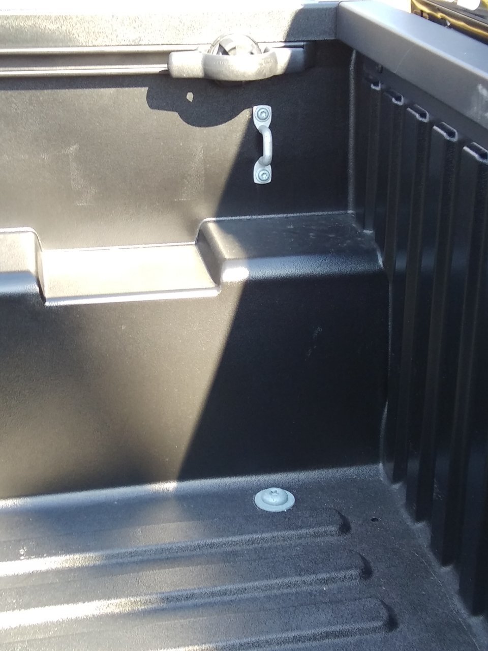

    I want to paint the bed bolts and those hooks with bedliner. Bed bolts should be simple. Alcohol. Tape. Paint. Are those hooks thru bolted? Tapped into a plate? Will they thread right backin if i take them off? Also. Has anyone done it? Does that surface coating hold paint well?

    They are screwed into nutserts as far as I know.
    I think these are galvanized parts. I painted some on a 1st gen once but don’t think those were galvanized. Worst case, paint chips off over time.

    It will probably chip very fast and look raggedy. 2¢

    Power to ya! I think as others posted, the nuts for the "loop" are retained. So just unbolt and paint. The bed bolt is definitely retained, as I took mine out for stiffeners.
    As the other poster stated, they'll probably chip off in quick order.

    The bolts screw out. No backing wrench is needed.
    I'd just take a Magic Marker to them. It will adhear to galvanized coating quite easy. Easy follow up as well.

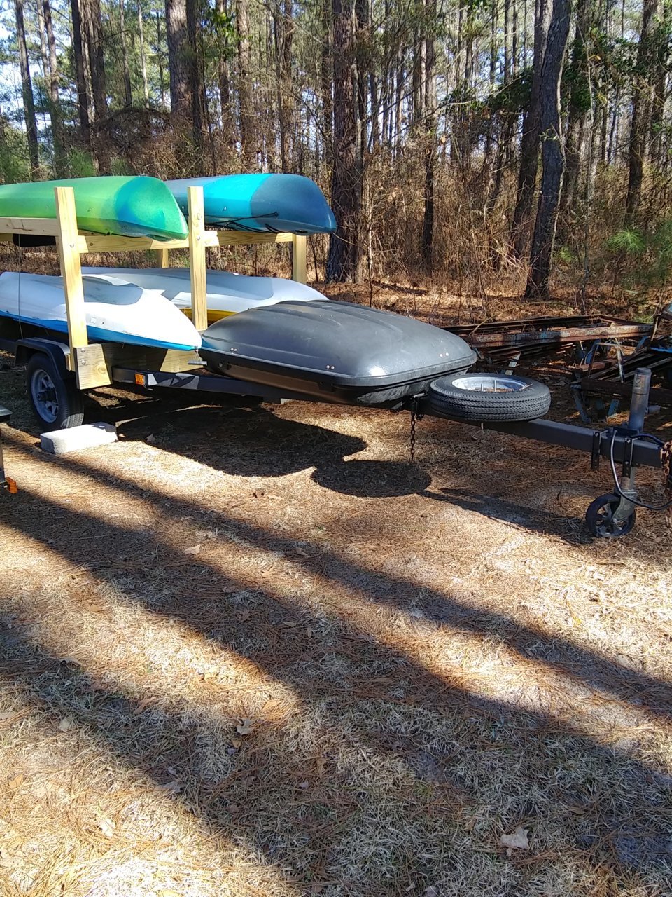

    Galvanized can hold bedliner. I put one coat of galvanized primer and three coats of rattle can bed liner on this old galvanized boat trailer two years ago when i turned out into a kayak trailer and it has held up well. But i don't run straps around it either.20190202_130443.jpg
