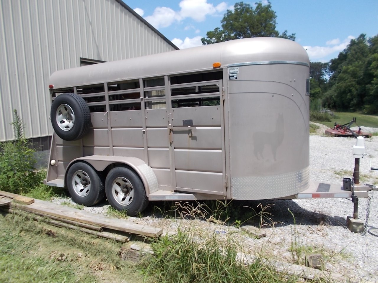

    I have this 14ft trailer that I bought when I had an F150. Pulled with my 2 horses several times with no issues. Obviously the Tacoma don't have the 'ass' the full size trucks have. Thinking of downsizing to a 10 or 12' stock trailer to save the weight. Would still be plenty room for my 2 horses. Wondering if anyone uses their 3rd gen to pull their horse or cattle trailers...upload_2019-8-9_17-59-59.jpg

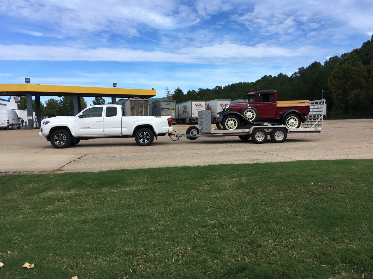

    Pulled this from Memphis to Elkins, WV. in May. Pretty good grades on I79 between Charleston WV and Weston. Pulled it at 70 mph with no issues and passing the 18 wheelers on the way up. The Model A Ford weighs about 2300 lbs. and trailer 1000 lbs. S4 and ECT was downshifting into S3 and jumping up to 4600 rpm topping the hills. I just got used to it. Tranny stayed at the same temperature as the radiator, 195 degrees. Gas mileage sucked at about 10 to 11. Coming home was down hill. Averaging 14 plus. 9BEB1511-2534-4190-9DA2-9A50E0FCC504.jpg

    How big is your trailer? And what did ya haul specifically. I'm guessing my trailer weighs 2000-2500 pounds. My gelding about 1100 and my mare about 1000. So pushing 5000 pounds total with a few bales of hay. It did fine on a 15 mile test loop today pulling it empty. I purposely got next to some semis on the interstate and there was zero sway at about 75mph.
