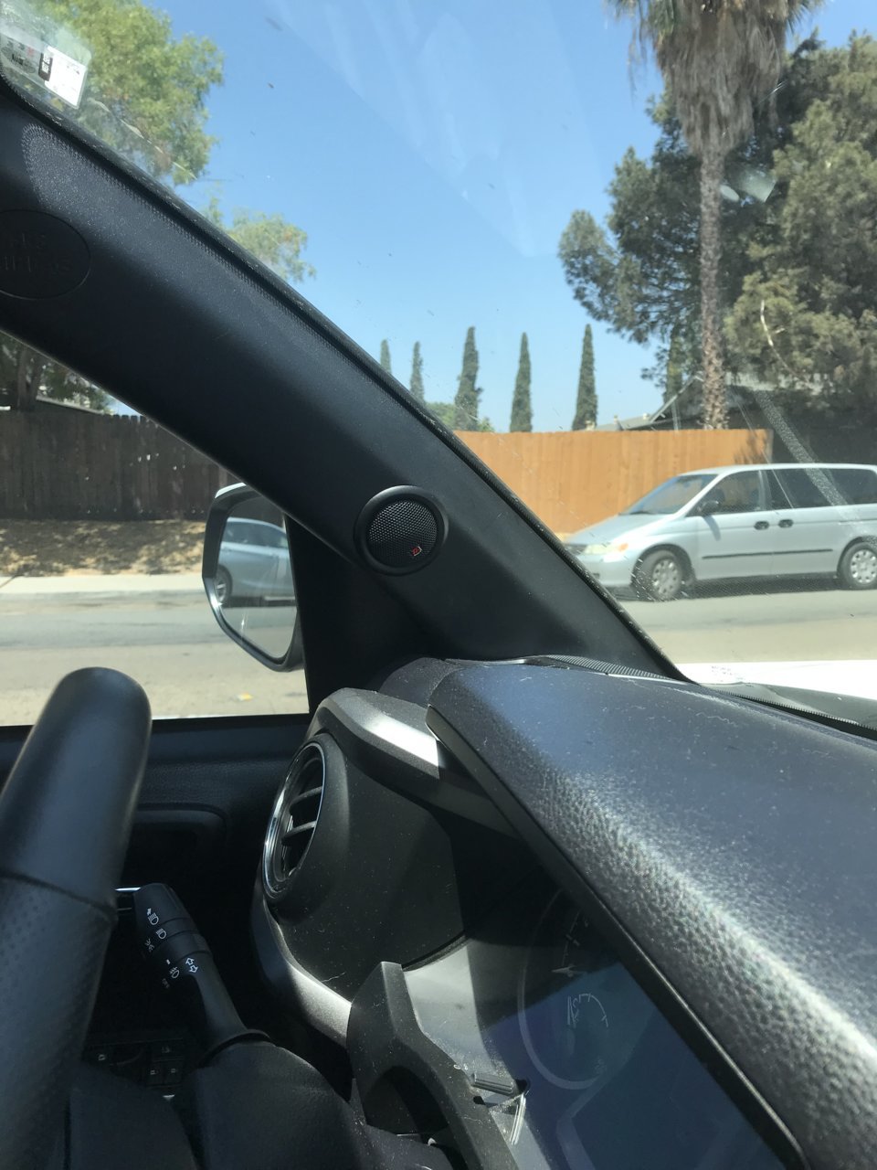

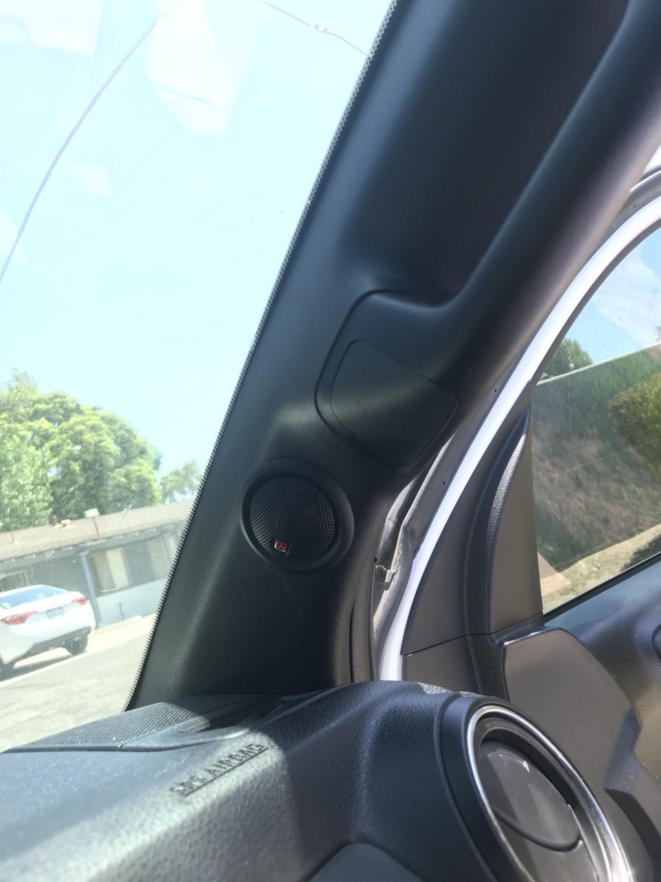

    I flush mounted my morels in the a pillar. There is a small gap on the sides of of the tweeter because the a pillar has a slight curve to it. I think it still looks decent and it’s much better sound than the factory location.

    Got a picture?

    You have my attention. How is the staging with them aimed like that?

    It is much better than the factory location. the best would be on axis but that would be doing some custom work on the A pillars. Try some double sided tape and see how they sound before you cut your holes in the a pillars.

    I also have the tweeter attenuation set to +3

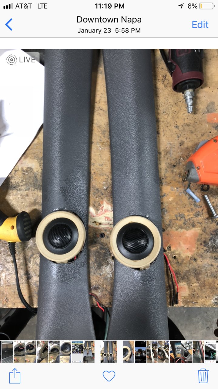

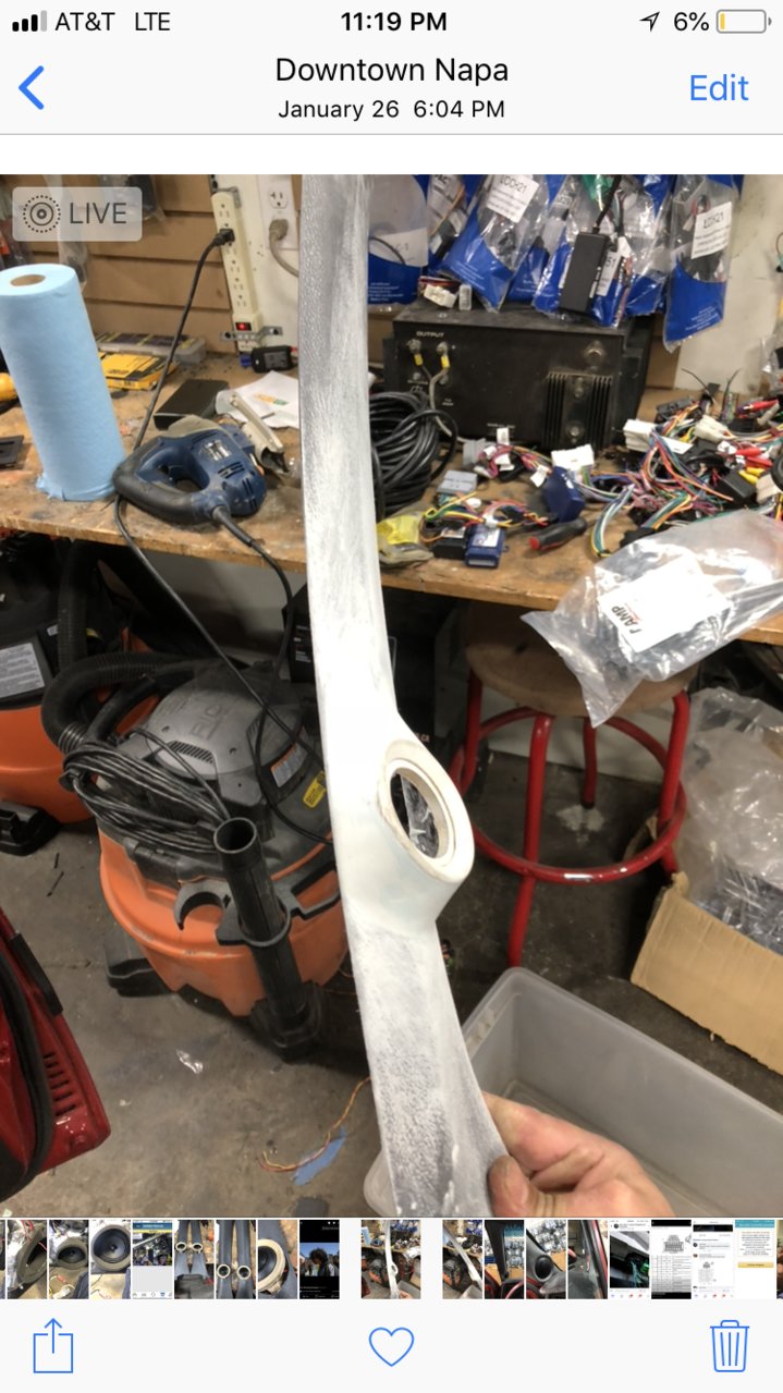

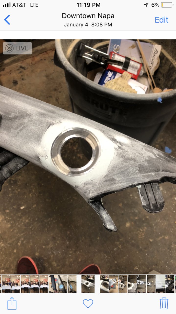

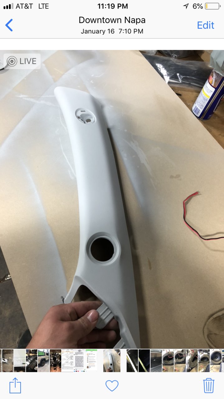

    I have put in Racesport gen3 leds I'm the process of doing a custom audio overhaul which will include Hybrid audio unity 6x9 mid bass, unity 3 inch mid driver in the dash and fiberglassing tweets in pilar soundeading all the doors, floors, and headliner and I will be using a helix processor to retain the factory radio and as far as subs I might make custom brackets to move rear seat foward a few inches to get a full size sub in there or I might just go with a pair of jl tw5 or tw3 and it will all be powered by jl audio HD amps or I might try out the new hybrid amps
    To anyone on this forum I can build you custom sail panel, or custom pillars for your tacos! I can do somthing subtle or crazy! On axis or of axis I’m a car audio installer by trade and I have 12+ years of experience and im a custom fabricator! I’ve done custom door panels,trunks, pillars e.t.c.... I own a third gen so my dad has a second gen and coworker a first gen so i can get measurements for any of them. Here’s some pics of my taco pilllar I wanted somthing subtle and that did not jump out and catch unwanted attention! There is also some random custom work I’ve done some 1st gen Tacoma pillars and stuff.
