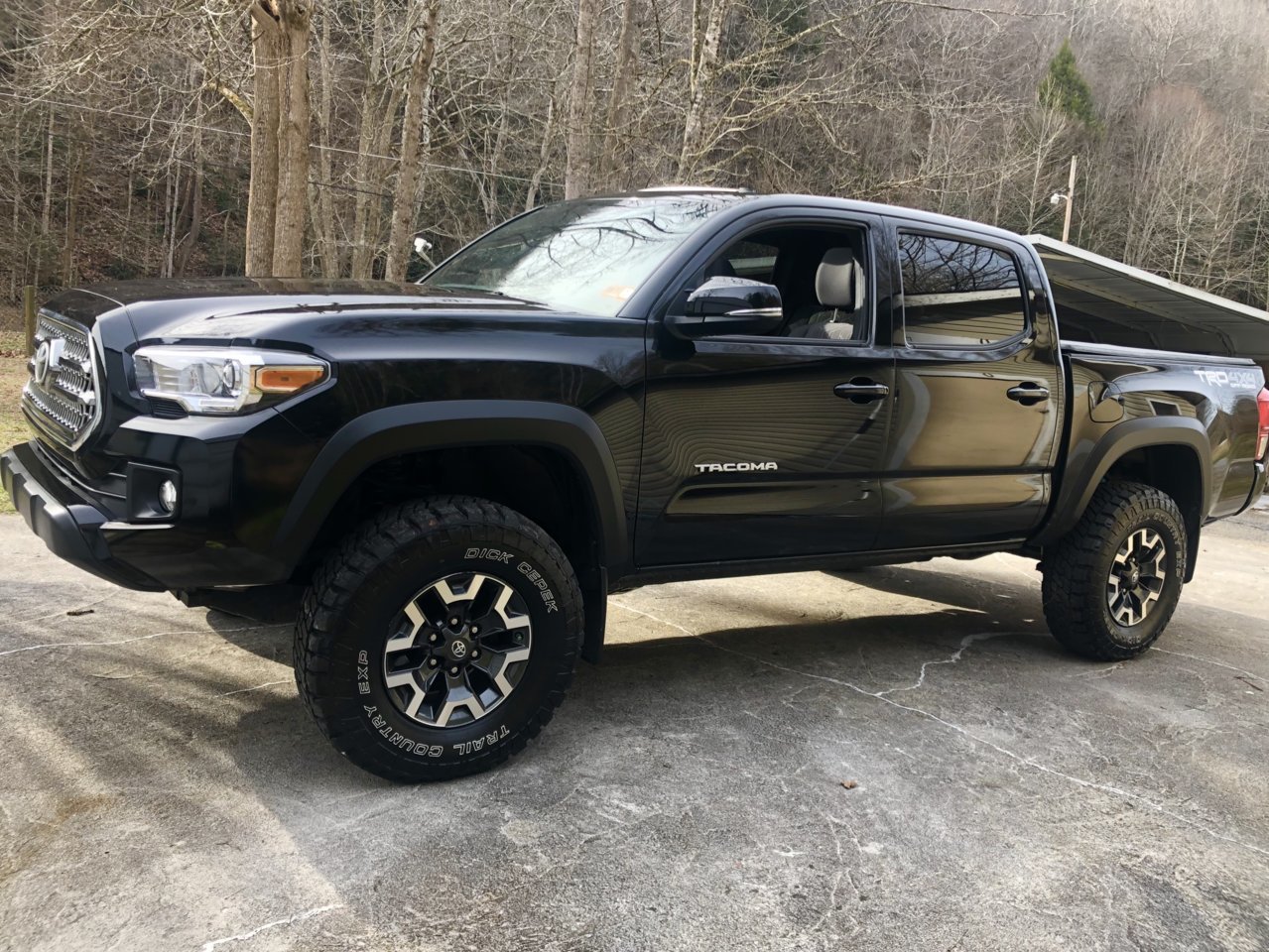

    Are on the way!
    6EDCEC77-0036-469A-B33B-4A5ED9CA7E8A.jpg Love the 1.25 spidertrax

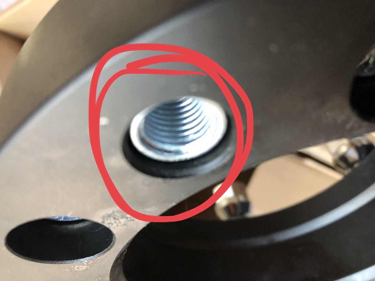

    Correct:
    Incorrect:

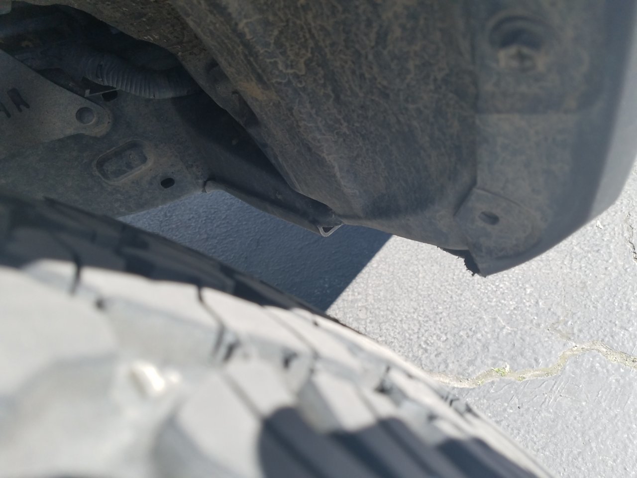

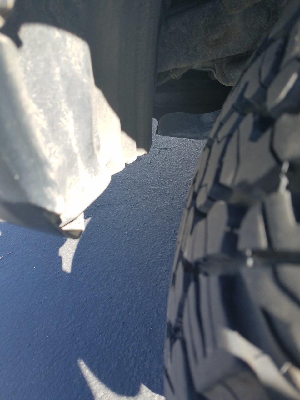

    2016 DCSB OR
    second hand lift, fuzzy dice
    was just the corner of the tire about 3/4 lock. didnt have to trim much20190319_120427.jpg 20190319_120437.jpg
