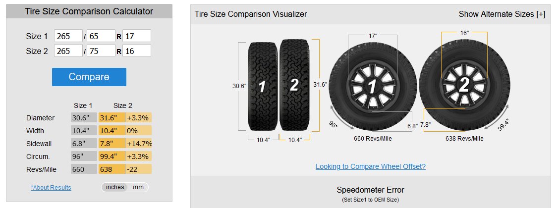

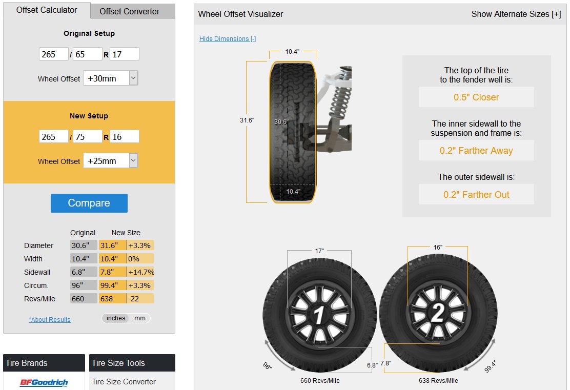

    heybronicetacoma
    heybronicetacoma Meat Popsicle
    Aug 21, 2018
    #263589
    469
    Claro
    Seattle
    ‘20 DCSB MT OR SSM
    Mods? Yes.
    I know its 3 months later, but in case you or someone else wants reference:
    TRD Off-Road Wheel - 3rd Gen
    The offset is very similar: 17x7.5 +30mm (Sport) vs 16x7 +25mm (OR) but keep in mind the difference.
    265/75/R16 BFG MT KM3 w/o 1.25" Spidertrax = NO Rubbing
    265/75/R16 BFG MT KM3 WITH 1.25" Spidertrax = Very rubbing on Husky (OEM-like) front mud flaps. Without the mud flaps, they do not rub, lock to lock both ways. Have not wheeled yet, but if needed I can report back again if yall want.
